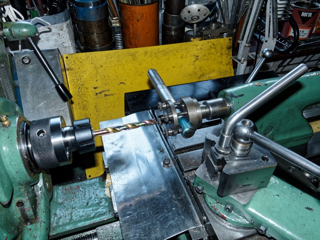

                                                In finest Blue Peter fashion; here's one I prepared earlier.
                                                I bought it from an exhibition or autojumble years ago; I looks all home made from solid bar stock on an integral MT2 taper.
                                                If I was going to make one myself, I'd use a separate arbor, to save time and metal, but make the head much larger to accommodate a bigger workpiece. ¾" is about the limit on this one.
                                                The photo was just a quick lash-up to illustrate the item for this thread, but the workpiece is actually genuine(ish).
                                                Lathe is a Warco 720 (Myford Super 7B copy from the '70s)
                                                It was the old piston for my trolley jack, which was scored and had damaged the seal.
                                                I made a new one, now fitted and working, out of some EN8 and drilled the cross hole using this jig.

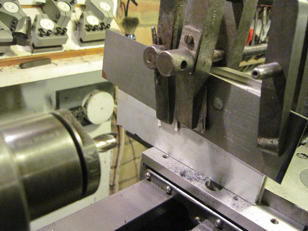

                                                      The drill stands are OK for smaller holes William (where great precision isn't really needed) and one will generally be easier to manage than a tailstock pad. The stand/drill combination won't handle slot drills – the drill will be too fast and the stand not man enough.
                                                      But you already have a lathe and that can be your 'precision' drill when required – or provide a much more rigid set-up than a drill stand can ever do. Here is my favourite 'V' angle-block being set-up on the cross-slide.
                                                      Here I've just used a 10mm (ish?) slot drill to cut a hole in a pair of frames for a small Sentinel engine I built a while back. Note the use of the Clarkson collet chuck (I do use an ER32 one too) to hold the slot drill and also the aluminium sacrificial plate behind the work. The plates were superglued together for this job and marked out for drilling. The holes were simply positioned by lining up the punch marks with a centre in the headstock. The work was then moved and re-clamped. Absolute precision was not required – provided the two sets of holes aligned with each other (which being both sets being drilled at the same time) – they did.
                                                      I will admit this was my second attempt – I used a 10mm drill the first time around and it snatched (thin material) and moved the work, resulting in an oblong hole. The slot drill solved this on the second attempt.
