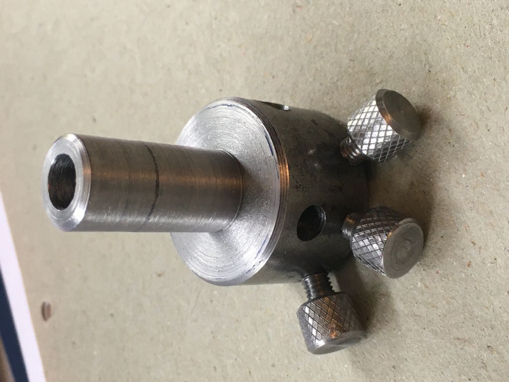

      I am a complete novice working my way through 'Lathework A Complete Course' by Harold Hall and am presently making the tailstock die holders. I have encountered a problem manufacturing the die holder screws in that, having knurled 10mm mild steel bar (of unknown spec) and turned down a length for threading M5, the studs end up bent after being died down. The turned section is perfectly straight after turning, and I am taking great care not to apply any side pressure to the die holder whilst threading, so am struggling to understand what is causing the bending, and what to do differently to avoid it.

                                          Steve Rowbotham
                                            @steverowbotham77083
                                            I have actually made the 13/16 holder (see pic) albeit with slightly bent screws. Based on the considerable advice above I will make the die holder support next and then use the die holder to thread new adjuster screws for this holder and then the larger (1 inch) holder. I will also reduce the turned diameter from 5mm to 90% as suggested. In terms of prominence, I purchased a tap and die set from a prominent dealer and have been very happy with the way the taps cut, the dies appear to be good quality so I think operator error rather than die quality is the issue. Many thanks to all who have taken the time to respond and help me on my way with such great advice, this forum really is a fantastic resource for a novice. Stevee149eaa5-c4d2-4213-bb15-bb99cd424921.jpeg
