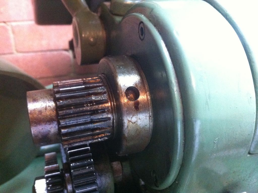

        Paul, mine has one piece 4 speed v belt pulleys. One possible point to lock the spindle is what might be a tommy bar hole on the left end of the spindle.spindle end

        J Hancock
          @jhancock95746
          Have serious think before you do that, using that collar nut !
          It will either ' do it ( the collar nut ) up' too tight or 'come undone' when you least need it to happen.

          Peter Krogh
            @peterkrogh76576
            That collar with the hole is the end clearance adjustment for the spindle!! Don't use it to wrench on.

              Brian Wood
                @brianwood45127
                Hello Simon,
                The collar looks to be an adjustment to set up spindle end play on a thrust bearing, it seems to be threaded at the base and would not a good thing to use as Mr Hancock has advised.

                  Simon Collier
                    @simoncollier74340
                    I can now see from my photo that that is a nut so, as advised, I won't be touching it. Anyway I anticipate no further trouble as I have applied copper-based anti seize to the nose threads. This stuff works wonders. Recently I made a steam brake valve for a loco, and on first use, after about 8 minutes, it seized solid. On getting home I had to use a staggering amount of force to drive the spindle (3/8" 316) from the bronze (LG2) body. I polished it up and re assembled. Next steam up, it happened again, exactly the same. Third time, I applied the anti seize, and it has worked smoothly and freely since.
