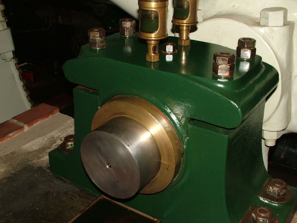

                                  Many a bearing cap has a good gap between it and the lower housing so you often see nuts and locknuts on the studs as they are not fully tightened down but just enough to allow the shaft to rotate freely in the bearings. From that it can be deduced that the bearings themselves to not have to be closed right up so the split faces touch. Some engines will have shims between cap and housing but less so or had shim placed before the bearings were bored..
                                  Take a look through that old book pdf and you will see the gaps and on the larger engines there was also facility to close up the bearings front to back as they wore or were rescraped.

                                          Yes – Jason Is spot on here Doc, the cap just holds the bearings in place and should not distort them – if you think about it if the cap is fully tightened down to the housing/pedestal and the shaft is free to rotate then the shell must have a gap – the slightest distortion will tighten things up considerably – any wear cannot be taken up unless the cap is further reworked.
                                          The caps are usually relieved each side of the bearing cavity to allow this. 'Setting' the locknuts will soon reveal just how little movement is required between locked tight and running fits. IE the clamping pressure is entirely set by the bearing cap bolts.
                                          I thought you were aware of this situation.

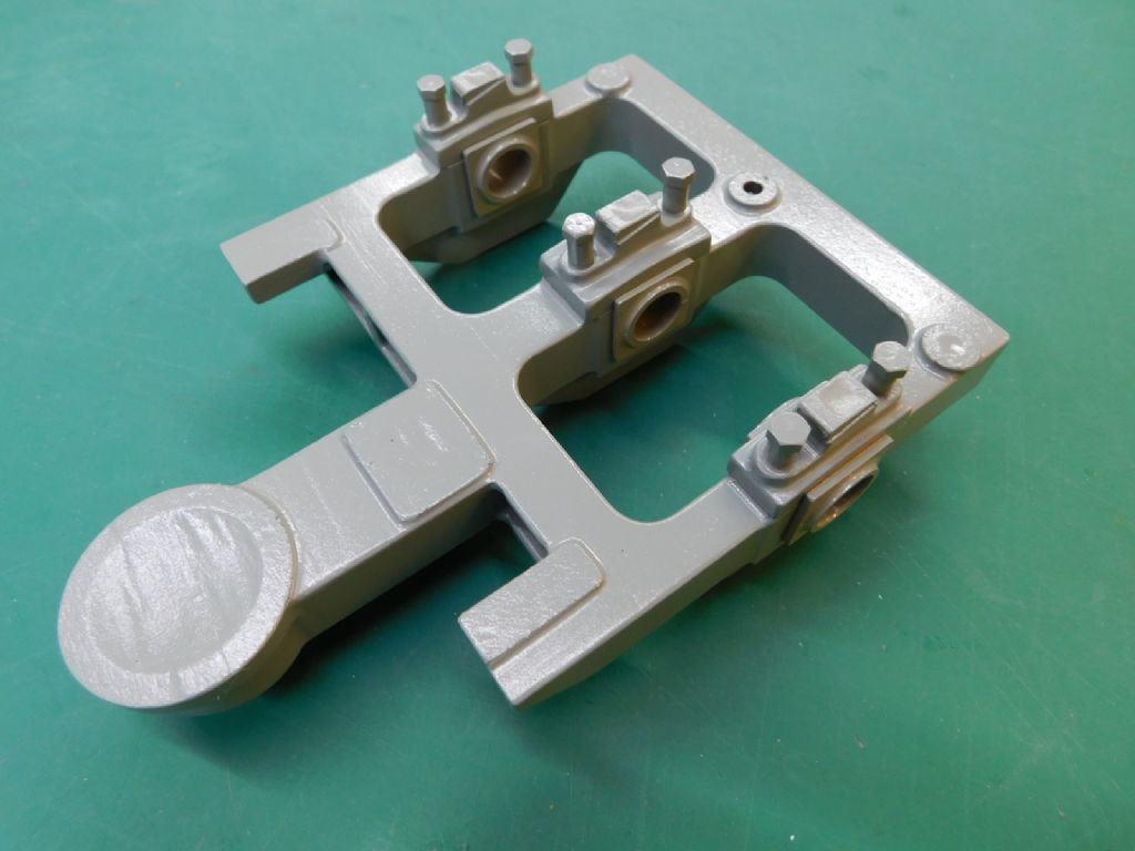

                                                So, deep breath, and try again…
                                                I cut the block in half to stiffen everything up:
                                                Faced:
                                                Flange O/D turned from square:
                                                Set the grooving tool normal:
                                                I had to use back-gear to avoid chatter, but all ok. The recess was by far the hardest part. Once again I found it difficult to judge dimensions and simultaneously machine a width and diameter without going over or undersize on one or the other. Having the saddle stop at one end was fine, but it’s fresh air at the other end, and very easy to go too far in the width while getting the diameter. What I did was get the width right, then when the diameter was almost there, undersize each end to avoid the pedestal radii. This left a raised block in the middle, and I changed tools to a normal turning tool to reduce that until it was the perfect diameter to match the housing. All a bit sketchy I think, but it worked.
                                                Then clamped in the spare housing:
                                                Drilled and bored to a good running fit on the shaft:
                                                Then parted-off without issue. Again, judging and adjusting the cut to give the right flange dimension was very difficult:
                                                Here’s the result:
                                                Fit seems fine, runs smoothly enough with the cap screws loosely tightened, but binds slightly when fully tightened.
                                                So I’m calling that one OK. Now for the other side.
