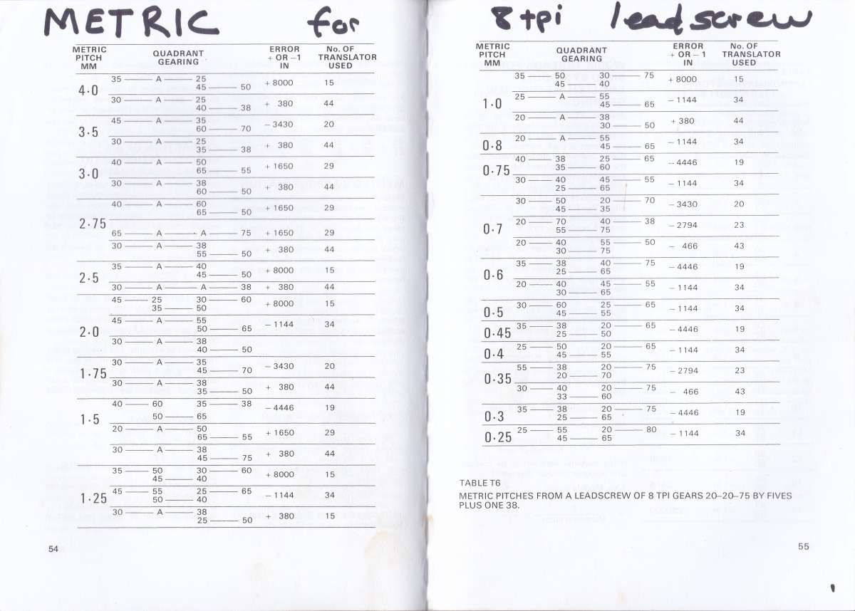

        Here is a handy chart showing how to gear to cut metric threads on any lathe with an 8TPI leadscrew, eg Myford, Granville etc. All using the standard gear set “by fives” and the standard 38T used for cutting pipe threads. As the third column heading shows, error rate is usually between 1 in 3000 and 1 in 8000 or so. IE, one thou error over 3 to 8 inches. Close enough for anything outside aerospace, especially on 50-year-old mass produced hobby-grade leadscrews!
        Disregard the final column “Translator”. It refers to the math used to calculate the gears in the chart and has no practical bearing for the end user. Just set up the gear train as shown in the column “Quadrant Gearing” and carry on (metric) screwcutting. I have used this method for years on two different lathes with wholly satisfactory results.
        Metric on 8tpi chart screwcutting

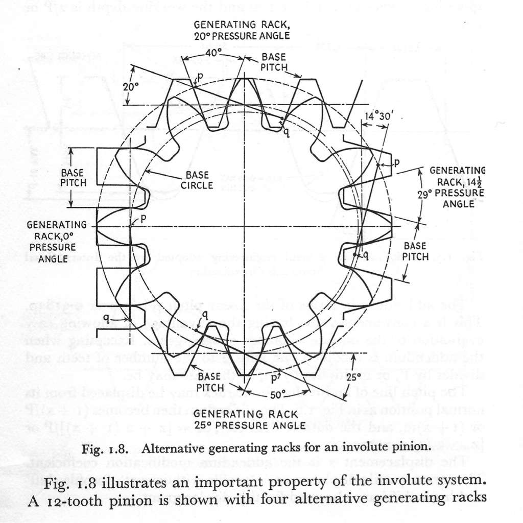

        #814108
          On duncan webster 1 Said:
          … also how to measure PA
          This rather cluttered illustration might help, Duncan
          IMG_0913
          Easiest if you get some tracing-paper, or re-work it in CAD

              Yes, I have not calculated change gears from first principles since sweating over final trade school exams as an apprentice. Out in the real world there was always a chart on the lathe, or in the lid of some old boy’s toolbox, Machinery’s Handbook or these days online calculators.
