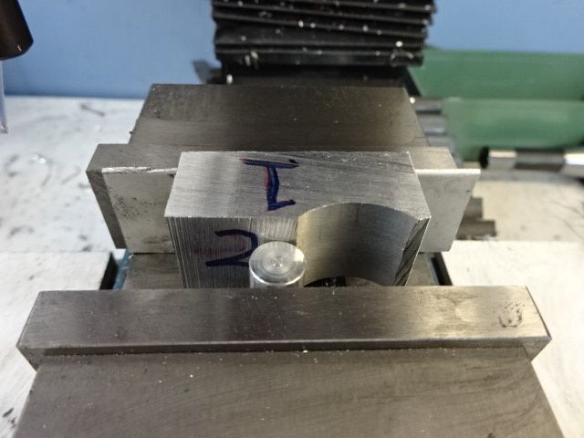

                                    I managed to reduce the CI block to size, although it slipped in the vice at one point and stalled the cutter while conducting the 8mm test run.
                                    I’m now set up ready to mill the recesses in each plate, then surface to thickness. I’ll try that tomorrow.

                                        Hmmm it’s by no means the first time work has slipped in the vice.
                                        I thought I read somewhere that paper shims can help with grip, but as you can see, that didn’t work out too well:
                                        It was this movement of the workpiece that snapped the two previous end mills. Luckily I caught this one in time.
                                        #605027

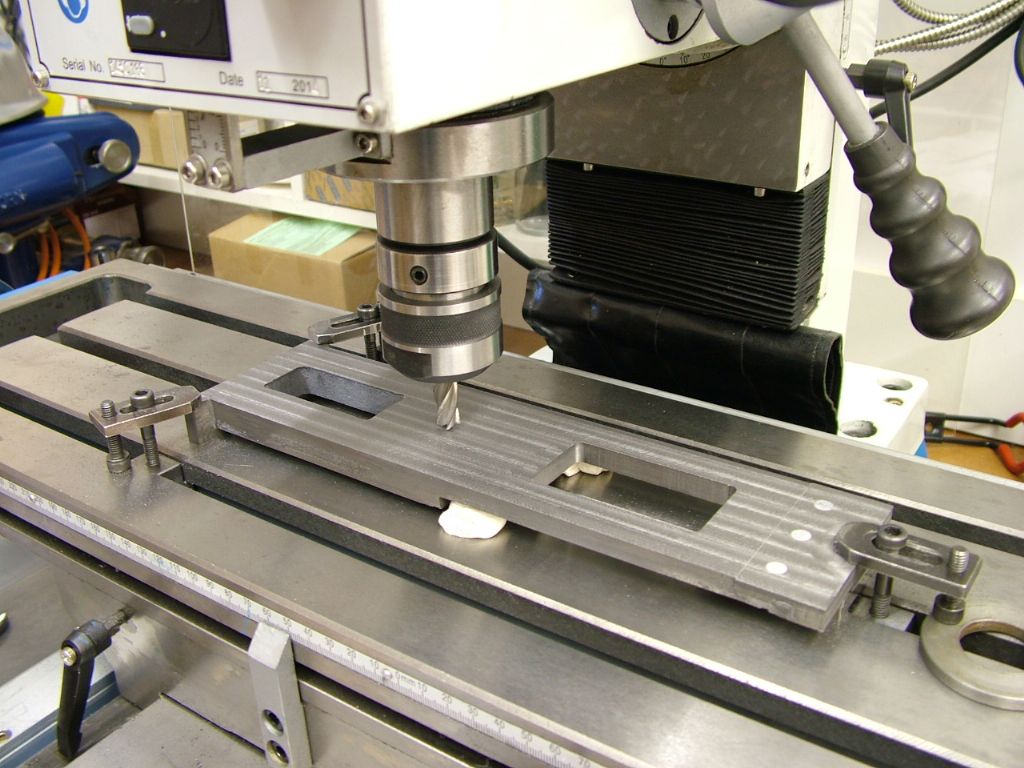

                                          Well I was going to say there are two issues but you have a third user related one there which I will deal with first.
                                          From the look of the sides of your block it appears sawn so the chances of two opposite faces being parallel to each other are slim. Yes a bit of paper, card or thin aluminium will all help with grip but as there is little angular movement in the jaw you will be putting the tightening force onto the block at it's thickest point which from your latest photo was on the right hand side.
                                          The way to grip sawn blocks or castings for their initial cuts is to choose the flattest preferably non convex side and put that against the fixed jaw of the vice, paper can be added. Now on the other side you want close to a central point load which is best applied with a small piece of aluminium between moving jaw and the work. This not only holds the work firmly (3 points of contact) but also helps keep the flatter side against the fixed jaw.
                                          This is the first photo from a section in my book that shows how to deal with a rough block you can see I have aluminium packing at the back and a small piece to give point contact at the front.

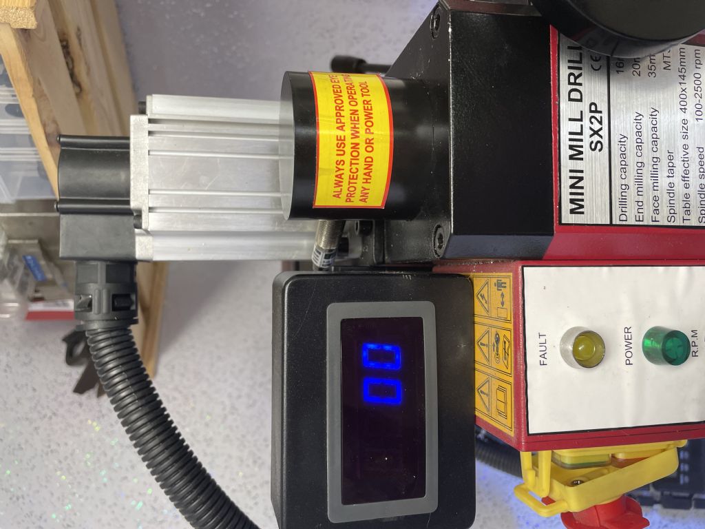

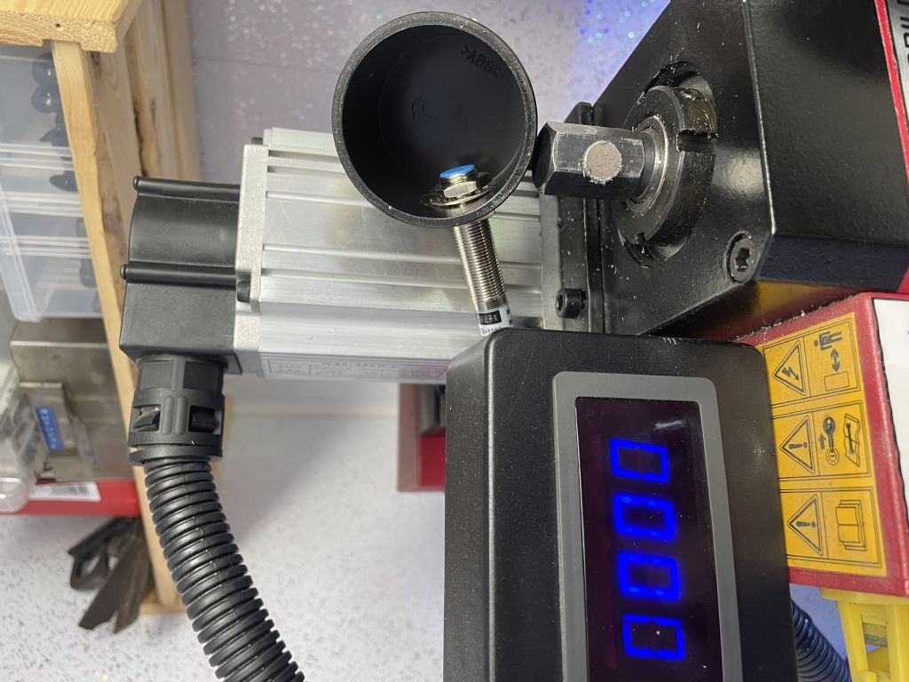

                                            Doc should you want a cheap spindle speed readout thats easy to fit and 100% reliable then have a look at the one I fitted to my SX2 in the photo below. Available from a well known auction site, I paid 6.50 for mine 3 years ago but I see they are now a tenner but still well worth it.

                                                  Ron – The only issue with that rpm sensor is that you can’t then fit the upper bearing cap. I was told by Arc that it’s important to always replace it to keep debris out of the bearings.
                                                  Could the speed control dial be calibrated instead?

                                                    772dc67e-d244-456b-924b-8ec3a2a53d61.jpeg47bc23ed-1c6b-48e0-8673-12c3e16d6279.jpegHi
                                                    This is the speed indicator on my mill, magnet held by its own magnetism.
