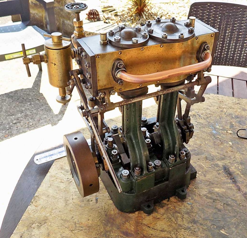

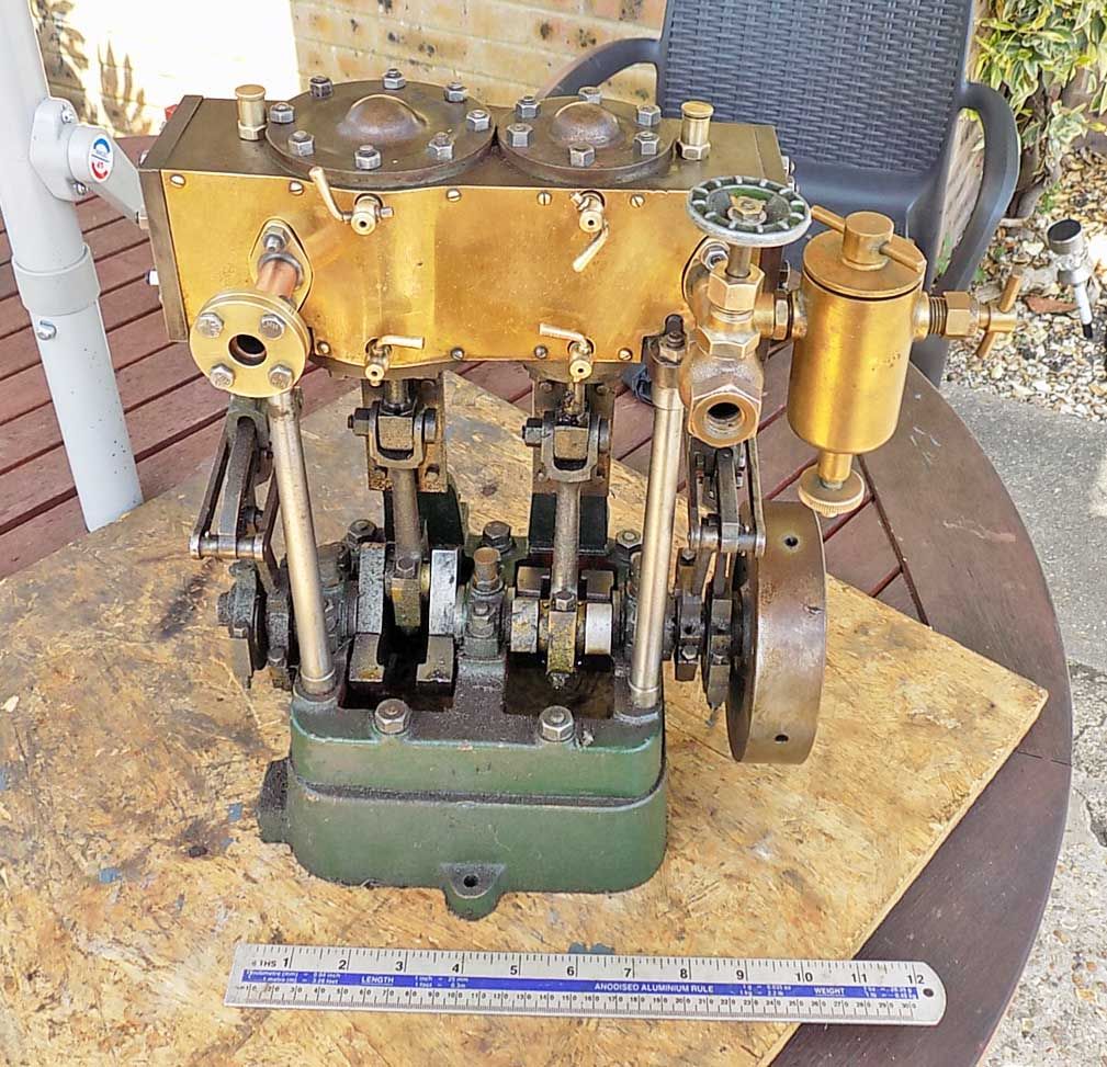

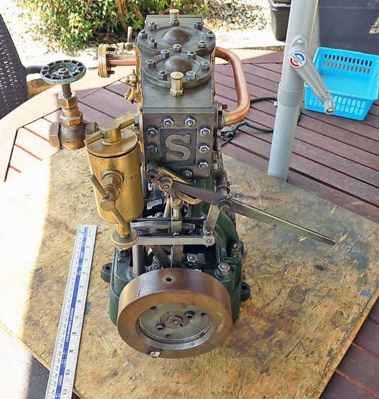

      Hi All,

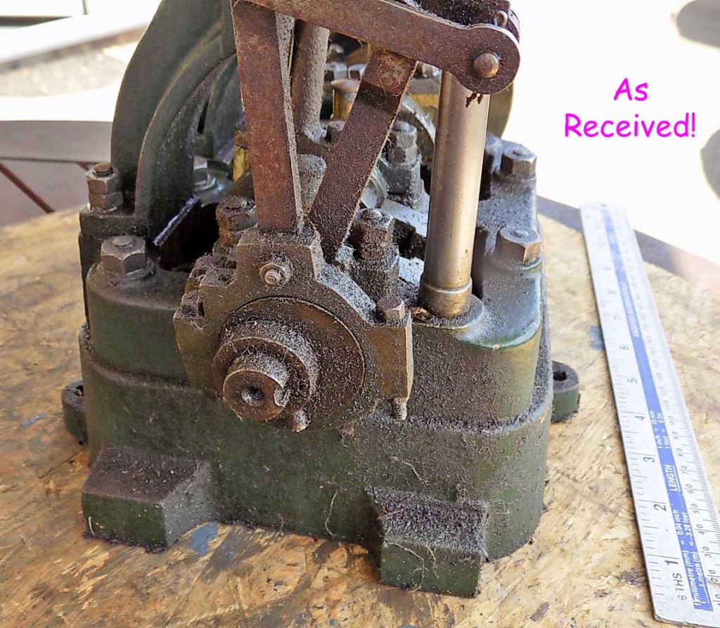

      Just had a clearance guy I know drop this round to me, asking was it any good to me! blush
      Covered in flffy oikly rubbish as shown at one end.

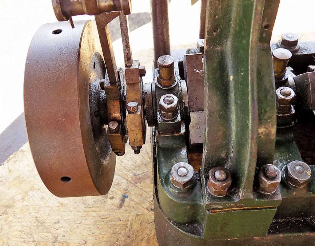

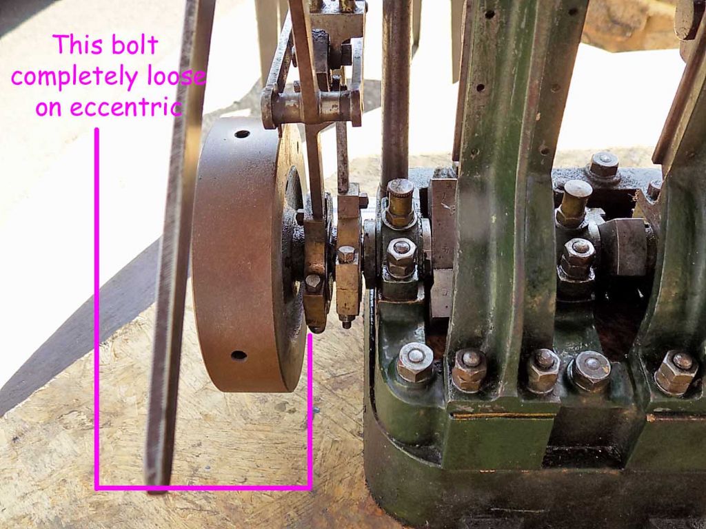

      Quite hard to turn butall seem OK except there was this really loose bolt on the front eccentric which I think is something to do with the reversing gear.
      I want to try and get this running on air to see how it goes before selling it and of course give it a bit of a tidy up which I have started on already.
      I do not want to do any damage without first sorting out this loose bolt problem, any help would be most welcome, it seems like a nice find and quite a big lump! Cheers, Martin

            Just nip it up but not so tight that the strap starts to bind on te eccentric, ideally add locknuts to all these fixings.

              Hi Jason, So this being loose will not have affected the timing?
              Am I correct in thinking that his is a Stuart No:3?
              Will it run on air from my Axminster small compressor, about 90psi?
              Cheers, Martin
              #354697
                Not timing should be OK, if the actual eccentric had moved on the crankshaft then it could have affected things.
                Looks like a No3 with reversing gear.
                Should be able to run on a lot less pressure which will allow a small compressor to keep up but being a compound won't run any where near as well as it would on steam

                    Well today I spent some time cleaning the unit up and then improvised a crank handle and turned it over by hand for about 10mins which made things a lot smoother and easier.
                    I then oiled everything in sight and found that my compressor air fitting matched the intake thread perfectly. So taking that as a sign from above I let some air in very gently via the gate valve and bugger me if it didn't start to turn over very slowly and smoothly indeed! Ran it that way for about 5 mins then let some more air in and it speeded up very nicely. Only did this for about 30 secs as I was worried about it getting enough oil.

                      The displacement lubricator will only work when running on steam as it works by condensate falling to the bottom of the container which makes the oil rise and that is then carried into the valve chest and cylinder.
                      Short of fitting an inline oiler to your air line a few drops of oil into the inlet and a drop into each drain cock before a run will be fine.
                      Reverser is really just a case of loosening the small ball ended locking lever and then lift the big lever up. This will move the two quadrants (expansion links) so that the other eccentric rods line up with the valve rods. Hopefully these two eccentrics are timed for running in the opposite direction.
