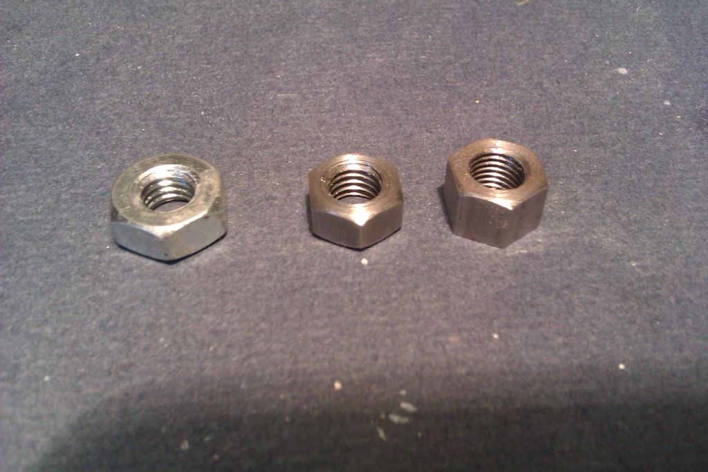

      I was wondering if anyone had any views on if there was any reason why I shouldn't fit the Box Bed Studs from the bottom of the bed so that they are threaded into the Sole Plate from below thus hiding the nuts i.e.. with the studs protruding into the hollow base? The 1/4 BSF nuts provided are a very close fit to the edge of the frame and 'Standard' seating mount when fitted as they should be from the top – they will fit with spot facing, just, but I think it may look better to hide them. Wondered if anyone else has maybe done this or similar? Would there be less 'fixing' strength to do so..?
      (Jason, I can't see these nuts in the 'Gold' photo you sent me so I think something similar may have been done there as well.)
      Thanks for any thoughts – some photo's to show better…
      Plenty of room in the base and a standard length drill could be used – I have an 'extended' smaller one to use for a pilot.. Would just need to run a Die down the studs to extend the thread a bit..
      The 1/4 BSF nuts would be a very close fit and maybe look a bit large when fitted 'normally'.
      Regards and thanks.
      Allan.

        How thick is the sole plate where you are thinking of putting the "hidden studs"? Other Stuart No1s seem to not have their nuts over hanging. You could look to counterbore then add raised bosses for the nuts to sit on.
        If you put the nuts one the inside make sure there is enough space for a box spanner to get round the nuts.
        Jo
        #149805

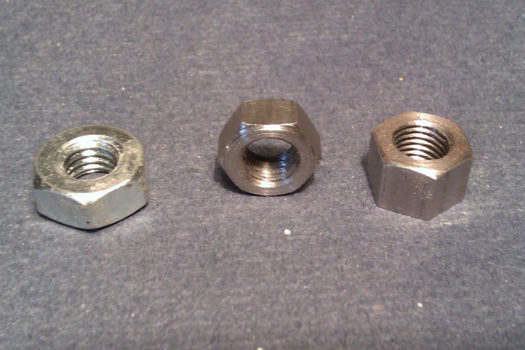

          Commercial nuts on models, thats one of my pet hatesdevil
          It looks like they are now supplying mass produced nuts, 1/4BSF is approx 7/16AF and they also tend to be quite flat and have chamfers both sides. If you look at photos of old engines the nuts tended to have a smaller hex, be taller and also only chamfered on the top.
          Take a look at these, left is a shop bought 1/4" BSF, middle is one I made for a model of an American engine and on the right one for an engine of English origin. The two homemade ones are from 3/8" hex bar and the US one has also been machined to look like what I think they call a washer nut where the bottom is machined to remove the hex.
          So the first thing I would do is think about making some nuts.
          Secondly you could move the hole positions out a bit further as there is enough metal to do so
          The Golden engine does have the nuts on show and they have been spotfaced which is something I would do anyway, you don't need to go out and buy a spot facer, once the hole is drilled lightly plung cut with a 1/2" endmill until you have a smooth seating. Do the drilling and spot facing in the mill at the same position, don't try it on the drill press.

            Thanks for all the useful replies.
            Jo, the soleplate is a solid cast all through and about an inch thick. The top of the Box Bed is about 1/4 inch all the way over. Don't want to be the only one with his nuts hanging about..
            Jason, really interesting photo's, I'll be taking a much closer look at nuts now in future and its all your fault. I need to get in some hexagon bar as I'm beginning to see its uses – I remember thinking it would have come in handy when I was making the Air Compressor adaptor for Victoria's Cylinder..
            John, you are right of course it will hide all my sins and think this may be my best option because of it, also have a feeling I may prefer the look – need think a bit more.
            Cheers.

              Think I'll have a go from the top after all and use an End Mill to spot face as Jason suggested..
