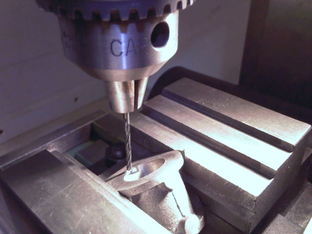

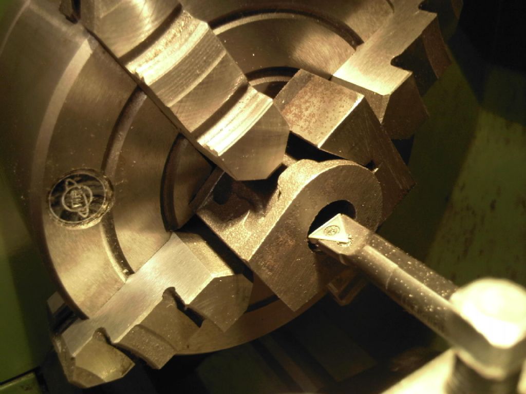

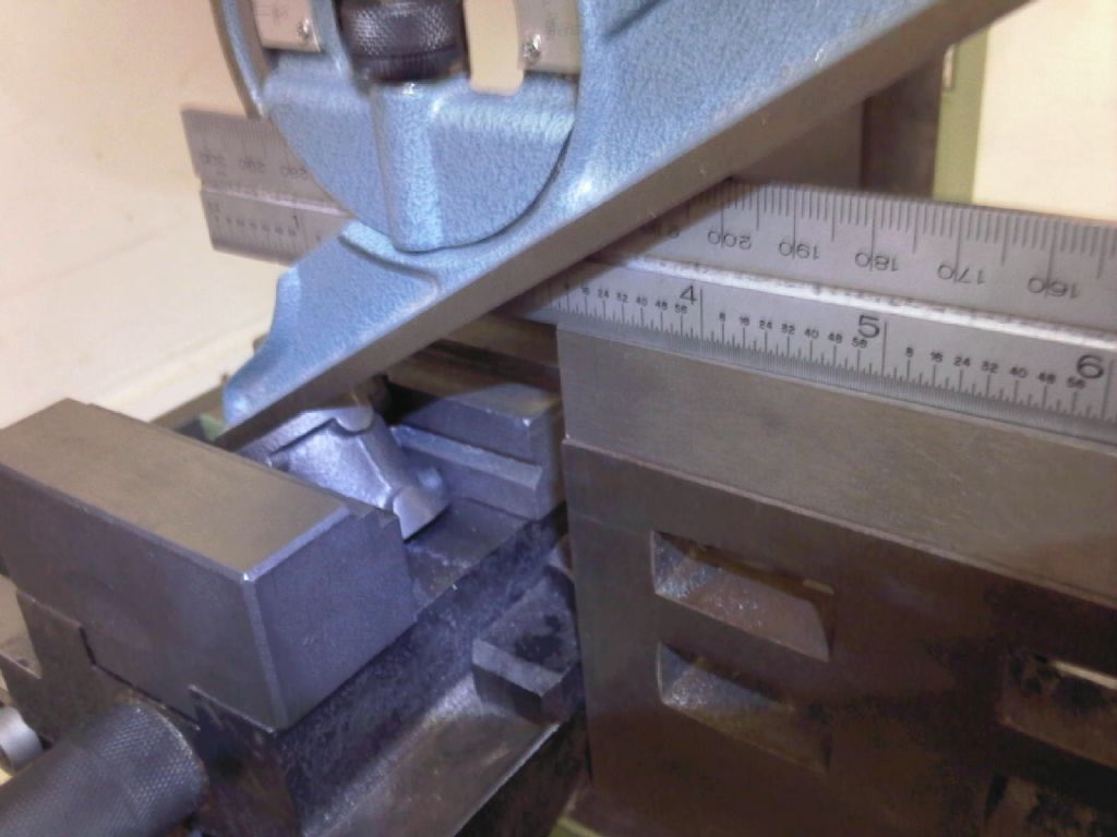

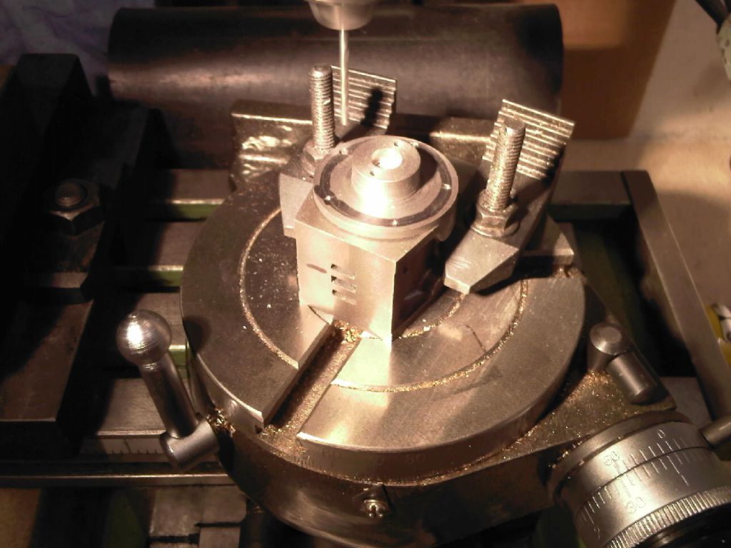

      No problems facing and boring the cylinder, set up around the outer edge with scribe block. just used a small vee block to spread the load on the webs – maybe some packing would help to prevent any marks
      milled the steam way then set to the required angle and nipped in the vice, centre drilled and then drill through to ports
      The three cylinders so far…….

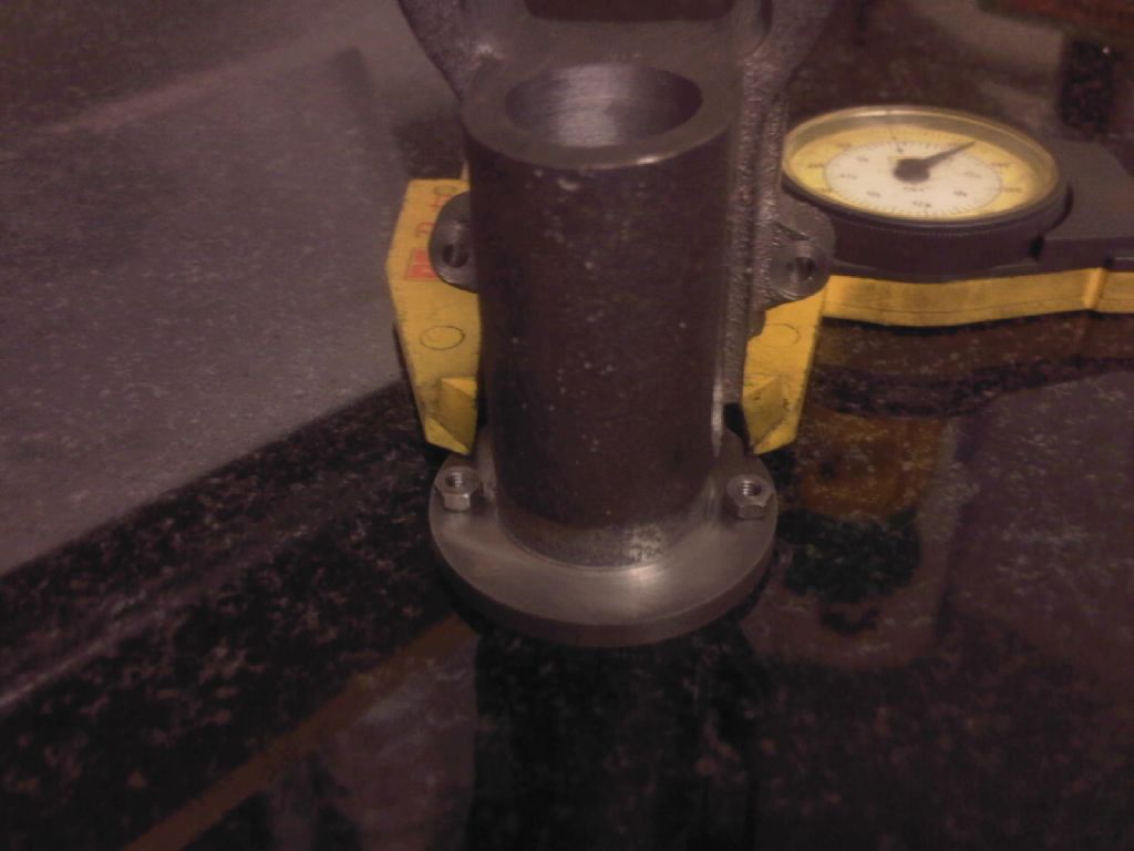

          Hi David, when you come to fitting the cylinders to the frame bed…if the pitch circle dia. on the drawing is used I think you will find it very difficult to fit the nuts at the back of the cylinders…This is the ”Score” I am referring to, I really would like the pitch circle increased a bit on the drawing…I made the mistake of following the drawing and had one heck of a lot of ”fettling” to do plus had to use ”one size smaller nuts”…lucky not to scrap it.
          All the best for now,
                                             John.
          #47704
          Circlip
            @circlip
            Might be worth checking that all the machined faces and the bore are square and true to each other David, boreing using the 4 jaw to hold the cylinder may be a bit suspect. Hope it is true.
               Regards  Ian.

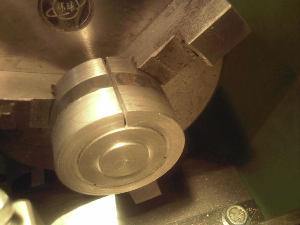

            #47706
            Doddy
              @doddy
              The rough casting was set in the four jaw and set to the rough cast outside edge using a scribing block then the front edge faced, followed by the bore (without moving from the chuck) this ensure the front face which bolts to the frame is square to the bore.
              A mandrel was then made to fit the bore – size for size (just warmed the cylinder with a hot air gun to shrink fit) then the outer face was turned
              The cylinder was then bolted to my face plate on the milling machine to square off to size the port face – will have to find the photo’s
              #47741
              Doddy
                @doddy
                Many thanks lancelot for the tip RE: “fitting the cylinders to the frame bed” will check the PCD – thought I’d make the cylinder covers first then drill tapping size through with the cover/cylinder in place then open cover hole out to clearance size

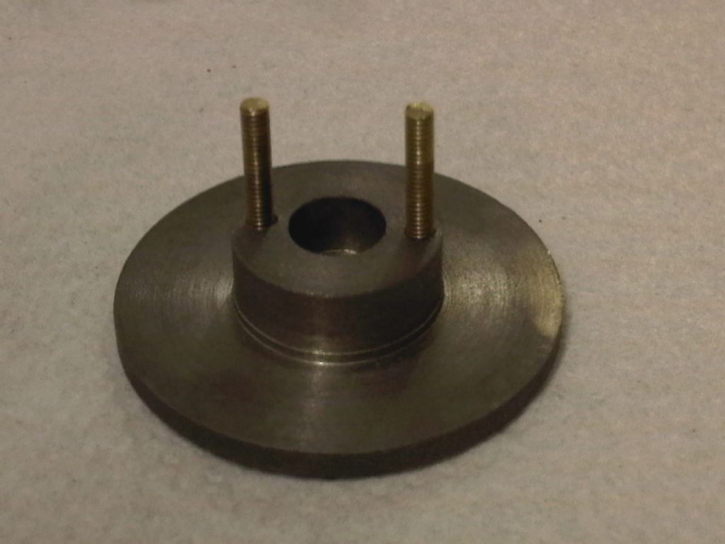

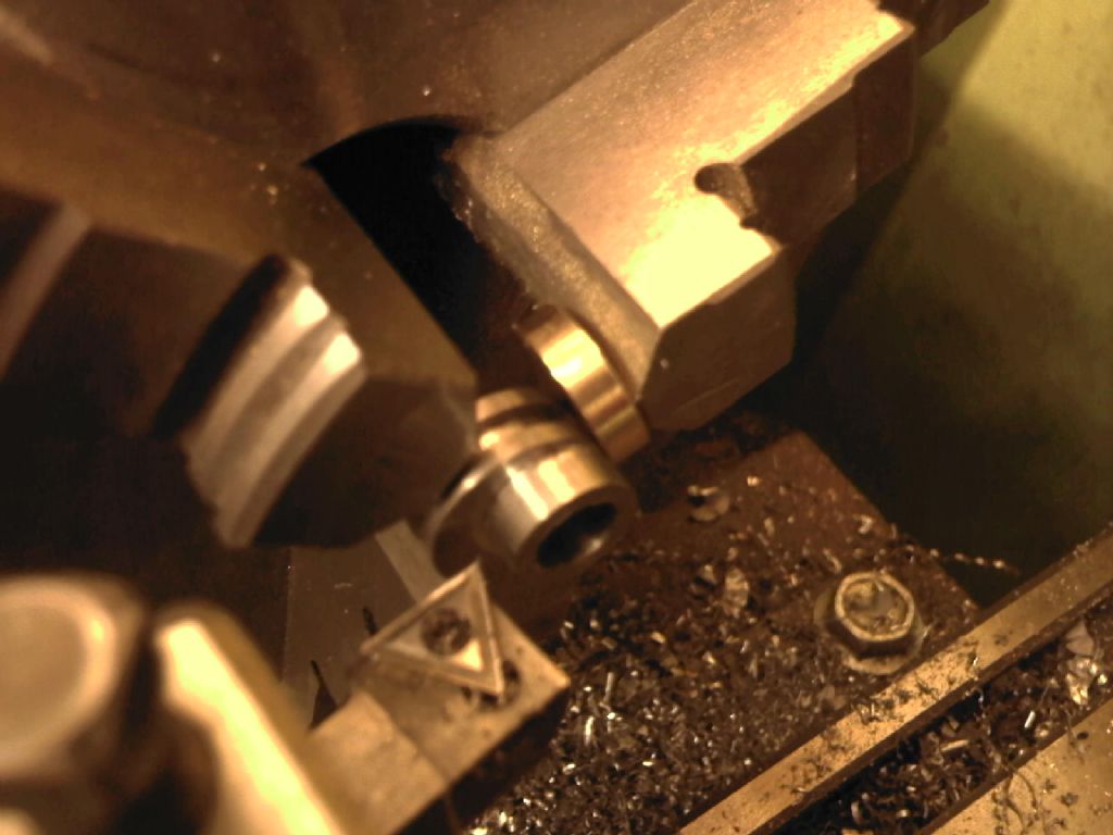

                  Made up a chucking piece and had no problems machining cylinder top covers
                  But now I need some advice – the Stuart drawings shows the Bottom Cylinder Cover which carries the gland housing say to drill and tap 5/16″ br 26tpi   ?    what thread is that – is it an ME thread (thought they were 32tpi or 40tpi) not sure if to go for M8x1.0 pitch or 5/16″BSF or do I make a nice little two bolt hole gland follower in brass using 10BA studding ?  I know it will be small an  fiddly  to nip up – any thoughts most welcome
                  Any thought on were to spend my money on HSS taps and dies  ME or Metric ?

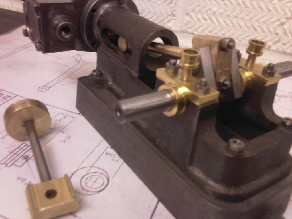

                        #48853
                        Doddy
                          @doddy

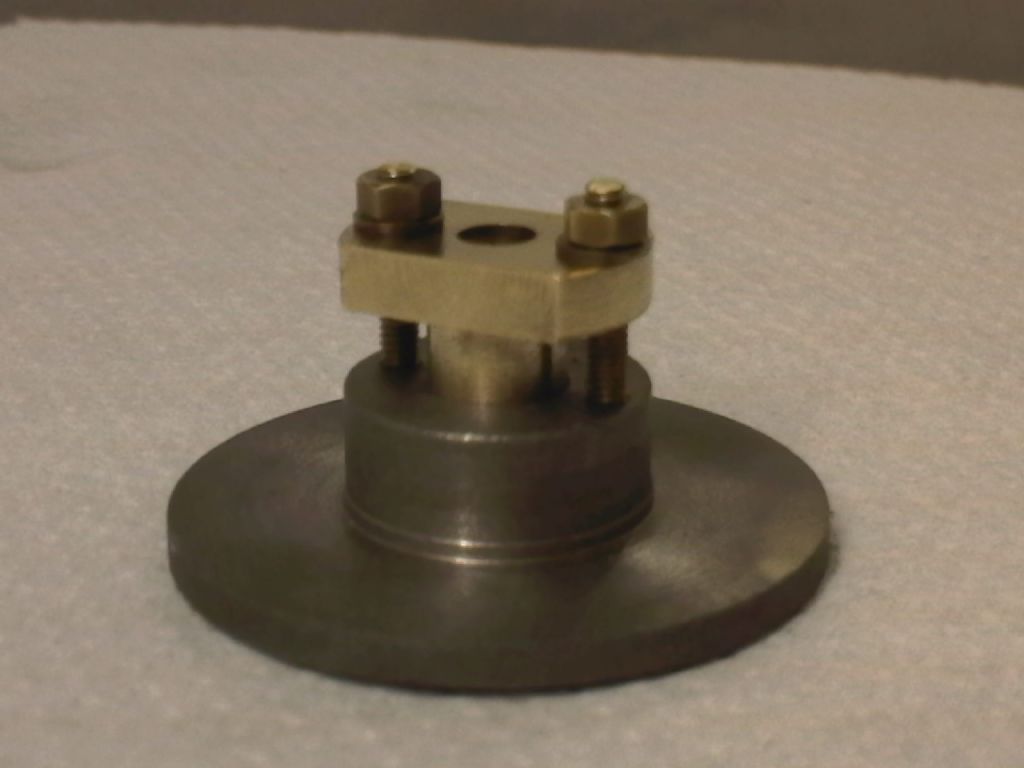

                          Ok as I’ve not yet saved enough pounds, shillings and pence to buy some decent ME taps and dies I’ve made my Stuart 10H a nice little gland follower with 8BA studs, just enough room and should be able to get a spanner on to nip up the gland.
                          I know the purests will frown on me not following the drawing, but as I don’t intend to run this on steam, I don’t think it to much of a problem, and I think it looks much better, but failing that I can always make the gland as per the drawing once I’ve spent some of (her in charge) money
                          Gland follower using 8BA nuts and studs
                          Dosen’t look much room but should be able to get an 8BA spanner on !
                          Similar dimensions to the threaded gland follower on the drawing so should clear the Crosshead ?
                          Edited By David Dodwell on 19/02/2010 16:49:25

                            Looks great to me, well done.

                            #48910
                            lancelot
                              @lancelot
                              nothing wrong with that… actually solves some of the inherent binding problems involved with the threaded gland type…keep her cutting David.
                                                                                                                                            John.

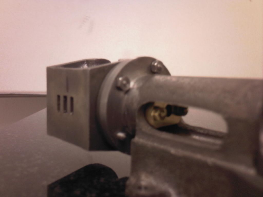

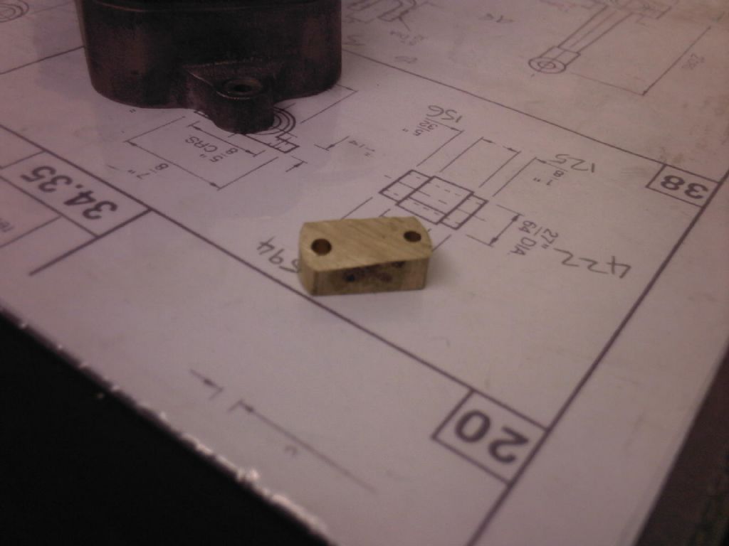

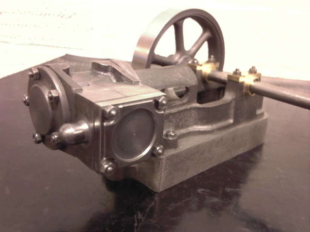

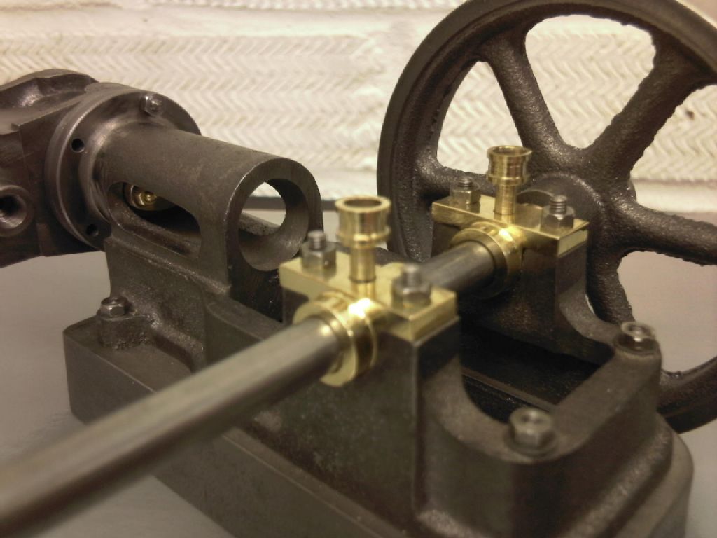

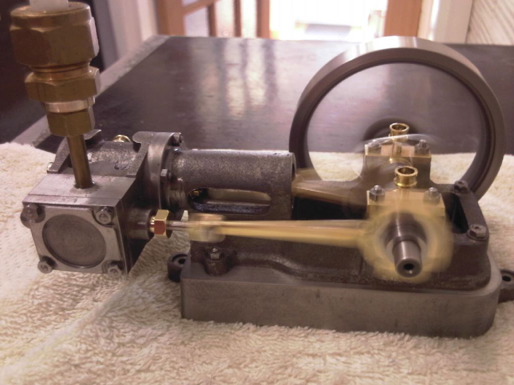

                                  Wasn’t to keen on the Stuart “S” cast in the middle of the valve cover so made my own from a cast iron off cut
                                  Fabricated the crank – be-aware that the plans show the crankpin to be 5/8″ long – It’s not it’s 11/16″ (many thanks for the tip off “Pengwern”)
                                  back in the lathe to clean up crank webs
                                  Made some oil cups
                                  Crank installed and aligned – had to trim a few thou off the inner faces

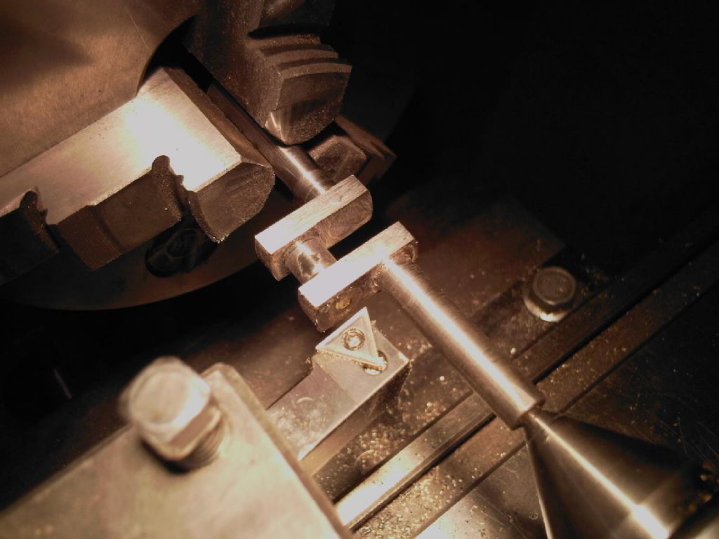

                                      #50492
                                      Doddy
                                        @doddy

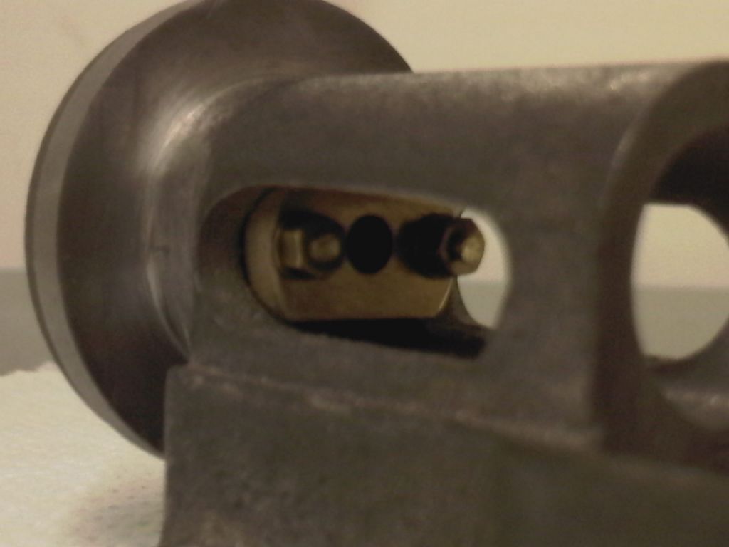

                                        So how did you split the con-rod big end? – I was going to use a fine slit saw in the mill but struggled to find an easy way to hold it square, as it won’t fit my vice very well – then thought about using the Dremmel but again couldn’t hold it secure and square so gave up and used the Juinior hacksaw !  Big mistake !!   too much speed and not enough haste ? (see photo of the run off) – ended up making a new bottom half
                                        will be making a jig for holding the two con-rods for the Double next time – but here its OK now and installed

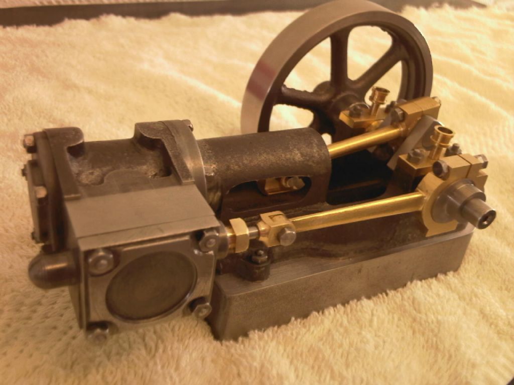

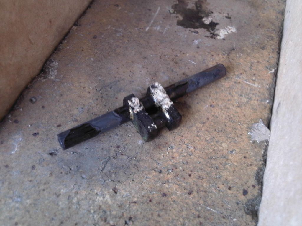

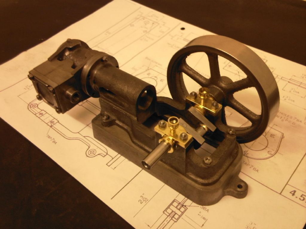

                                        #51453
                                        Doddy
                                          @doddy
                                          Nearly finished
                                          made the eccentric up in the 3jaw
                                          Just some fit and finishing now
                                          Valves – Drain cocks and some pipework next and then the hardest part (for me!) how to paint and finish off – any help most welcome

                                                #52043
                                                Doddy
                                                  @doddy

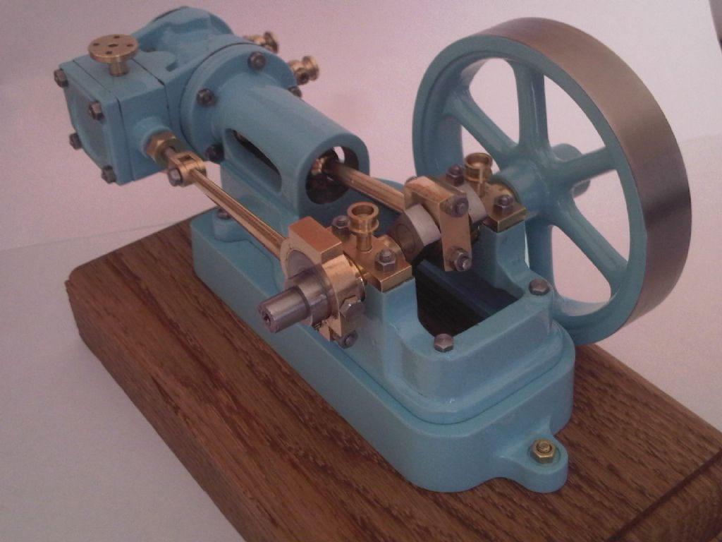

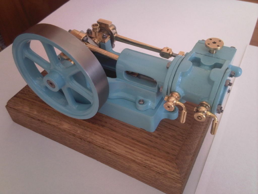

                                                  Made some flanges and drain cocks, painted blue and mounted – called “Samual” after my son
                                                  Just need to make a name plate now and ready to tackle my 3rd project the Stuart Score. I’ve learnt loads making this and feel a bit more confident and less of a beginner !
                                                  Edited By David Dodwell on 23/05/2010 20:14:25

                                                    Very nice workmanship David,
                                                    A splendid paint job and well presented on a nice base – it really looks the part.
                                                    Regards – Ramon

                                                      Many thank Ramon for your advice on painting – I’m fairly pleased with the way its turn out – the base is a piece of English Oak from Richard Thompson – the “mouseman” of Kilburn – they sell off-cuts in the musuem/coffee shop at reasonably prices – well worth a visit
