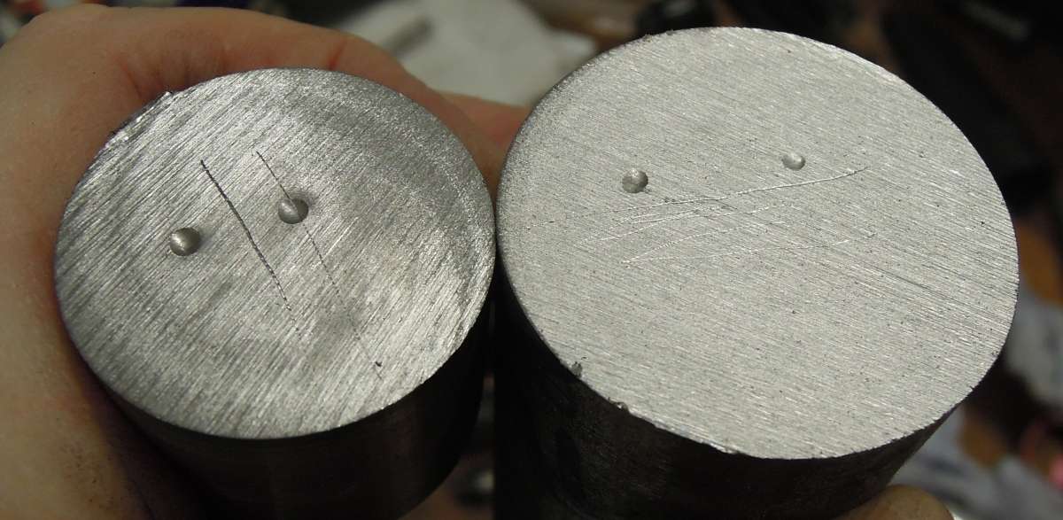

      I decided to put an M12 (std. coarse 1.75 pitch) thread in the end of a piece of EN1A bar using the lathe recently. I drilled it to 10mm as that was the largest near-size drill that I had. The ‘recommended’ drilling diameter for M12 is of course 10.2, but as most drills make oversize holes I thought I would get away with the 10mm drill. However it became clear that the taper tap just wasn’t going engage in the hole I’d made so I decided to order and 10.5 drill to make it a little larger. (It was a long thread, so I always like to keep the tap in the tailstock chuck loosely fitted in the tailstock for good initial alignment.)
      After the 10.5 drill arrived I popped it in the tailstock chuck and expected to be able to wind it in with ease to open out the hole. This ‘simple’ op. didn’t go at all well. The drill initially cut, but as it went further in, it got noisy and began to seize.  A couple of times the chuck spun in the MT2 socket and when I fixed that problem, as I continued to try deepen the hole, the lathe was on the point of stalling. The work piece was well over 100C despite my cutting speed only being about 200 RPM. Eventually I gave up as I decided there must be something wrong with this brand new drill. It was a bit of a battle to remove it from the workpiece but that didn’t surprise me after the problems I’d had.
      Since the hole was a bit of a mess now I decided to compromise again on thread depth and just drill the thing out with my unused 11mm drill. However as I started the process, the same issues occurred. Lots of heat and noise. The lathe was stalling again so I stopped and moved the belts over to slow-speed mode. I thinking that perhaps a faster wind-in speed was what was needed, I wound faster on head-stock. Well this wasn’t an improvement at all. The drill seized the chuck yet again and with all the belts squeeling like stuck pigs I hit the emergency stop ! I removed the VERY work-piece from the chuck with the drill stuck in it. In trying to extract the drill, I broke it!!
      I’m totally mystified. I have been drilling and opening out holes on my lathe for 20 years and have never encountered any difficulties like before. In the past, when I have been intending to bore large holes I always tend to run through with drills up to 16mm in small steps and its always been a piece of cake. So what on earth was different this time ?
      One thought I have is that the ‘new’ 10.5 drill, and my off-the-shelf 11mm unused drill, came from the same source within a few months of each other. They both ‘look’ completely normal. But could there be something wrong with the spiral edge perhaps ?
      Anyone have any thoughts on this strange state of affairs ?

                                  #766624
                                  gerry madden
                                    @gerrymadden53711
                                    Thanks for all your thoughts chaps. I think the mystery is solved.
                                    Last night I did a careful inspection of my existing large drills and my new/unused suspect ones. Attempting to check for taper is not such an easy task as the true cylindrical land is small, and, being helical, its easy to go ‘over-centre’ or ‘under-centre’ on the micrometer anvils. However with perseverance I was able to convince myself that there was no more taper on the suspect drills, than on my others. (There is a little of course due to wear.  At the tip region the diameter was typically of 10 to 20um undersized (approx. half to 1 thou”).
                                    I then gave the cutting edges a good inspection under the microscope and again everything looked ‘normal’. The only slight concern I had was that the new drills probably had less relief angle than my others. That though should really only affect cutting and wear rates, not cause seizures.
                                    Finally I had a look at the material. When I was doing the turning ops, I did think the material was harder than the EN1A I’d used just a week before but just put that down to my imagination or worn cutting tips. However a look at the cut surfaces of the bar in question, and that of my previous EN1A, showed a significant difference in texture. Perhaps that was just down to a difference in cutting conditions ?
                                    A scratch test was inconclusive so I decided to try doing a rough Brinnell Test. I put a small bearing-ball between the two bar ends and impacted them together. I did this twice to make sure. The results are unequivocal as you can see here….
                                    Matl. Comparison Test
                                    The the suspect bar, on the right is significantly harder than that of my previous EN1A bar.
                                    Just to underline the fact that the material is not right, today I put an 11mm reamer though the badly drilled hole in my work piece to clean it up. I and then attempted to tap it M12. Despite the hole now being very oversize, I was unable to put more than 10 taper-tap threads in it. So this stuff is not just hard, work hardening too!
                                    I will contact the supplier tomorrow.

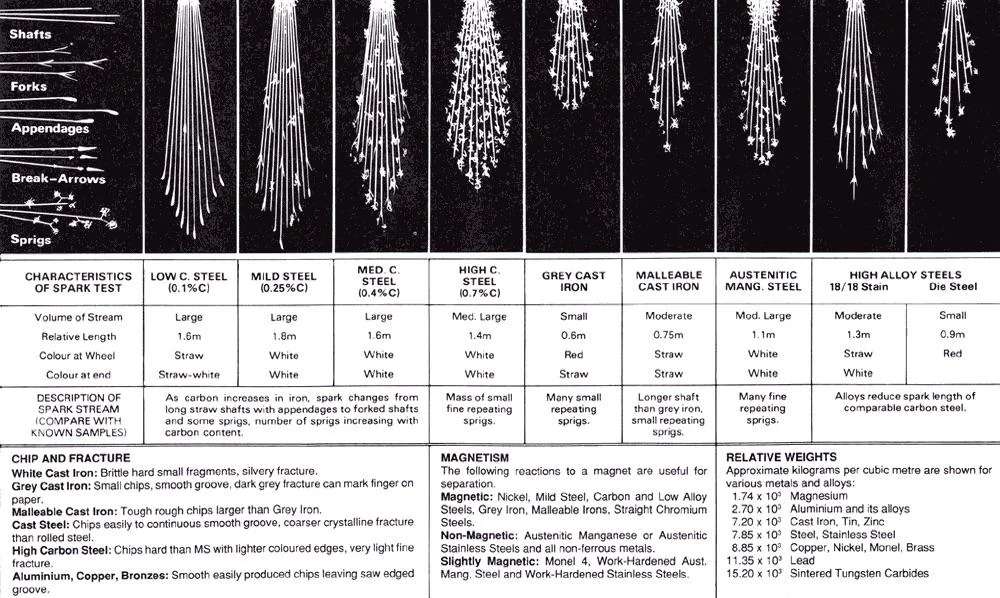

                                        #766769
                                          On Howard Lewis Said:
                                          I like the Brinell test method to compare hardness.
                                          And it worked, telling the difference between the materials.
                                          Well done!
                                          Howard
                                          Me too.  A spark test on a grinder might reveal even more.
                                          sparktest
