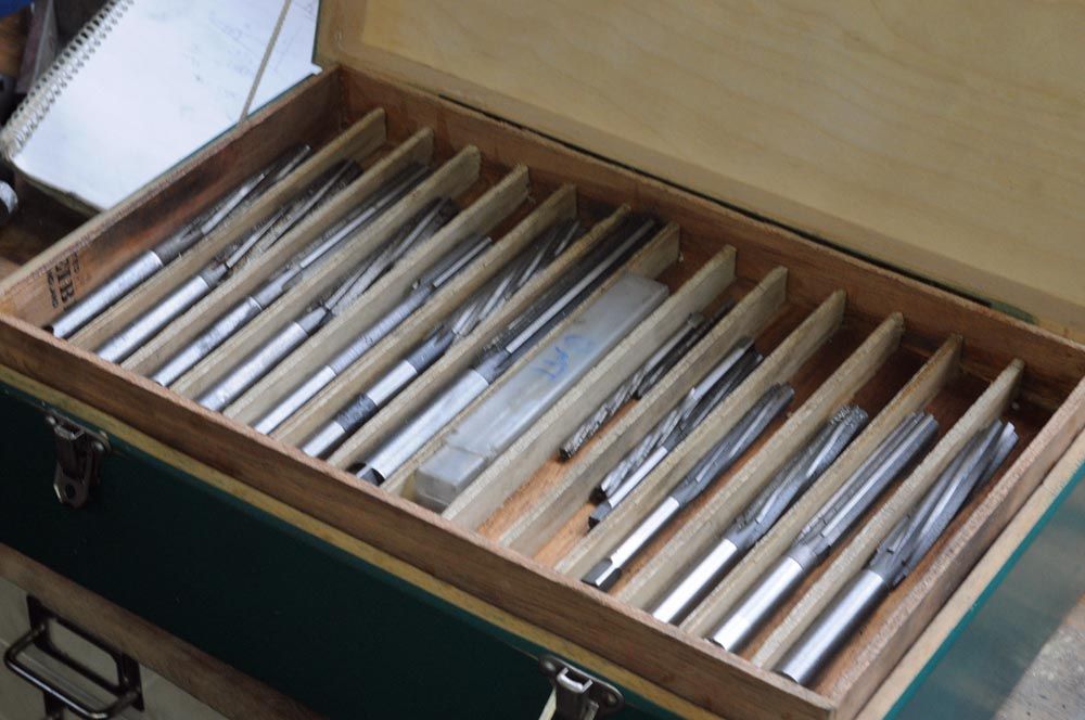

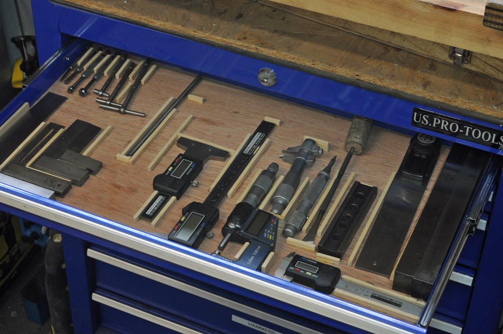

                  I use 4mm ply and bits of hardwood strip just glued in place with PVA on a baseboard:
                  I give the wood a spray with 3 in 1 oil before use. Of course, you could always use 3D printed separators…

                    I would do the same as Rod above and if the draws are a little deep make a lift out tray to sit on top

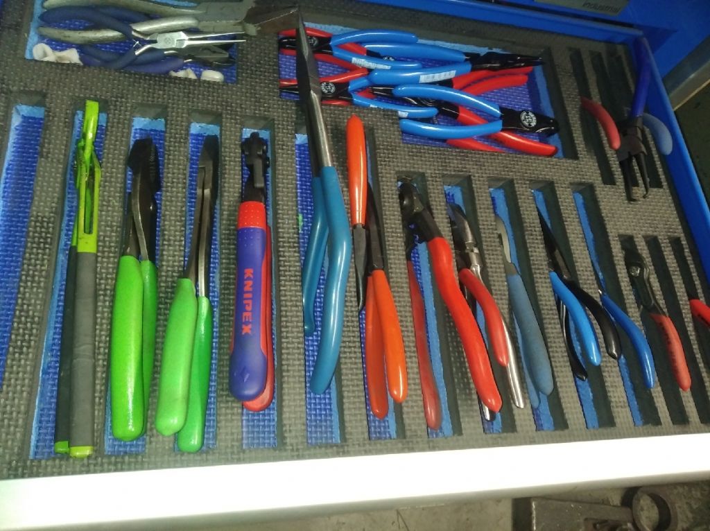

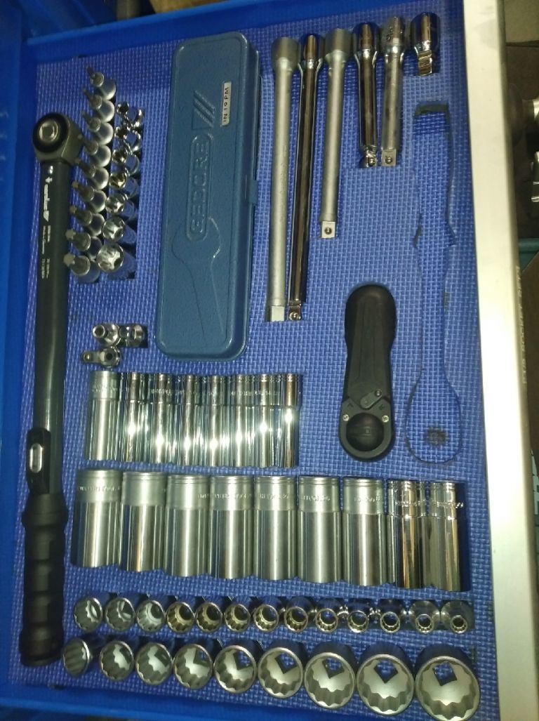

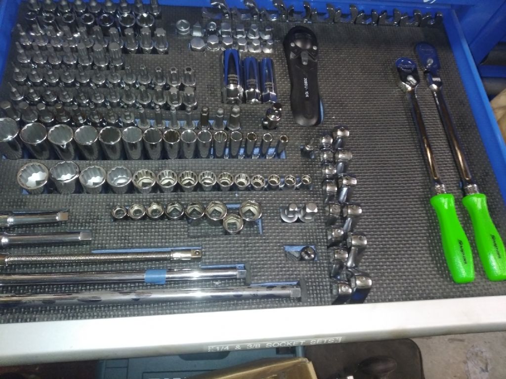

                              Try EVA foam, I've used it a lot for that purpose, it's incredibly tough, and wipes clean of oil.

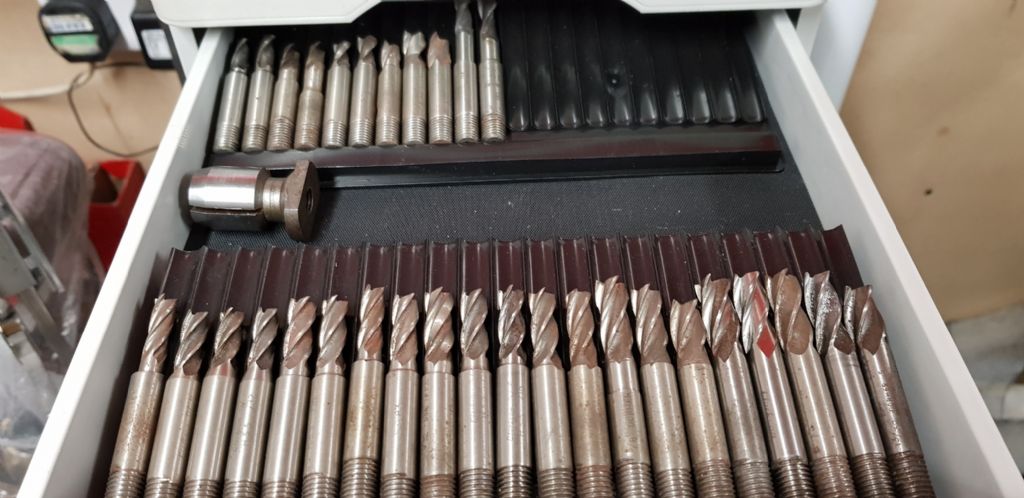

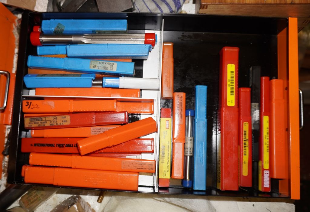

                                      I just superglued cheap 1" aluminium angle to the tray of the draw. In many cases this did not really work but the loose angle kept the tools separated. I have now epoxy glued the angle to thin (1,6mm think) plywood.
                                      Looking at some of the photographs I am amazed to see cutters without their protective cases. A cutter is sold in case to keep it away from the nasties in the outside world. I keep the case and put the cutter away oiled in the cabinet so I know where it is. I know some dealers at shows sell uncased cutters in trays but I would not buy from them.
                                      Tool storage
                                      Rant over.
                                      JA

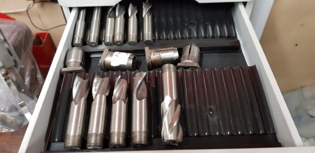

                                            I use a Bisley cabinet in my shed. I lined the drawers with corrugated cardboard, corrugations upwards. That stops a great deal of the rattling.
                                            I drilled a block of thick MDF to keep ER32 collets in place.
                                            I made a couple of trays for dies by drilling through one sheet of plywood to make circles and screwed it to a second sheet.
                                            MC
