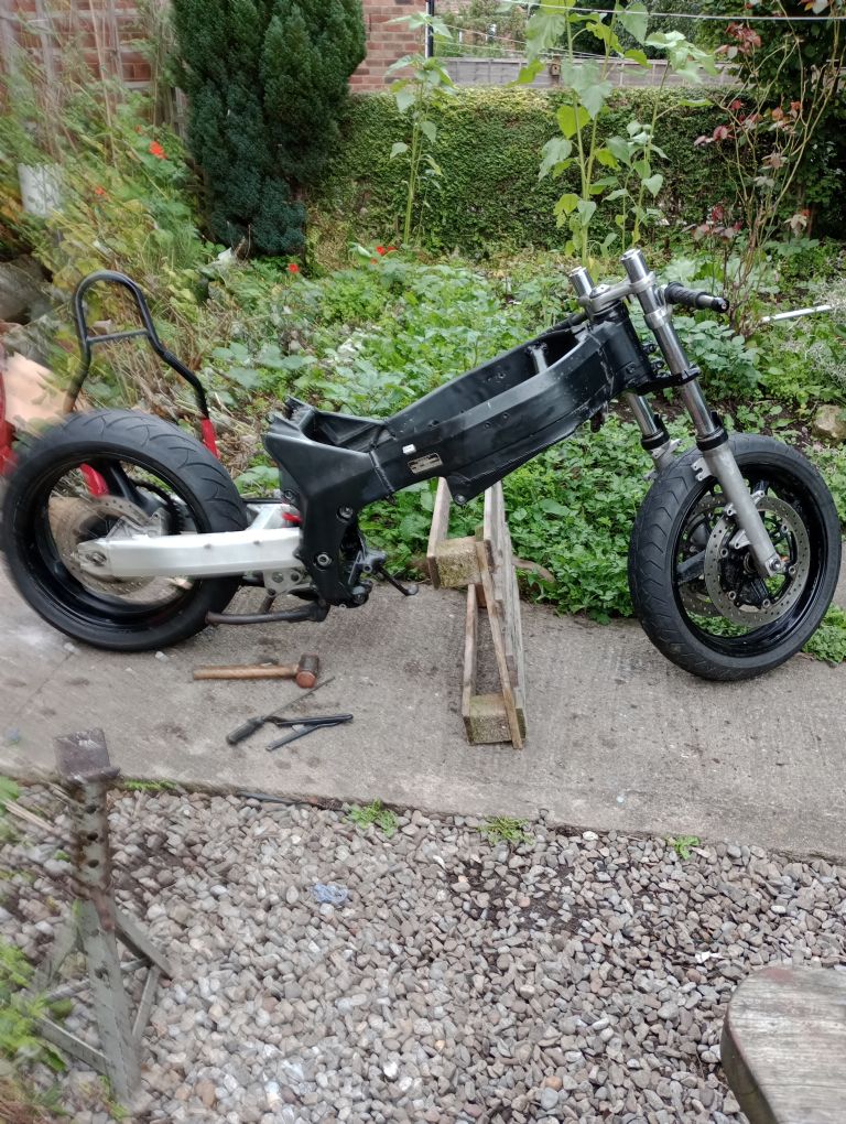

                            Things are moving on with my full size flash steam motorcycle project despite delays caused by serious health issues.
                            A friend from the record scene gave me a Honda Blackbird minus engine to fit my engine in have put new taper roller bearings in the headstock and at the moment checking the hydraulic disc brake system.
                            Its meant for straight line speed attempts so do not need the Honda bulky fuel tank so can get low down on the frame.
                            Have lowered the rear suspension by 3 inches.
                            The generator is awkward to place but will try a certain area for a test.
                            Have been donated a hydraulic lift by UK fastest motorcycle woman's husband to ease lifting.
                            I will do a test run to start with but have a volunteer (idiot) for competition runs have told him he will need asbestos underpants.
                            We have a lot of banter going on in the motorcycle and car straight line speed attempts that what makes it so enjoyable and a helping hand is there if needed.blackbird.jpg
