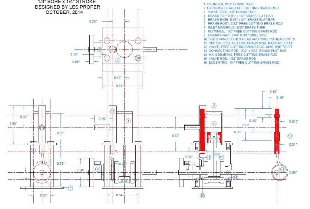

      Am I right in thinking the steam port in the cylinder is positioned as such?
      0.62 + 0.36 + 0.25 = 1.23 – 0.73 = 0.5
      So the hole would be 0.5" from the bottom of the cylinder
      I haven't worked from a plan for 45 years so struggling a bit at the moment.

          That's what I make it too.

            Thanks Jason, why he couldn't add such an important dimension to the plan is beyond my simple thinking.
