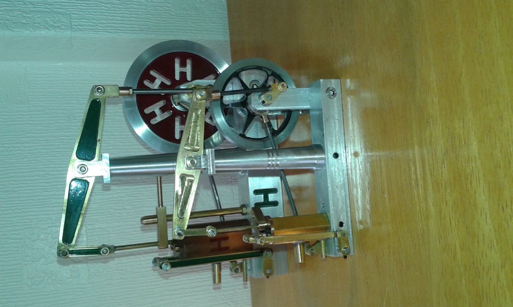

          BOB BLACKSHAW 1
            @bobblackshaw1
            20170912_151429.jpgI've made three Elmers beam engines and the plans are free on the internet. I improved the linkages so they are threaded and nuts used. I found them a very good beginners beam engine to build. I shall make another some time using the parallel motion.
            #352659
              Stew Hart's "Potty" beam engine is one in a series of simple beginners engines that quite a few on here have made. Details here
