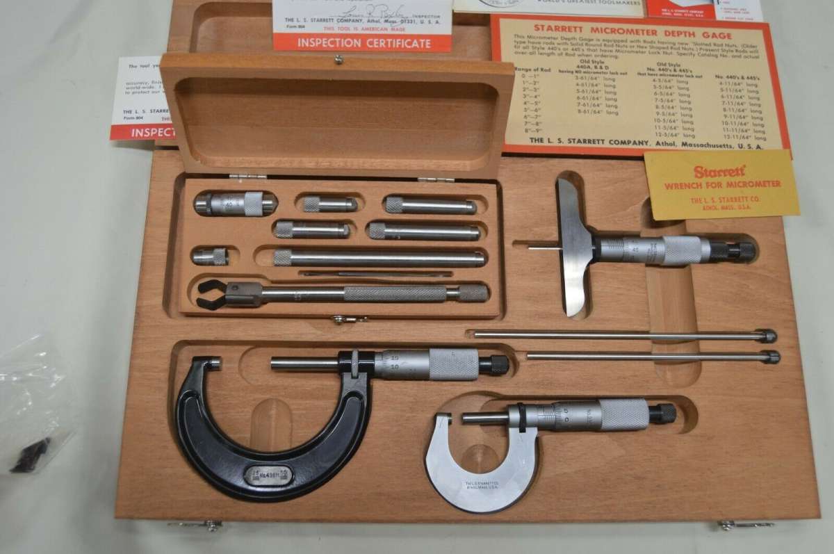

      Instead of derailing the thread about the Starrett No221 micrometer that Graeme Seed started I thought i would start a new thread because Clive asked a question that I think would be quite a valuable thread and deserving of a thread with multiple contributions, I’m sure many on here have more experience with identifying wood types than I do.

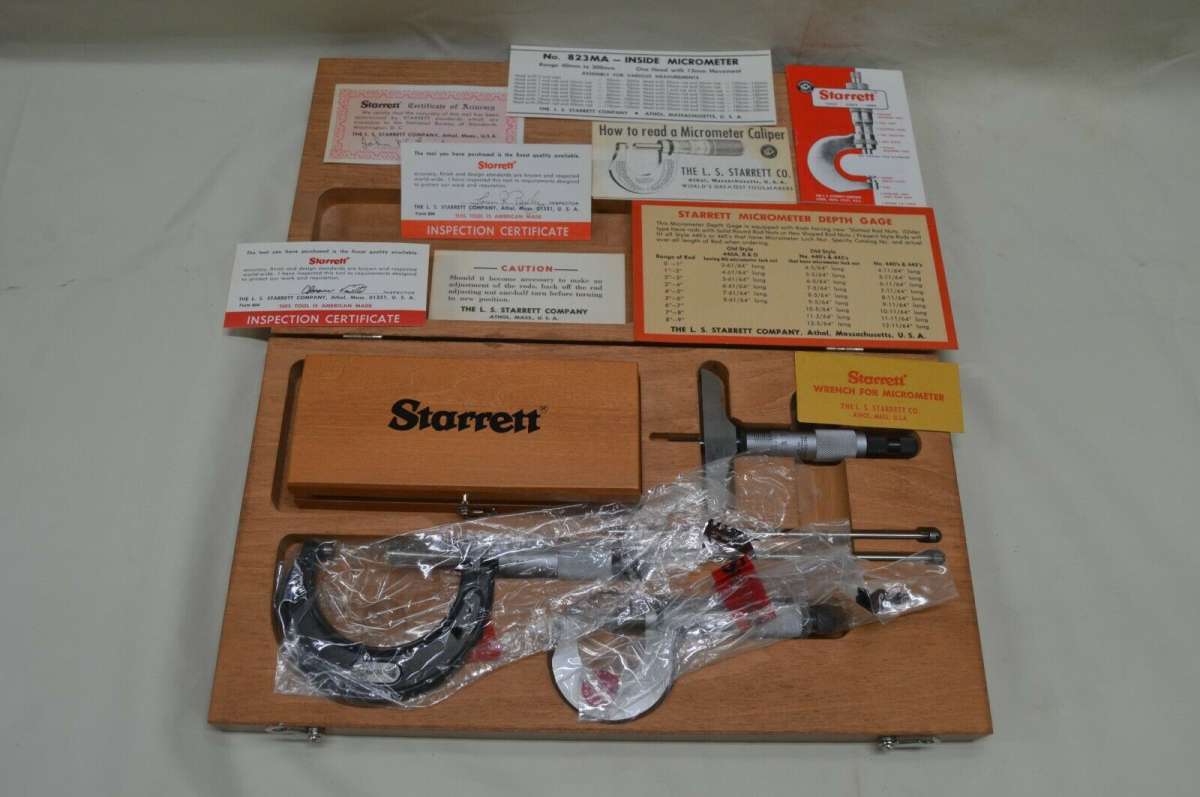

      I posted these photos of a Starrett 906M micrometer set, this set is still in the Starrett red cardboard box so hasn’t been discoloured by dirt and grime, I need to take a photo of the top of the box and post it.
      Starrett 906M a
      Starrett 906M b
      Clive asked what the wood is and to tell the truth with my lack of knowledge about different woods I have to say I do not know.
      Like Clive, I also have many original Starrett carboard boxes and I would like to replace these with wood boxes also. and put the cardboard boxes away for safe keeping as the carboard box starts to rip and degrade if used quite often.

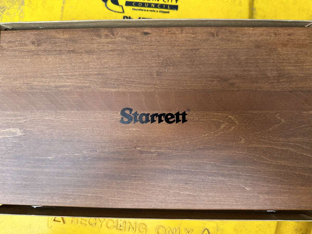

      It seems Starrett has used many types of wood for it’s precision instrument boxes over the years, red/white oak, birch, I think pine and some woods I think were stained to look like other more expensive woods.
      Looking at picture of the latest boxes I think they may be either plywood, laminated mdf or just coloured mdf, not the sort of box I would buy.

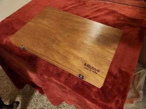

      There are many fine tool makes have used wood boxes, and probably different woods also, I have many Mitutoyo boxes, including some early ones with the sliding top lid, but most Mitutoyo boxes are made of Mahogony, what other woods have manufacturers used?

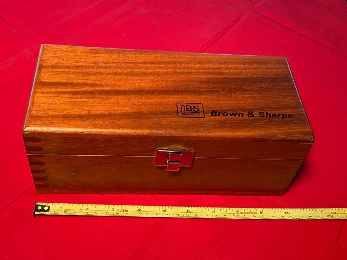

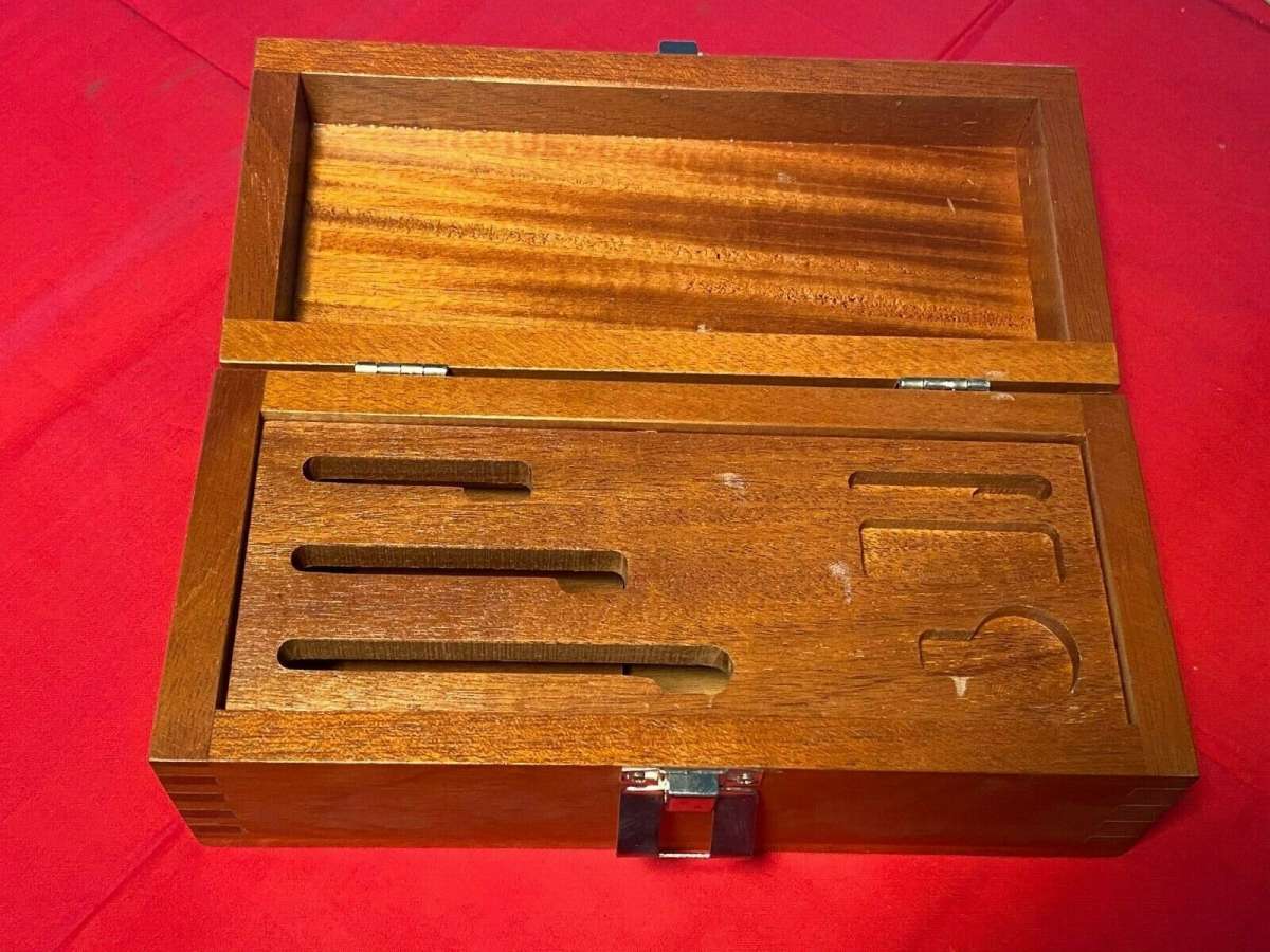

      Brown & Sharpe case a
      Brown & Sharpe case

      Mitutoyo case 1
      Hopefully we can get some valuable input from the members here

        Starret looks like beech
        B&S Sapele

              I wouldn’t know where to begin with the Mitutoyo box – except it looks like a hardwood – do they grow Zelkova commercially in Asia?

                  Zelkova serrata is grown commercially for timber. The Japanese are huge consumers of quality hardwoods and I know that Z serrata (Japanese Elm?) is prized for furniture and interior decor.

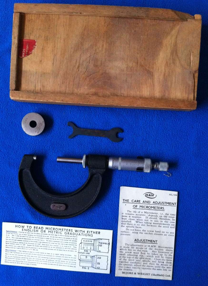

                      Another person said the B&S box is Honduras Mahogony.
                      I’m picking Moore & Wright used some cheap wood for their boxes and micrometer stands, which is why they painted them the black/silver finish.
                      I would like to refinish/restore a couple of Moore & Wright items, a micrometer stand 0-6″ being one.
                      So knowing how they achieved that black/silver finish would be great.

                                  My Mitutoyo 12″/300mm digital heavy duty caliper is in a wooden box that looks like cedar to me. A good choice because of it’s natural oil content.

                                      The M&W box is the box the 1-2″ micrometer, standard, spanner and paperwork came in and I have seen M&W micrometers for sale in the same style of boxes.
                                      The red label on the lid has the words “thread” “scre” pity the rest of it wasn’t present.

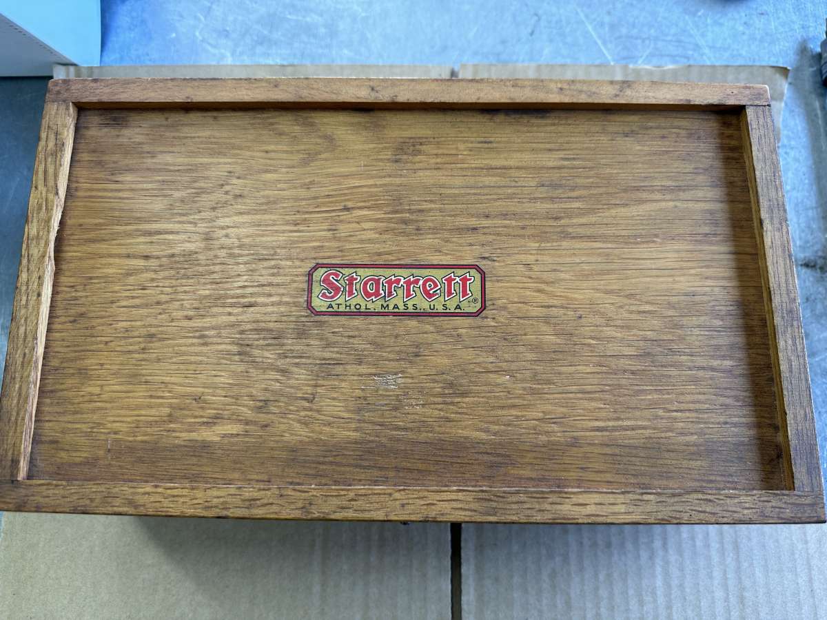

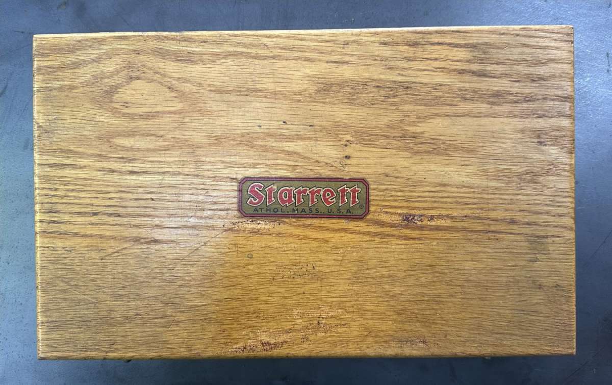

                                      Here is another Starrett box
                                      IMG_8530a
                                      IMG_8531a
                                      IMG_8532a

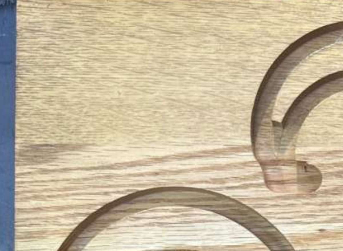

                                      This is a solid wood box of unknown vintage, what do you think this wood is?
                                      #806236
                                      Mark Easingwood
                                        @markeasingwood33578

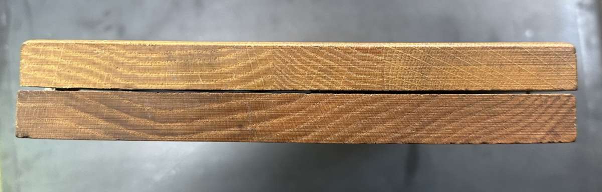

                                        Screenshot 2025-07-07 095405
                                        Oak, can’t tell which type of Oak tho’
                                        Mark.
                                          Mark.

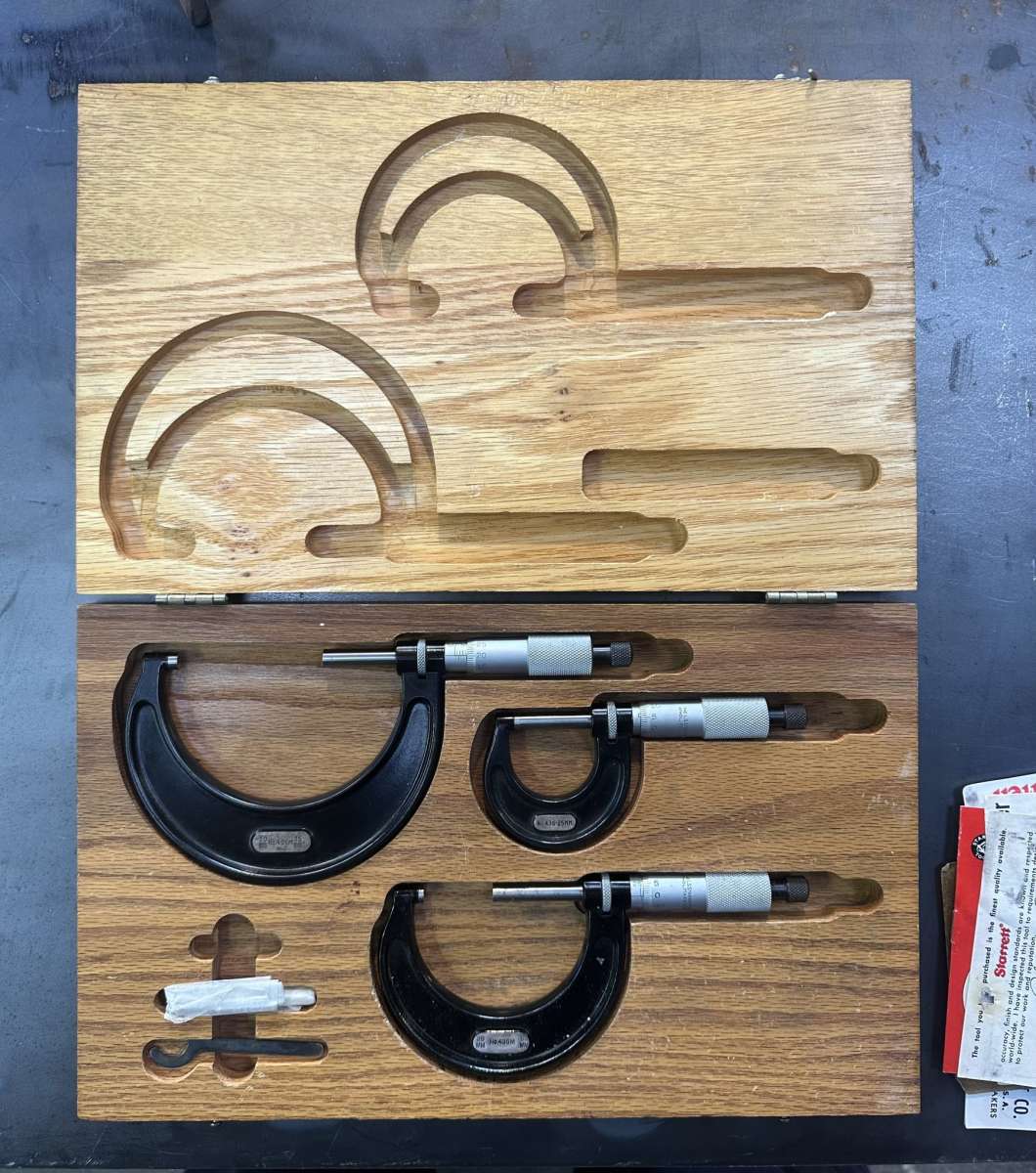

                                          Thanks Mark for the confirmation, I’m told it’s possibly red oak.
                                          I have attached some better pics of the wood used in the 906M set
                                          IMG_5290
                                          IMG_5295
                                          IMG_5296
                                          Here is a Starrett 665 set once again from an era when Oak was used
                                          IMG_5284
                                          IMG_5286
                                          The Oak cases maybe from an earlier time period as they have the stick on Starrett naming, where the 906M set has Starrett stenciled directly onto the wood
