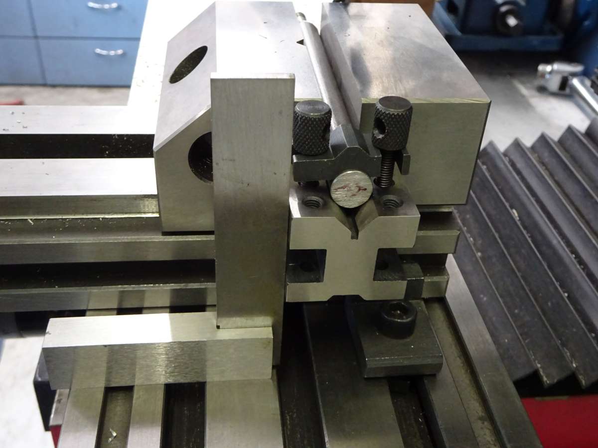

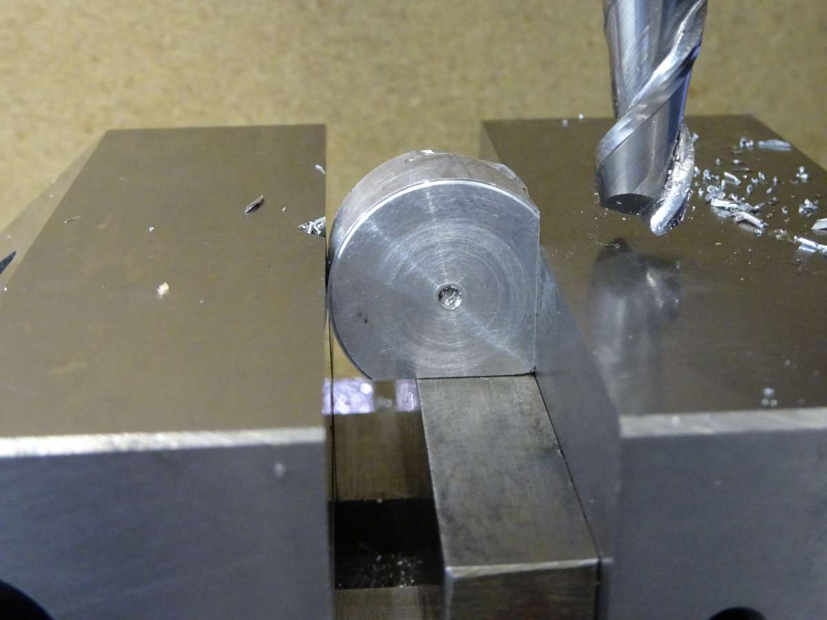

          All the above plus these if you don’t have the items.
          If the overall length is not too great then just hold vertically, locate ctr and mill the 4 sides. A stop will allow you to do multiples. Backlash and compensating for it does become an issue if you don’t have a DRO.
          If there is plenty of length then simply clamping something square to the far end and using a square up against that will index your 4 sides.
          Photo 147
          Or just use the rear of the vice jaw to index 3 faces after milling the first.
          Photo 146

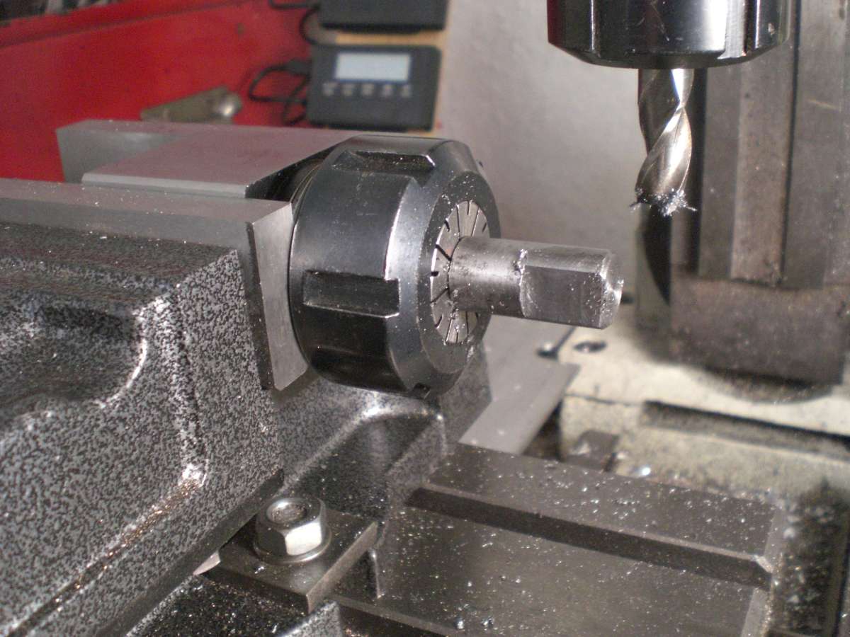

                    Hi, a Stevensons square collet block is an easy way of doing it. Just nip in a collet and hold the block in a vice, with the nut against the vice sides, mill each flat in turn, making sure the nut is against the vice each time, and there is no need to alter the quill, once you have it set for the depth.
                    CIMG2799
                    Regards Nick.

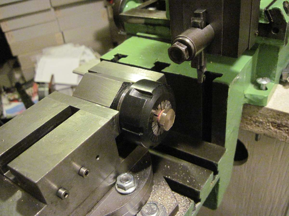

                        I do have a pair of er25 collet blocks which will hold up to 16mm diameter, but as the rotary table is normally sitting on the Tom Senior, that is more likely to get used. We also have er40 which has collets up to 30mm, and must find out whether collet blocks are made in that size. As members respond, even more clever ways of getting the job done are coming to light.

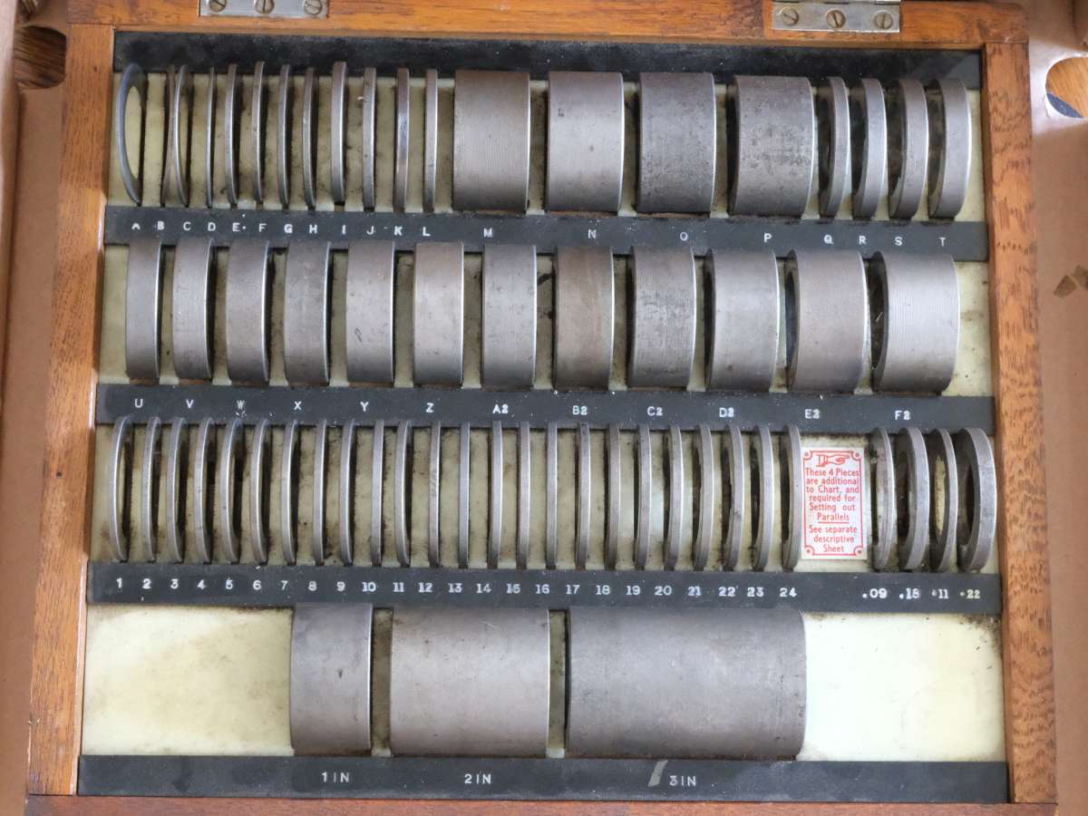

                              Just to add to the implausible and over the top methods fit two side and face cutters to your 1 1/4 arbor with 4mm of spacers between them and set up in your horizontal mill. Cutting two flats at once at precisely 180 degrees will speed the job. Run the job at night on cheap rate electricity so the load of the 5HP motor doesn’t add too much to the bill.
                                          Sets of precision spacers for horizontal mills are rare; finding a metric set for an imperial arbor is probably impossible. I have recently acquired a set for a 1-1/4″ arbor, but of course they are imperial:
                                          Precision Collar Spacer Set
                                          No need to run the mill at night, a 5hp motor won’t even notice the cut.

                                                    Thanks, Nick, that will help finding different sizes of collet. As it happens, I had looked on ebay just after posting here and found a French seller with a pair of er40’s for £42 including postage and went for them. I now have everything er40, from MT3 holders,R8 holders and a 100mm dia plate which can fit the 1 3/4 X 8W and 1 1/2 X 8UN backplates of both lathes and collets from 3-30mm. I blame another volunteer, Roger who gave us the MT3/er40 and some collets for starting the ball rolling. Up till then, we had been happy with er25 size.
                                                    Just in case somebody does not know, if you put work in the very end of some types of vise, a similar thickness piece should be fitted in the opposite end of the jaws otherwise the moving jaw can rotate slightly. Jaws out of parallel do not hold work properly.
