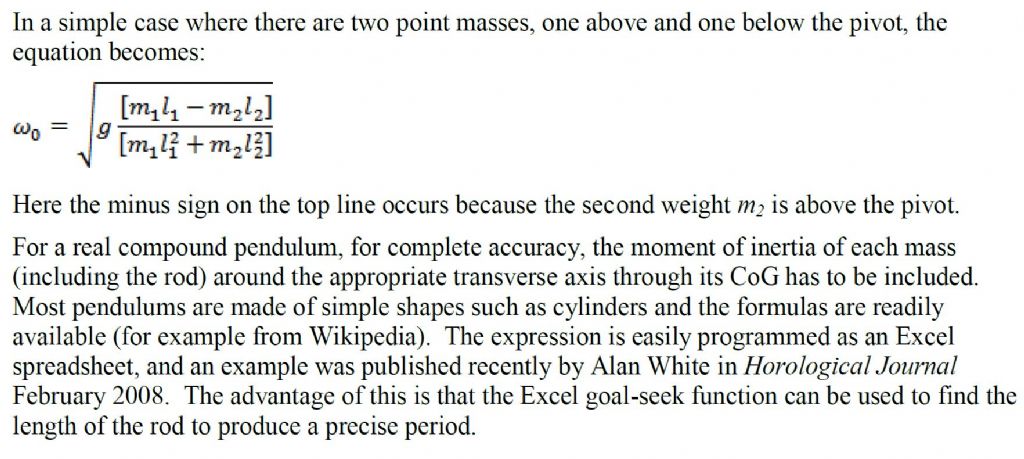

      Here's a simple formula that works for light rods and compact weights. Taken from an article I wrote in 2008 for Horological Science News.
      Hope this helps.

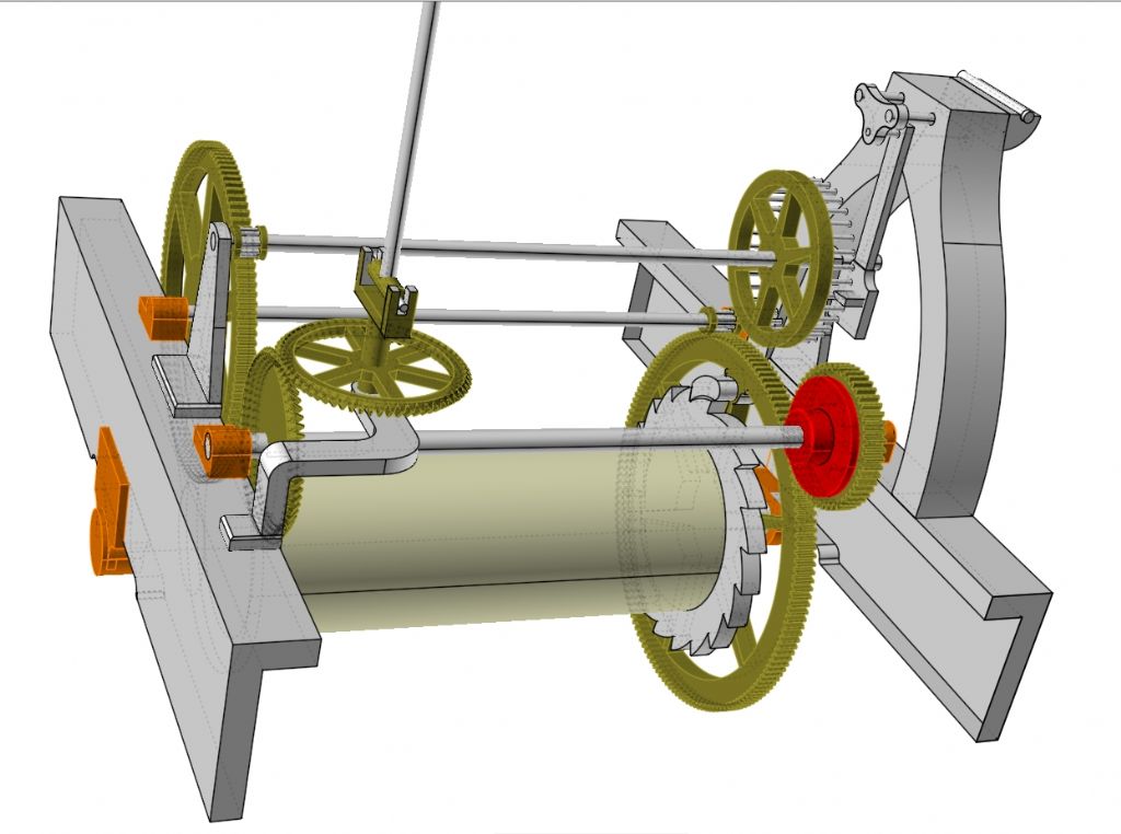

              In case anyone is interested!. It has been a bit cold in the workshop for progress on the "other projects", so I have amused myself by developing the design for the church clock model. Rather than the original idea of having the chime triggered twice (rather than the four times of the original), I did some spread sheeting to develop an alternative time train that gives a once per hour minute shaft, and for which the wheels are fairly close to scale – I chose 6mm = 1" as I prefer to work in metric, but the clock is clearly imperial dimensions. So far only the time train is close to a finished design, the chime & strike trains will be closer to the original as the gear ratios can be retained.
              The model so far is
              Time Train
                                       Church Clock Model
              Great wheel Teeth 120             150
              Rotates Every      3 Hours     3 Hours
              Ratchet Teeth         20                 20
              1st Pinion Pins       10                   8
              2nd Wheel Teeth     90               116
              Rotates Every min  15                   9.60
              2nd Pinion Pins         8                  8
              Escape Wheel Pins 35                35
              Rotates Seconds     80                39.7
              Pendulum Period secs 2.29         1.13
              BPH                       3150             6343
              Minute Wheel Teeth 40                 50
              Rotates            Once per hour Once per hour
              Bevel Gear Teeth    76                   60
              Dimensions 1" = 6mm
                                            inches          mm       Scale
              Great Wheel           11.75           76        1.08
              2nd Wheel                8.5             59         1.16
              Escape Wheel          5.5             32         0.97
              Minute Wheel           4.0              26         1.08
              Bevel Gears             7.5              28          0.62
              Drum                        6.0              36          1.00
              Pendulum Length   51.20          320          1.04
              Using MOD 0.5 for the gears, the second wheel is a fair bit (16%) bigger than scale which required the escape arbour to move to one side, at which point it clashed with the minute arbour drive wheel, so the bearing mounts needed lengthening to raise it up to maintain depthing. The output bevel gears also needed to be made a bit smaller to avoid a clash with the second wheel, but otherwise things are fairly close to scale.
              The escape wheel teeth on the original are flattened and about 1/8" thick. To scale they look rather fragile at 0.75mm, so I have used 1mm pins and modified the pallet spacings to suit (I hope!). The plan is to make the arbours from silver steel and harden the pivots. All bearings are brass. Several parts (the frame, the escape arbour, bevel wheel bearing supports and the pendulum support are clearly cast iron. They will be fabricated from steel ( silver soldering is a skill I will need to acquire). The winding ratchet also looks to be cast and that together with the similar parts for chime and strike, plus the strike cam have some complex curves that I will need to work out how to make. I might see if I can find a local laser cutting organisation willing to make small one-off parts for a reasonable cost (unless anyone has a cheap desktop laser cutter capable of cutting 4mm steel plate going spare).
              As always, comments and suggestions gratefully received.

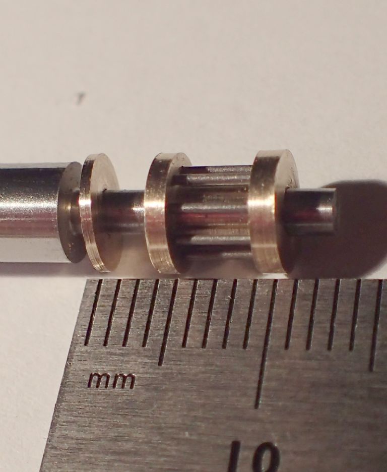

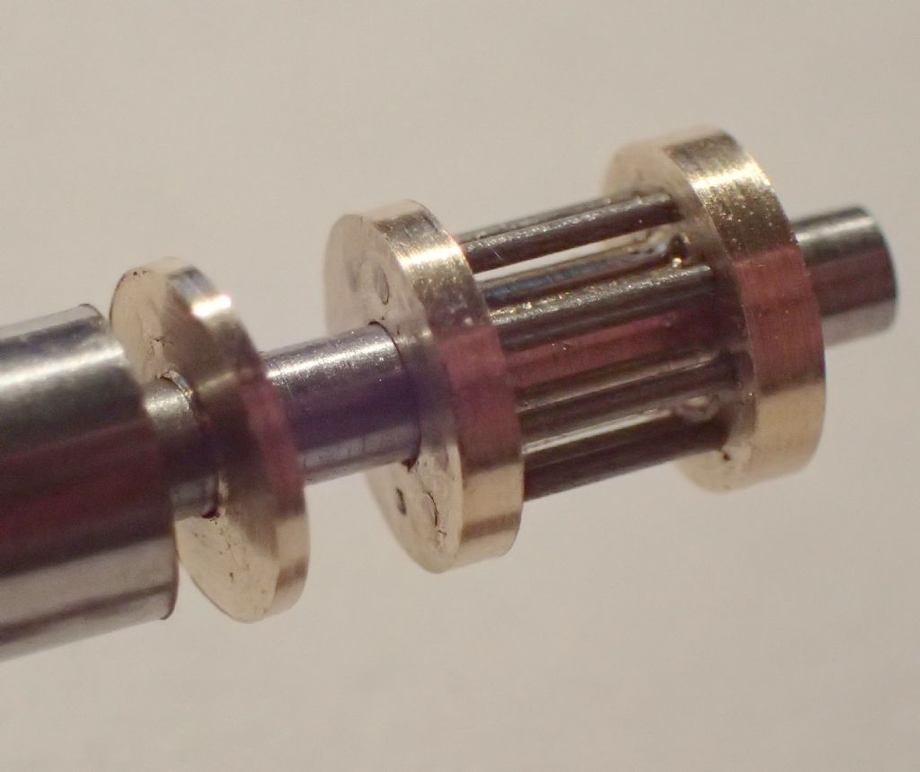

                    The project has made its first swarf. Having decided on Mod 0.5 for the wheels of the time train, before ordering lots of material, I thought I should experiment and see if I could make a Mod 0.5 8 tooth lantern pinion. 6mm diameter, 4mm width (for a 3mm wheel) and using 0.51mm piano wire (nearest to Mod * 1.05 as per Wilding I could get). Included a cap to cover the end. Currently loose on a dummy arbour.
                    Worked well. Finish needs work, and the wire for the real ones will need polishing. But a win. Now I need to find out if it will run against a Mod 0.5 wheel.

                      You should (and perhaps have) realised that one of the advantages of a flat frame is the ability to have adjustable bearing bushes so that engagements can be set on the clock without depthing. The design should take allowance of this so that the clock can be set up from barrel to escapement as you go so that moving one bush doesn't throw three other clearences out.
                      regards Marin

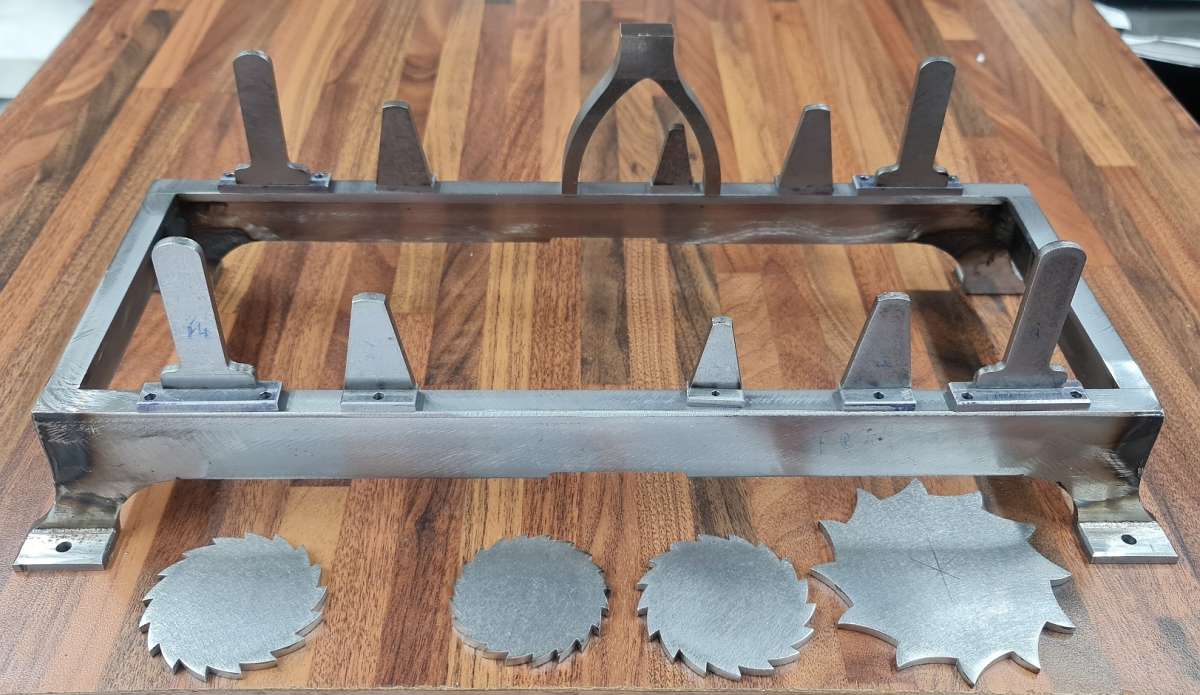

                        An end of year update on progress. The frame and the pylons which hold the wheels and levers are finally made. They still need brass bearings added and fixing to the frame but that will happen once (if ever) the wheels have been cut and  depthed as they are fitted.
                        Frame and parts
                        The pylon uprights and the ratchets were laser cut by a local firm in 4mm steel plate. The bases for the pylons were machined from an off-cut of the angle used to form the frame. Joined with 2mm roll pins and JBweld.
                        At last I feel I am actually making progress. Next year’s resolution is to take my round tuit in both hands and start wheel cutting!!
                        #772270
                        Martin Kyte
                          @martinkyte99762
                          Would you consider pinion steel for your lantern pinion instead of piano wire. It’s semi hard and smooth.
                          #772278
                          Peter Cook 6
                            @petercook6
                            Probably Martin, I have some pinion wire on stock, so I will see what I have when the time comes. At the time I only had the piano wire in the size I needed, and as it was a test piece the material was less important than the machining practice.

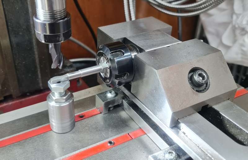

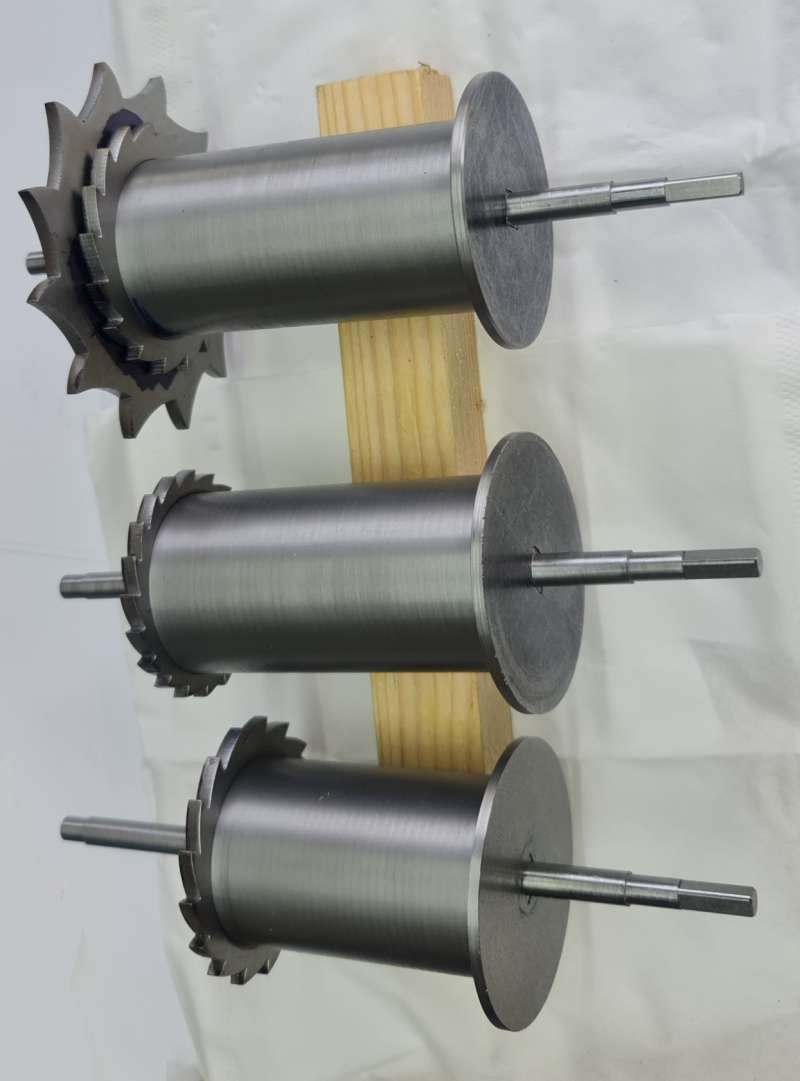

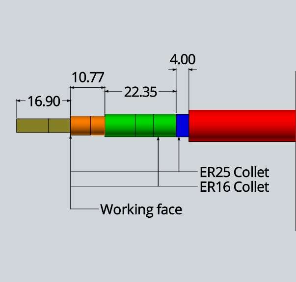

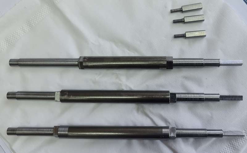

                              A progress report, and a win over incompetence – I think.
                              I have been working on the three winding barrels and their associated arbours. Making the arbours was fairly straightforward, as was milling the squares on which the ratchet wheels and barrel ends fit.
                              Arbours
                              However adding the winding squares to the end has been a nightmare. Probably a combination of lack of rigidity in the mill I have, way too much overhang for such thin parts even with a machinists jack, plus a good degree of incompetence on the part of the handle turner meant that in five attempts I singularly failed to get three winding squares even close to the same sizes. I could get them square, but not the same sizes.
                              Milling Winding Squares Small
                              So this week I gave in, and ordered a bit of square key steel the size I wanted for the squares and made the three winding squares in the top picture, with M3 threads. After cutting off my poor workmanship, drilling and tapping the ends of the arbours the squares screwed in beautifully. The only complexity was that the clock winds anticlockwise, so I needed to acquire left hand tap and die to cut the threads. But online is wonderful.
                              So now I have three winding barrels ready to go. Strike at the top, time in the centre and chime at the bottom.
                              Barrels
                              Next step is to take my round tuit in both hands and start cutting gears!!

                                  Why did you have so much overhang. Put the shaft in from the rear of the collet block on the smaller dia.
                                  #801831
                                  Peter Cook 6
                                    @petercook6
                                    Bernard,
                                    Green is 7mm diameter, Orange 6mm, Blue is 7mm square(so 10mm across diagonal) and Red is 10mm diameter.
                                    Winding Square
                                    Collet block is ER25. Collets are 34 mm long, so inserted from the back into a 7mm diameter collet, the blue square fouls the back of the collet while the point I need to mill to is still inside the front. I would also have had to pack out the 6mm section so that the collet closed properly. ER16 collets would have worked with appropriate packing, but I don’t have an ER16 block.
                                    Moving the part back in a 10mm ER25 collet would have needed some two diameter packing to support the front of the collet on closure, which with hindsight I possibly could have made.
                                    The other, with hindsight, options would have been to mill the winding squares first, or change the design slightly to make the 6mm section a bit longer. But you learn as you go along..
                                    #801840
                                    bernard towers
                                      @bernardtowers37738
                                      Good luck with the ER16 collet block, I ended up making my own and very handy they are too.
