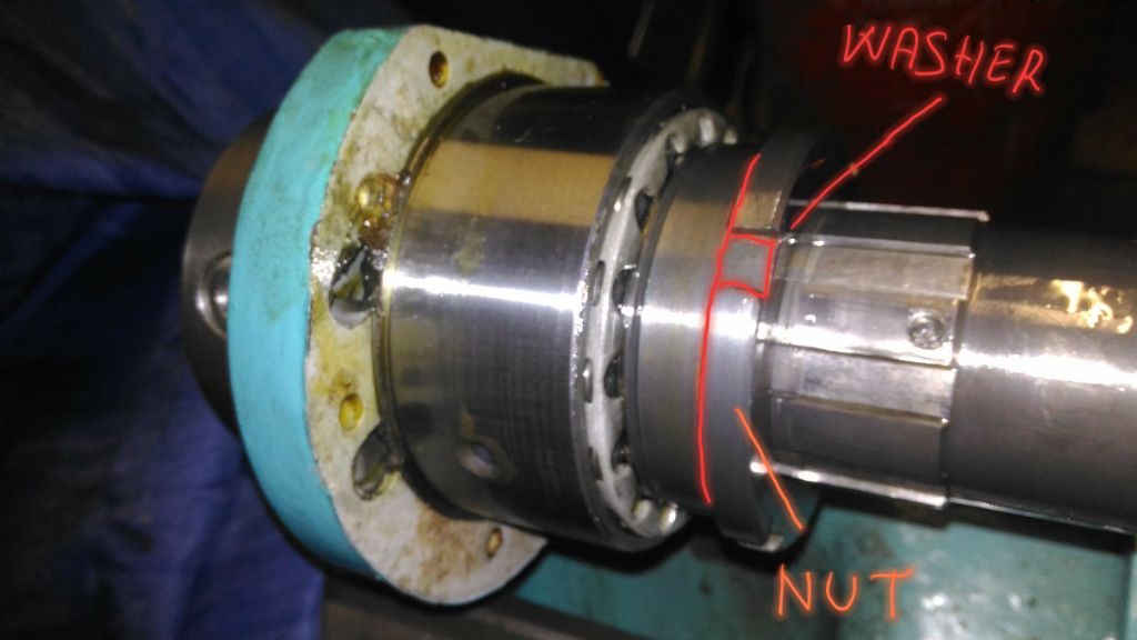

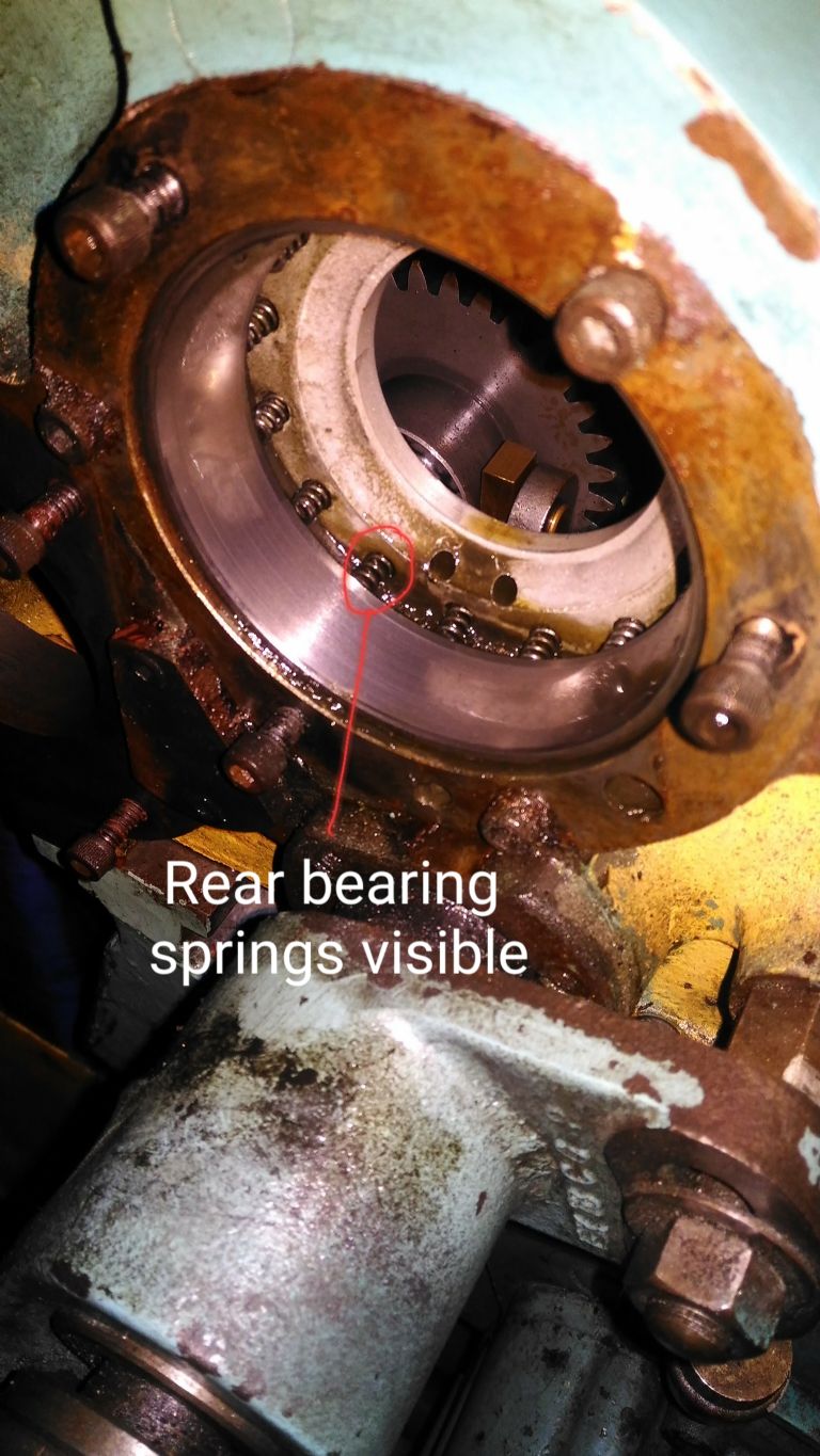

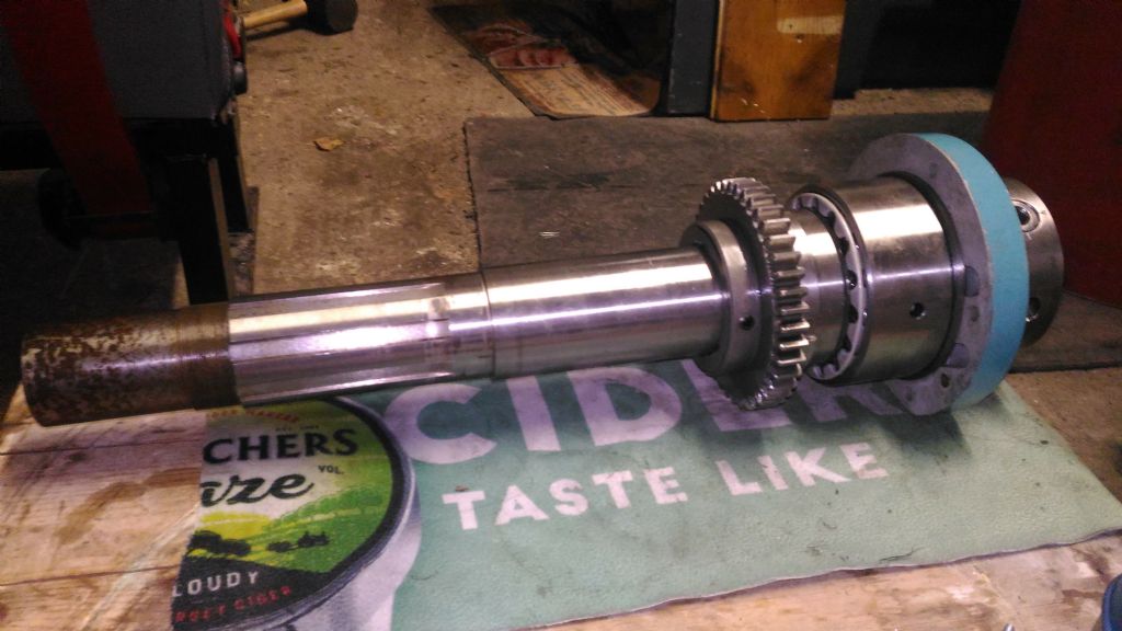

                                              Hi all and Gunnar!
                                              Don't know if you are still stuck with the loose bearing on the Chippie(hope not), but here you go. Maybe someone else will make use of this info.
                                              A few years ago I disassembled the headstock of my Chippie. And yes the front and rear bearings on the main spindle are adjustable. They are double taper pin and taper shell bearings. These can be adjusted by tightening a nut that holds it to the end of the spindle(in case of the front bearing), and in between two nuts on the rear, if I recall correctly. The only thing you haven't seen is that there is a washer that has a longer protrusion that is bent into one of the groves of the nut. This impedes the nut loosening. If you haven't observed this and adjusted the nut, you probably bent the locking washer's protrusion and might be the cause you struggled with it.
                                              Although adjustable, the real axial play is taken out by the 24 small springs that push the bearing shell onto the taper pins. If these fell out, you might need to take all the guts out of the headstock to remove the spindle and put the springs back. It's a few days of work if you have a day job but all fun. I was not in a hurry so it took me two weeks as I was ordering seals, bolts, oil paper and popcorn.
