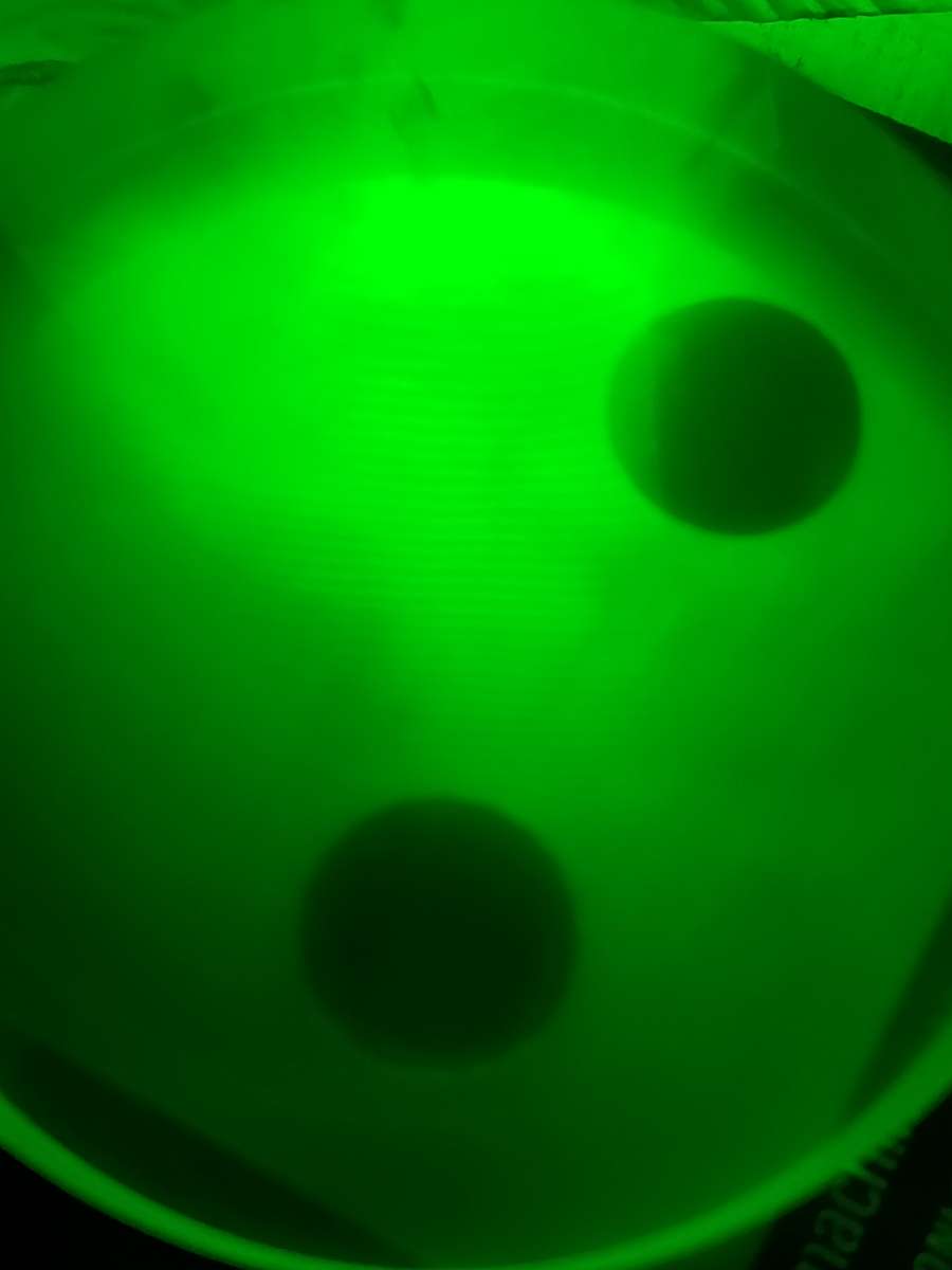

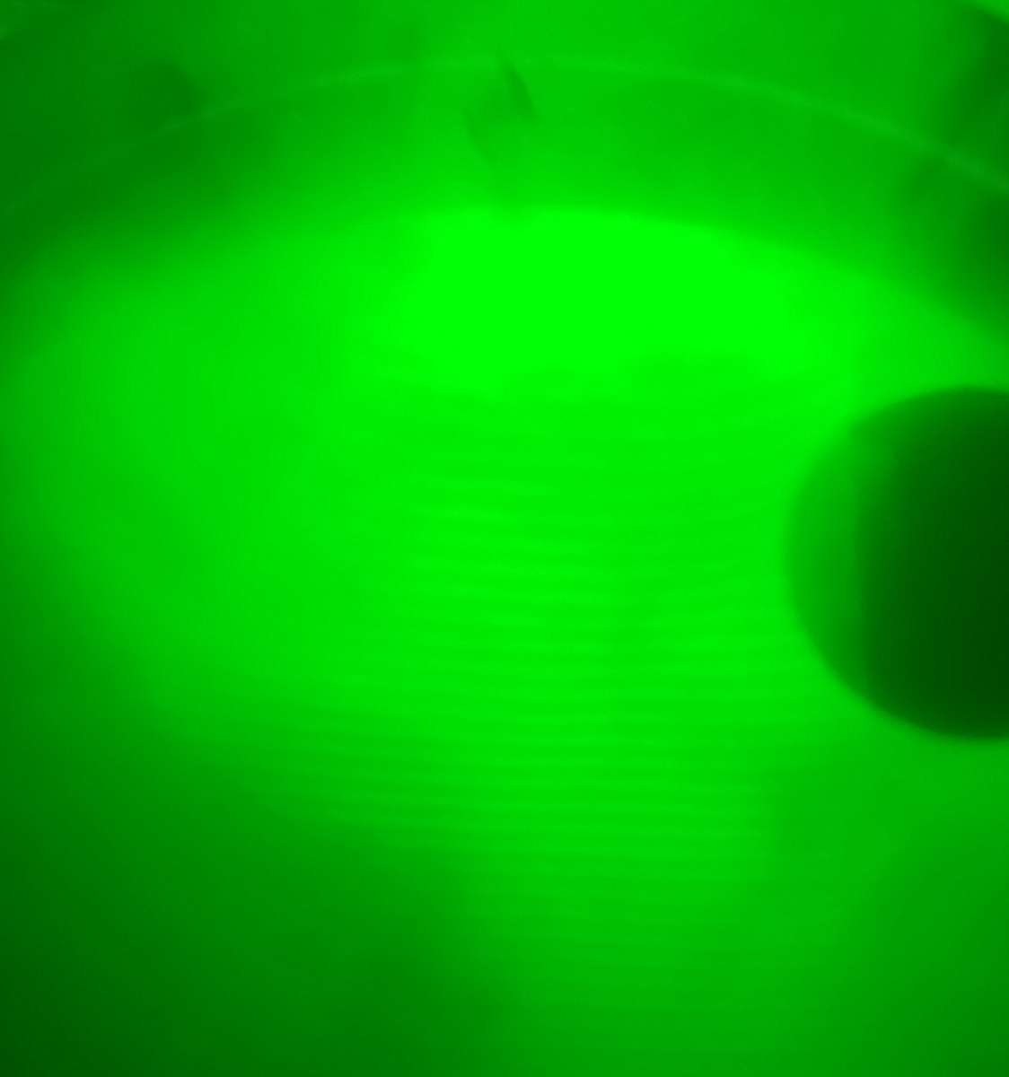

                To finish off the story…
                Today I got a polish on both sides of the ‘flat’ good enough to get interference lines on the end of a gauge block. I can’t get it to work over a large surface- but I have some polishing to go. I estimate it’s within about 150 nanometers per centimeter or a radius greater than 40 meters. So rubbish in terms of optical flat but flippin amazing for me, a plonker, and so much better than I ever hoped! And I have three good laps, proper optical pitch, a huge selection of lapping abrasives, and quite a bit less in my bank account.
                #717753
                jaCK Hobson
                  @jackhobson50760
                  Other people might not see em… but I see fringes!
                  IMG_20240303_174516IMG20240303161026
                  #717775
                    I see fringes too
                    … Well done, you !
