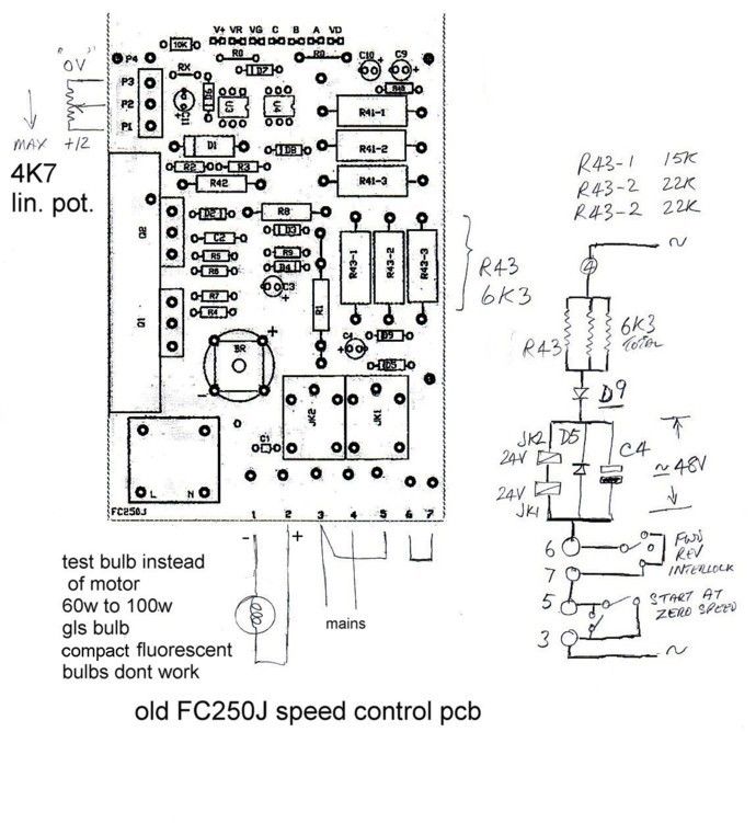

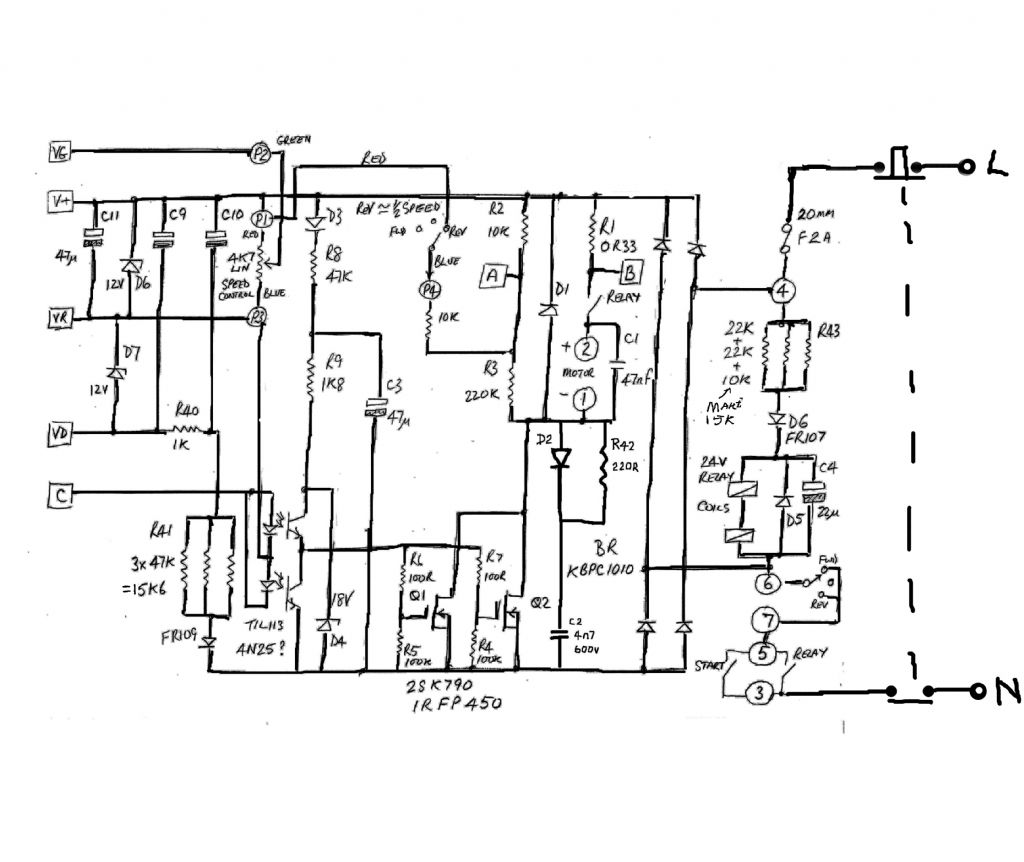

            #50503
            john swift 1
              @johnswift1
              hi anthony
                                     i am working on a 10 year old board now
                  tracing the circuit  it looks like it was designed for europe and not the uk !
              one of the faults was due to over volts on C4   ,i have increased R41c 15k (was 10k)
              the circuit is a work in progress   ( daughter board to follow then i can workout what the pots do !!!   )
              the last op amp on the daughter drives terminal C
              pwm +12v to – 12v  via 4.7k resistor
              you could use a 100W bulb as a dummy load in place of the motor
              just incase the motor is faulty

                #50533
                Sub Mandrel
                  @submandrel
                  Thanks John,
                  Only three posts and you’ve already earnt the thanks of a host of mini lathe users, present and future
                  #50647
                  john swift 1
                    @johnswift1
                    update to my FC250 circuit
                     i’ll rewire the fuseholder to the (new) live  terminal 3 and make terminal 4 the neutral
                    (having switches and /or fuses in the neutral are not a good thing to do )
                     very soon i will have a working lathe
                    the last time i used a lathe and ground my own lathe tools was 28 years ago
                    it may take a little practice to get the parting off tool right again !!

                          #51595
                          john swift 1
                            @johnswift1
                            hi Tony
                                        the stw20nk50z has the same pin out as the original irfp450 and 2sk790 fets used on
                            the speed control
                            if cleaning and inspecting the motor has not cleared a fault  ??
                            the next thing to check is c1 (47nf) connected  across motor terminals 1 & 2 or dc1 & dc2 on
                            later boards
                            you can test the board with a 100w gls bulb in live supply to limit any fault current
                            a short circuit motor or capacitor (c1) will not destroy the fets , the bulb will flash on and off instead
                            a 15w bulb in place  of the motor will prove you can control the output
                            i have tested using a 60w bulb in place of the motor but you only have control over the first 1/4 turn of the speed control before the 100w bulb in the supply limits the current !
                            i very often use 100w bulbs when working on switch mode power supplies
                            the first time was to setup the power suppy in a tv , not wanting to damage any thing else or be x-rayed !

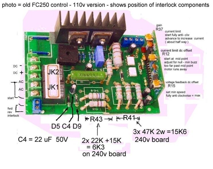

                            #51596
                            john swift 1
                              @johnswift1
                              hi Tony
                                          you might need to check diode d1 is not short circuited , its the largest diode on the board
                               good luck
                                                 john
                              #51712
                              Anthony Knights
                                @anthonyknights16741
                                Hi John
                                               have already found D1 to be short circuit. Somewhat ironic that when functioning it is there to protect the mosfets. I now need to search my “bits box” to find a suitable replacement. I still have a new pair of mosfets, so I live in hope
                                Thanks for the tip about using a dummy load.
                                 Regards  Tony
                                #51816
                                john swift 1
                                  @johnswift1
                                  hi tony
                                               the diode on my board  is a FR307   =   3A 1000V  fast recovery diode,
                                  you could use a UF5408 instead , a faster version of the 1N5408 you may have in your spares box
                                  instore or poundland type of shops are still selling 40 to 100 watt gls bulbs
                                  15w pigmy bulbs can be found in  the supermarkets –  bought one yesterday from tesco
                                  I now have confirmed with a 100w bulb in series with the  live supply , a 15w bulb instead of the motor and a spare 5K linear potentiometer
                                   you can check  that you  have full control of the dc output on your spare  board
                                  without disconnecting anything on your lathe
                                  the lucar connectors used are made of thinner than normal brass strip
                                  resulting in a poor connection once  you have unplug them a few times
                                                       Regards   John

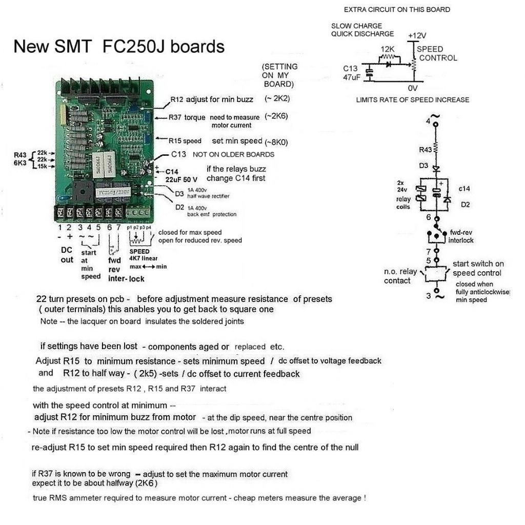

                                      john swift 1
                                        @johnswift1
                                        Hi Richard ,
                                                         What control pcb  do you  have
                                        the old type with the ICs on a small pcb or the new type with surface mount components all on one board ??
                                         first disconnect the motor to prove the noise is comming from the relays
                                        If that is the case , measure R43 is 6K3 ( 2x 22K +15K in parallel  on 240v pcb)
                                        C4 (old pcb) / C14 ( new smt pcb) may measure as 22 uF( 50v)
                                         but the ESR may well be too high .
                                        on my board it was 7 ohms instead of less than 0.5 ohms.
                                        if the noise is from the motor
                                        first check the brushes are OK  – new ones are about 14 mm long
                                        and all connections are good i’ve found the lucar type of connectors used
                                        are a poor quality
                                        to prove the pcb is ok , use a gls bulb as a dummy load instead of the motor
                                        and check you have control with no erratic bursts of power
                                        If you think the board need ajdusting let me know what board you have and
                                        I’ll let you know how I set up my board

                                                  #54239
                                                  john swift 1
                                                    @johnswift1
                                                    Hi Rchard ,
                                                                       If you need to change the 22uF capacitor (C14)
                                                    maplin have a high temperature capacitor  cat number DT57M that will fit
                                                    hope the notes make sence
                                                    check the connections
                                                    lucar type connectors are not just held by the covers
                                                    a poor connection from P1 to P4 via the forward / reverse switch can give you rapid changes in speed.
                                                    #54268
                                                    Richard Edmonds
                                                      @richardedmonds33836
                                                      Right thanks John and Les, I got the thing out today and it is the relays that are causing the buzzing although I am not sure that was the reason for the erratic speed control. So I am now off to Maplin to get a few capacitors and try that first. The board is very much the same as Johns picture but is and SMD 250 AS opposed to SMT 250 so I do not know if it will make any difference. However the capacitor seems esay enough to change so will do that first. Will let you know when I ###### the whole thing up. Thanks guys and watchn this space
                                                      Regards
                                                      Richard
