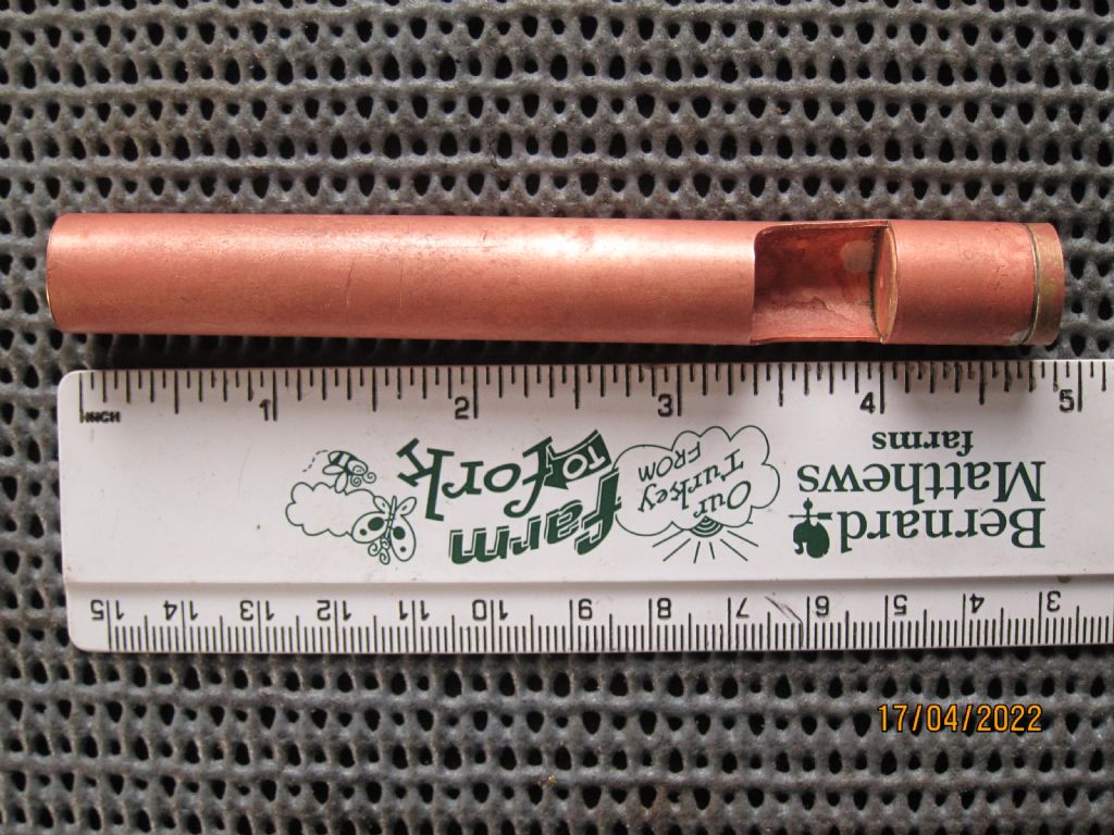

                                    Hi – I am not having much luck making up a whistle from 15mm o/d copper tubing, the last attempt being ruined during the final brazing process which has made me query the need to use silver solder with its attendant risks of distortion which is what has just happen with me. Given that it will be a steam operated whistle is it essential to use silver solder for this operation or are there other methods of available? All suggestions most welcomed.

                                        I think that copper would absorb much of the "chime" from the whistle. As for silver solder, use the smallest diameter rod possible – you only need a smidge of solder.
                                        #594892
                                        bernard towers
                                          @bernardtowers37738
                                          I don't really understand about the distortion being blamed on the silver solder, I do quite a bit of silver soldering and have not come across this. Your choice of material may be part of your problem as straight after soldering it would be fully annealed and given the gauge and the cut out I would imagine it would be prone to be easily damaged.

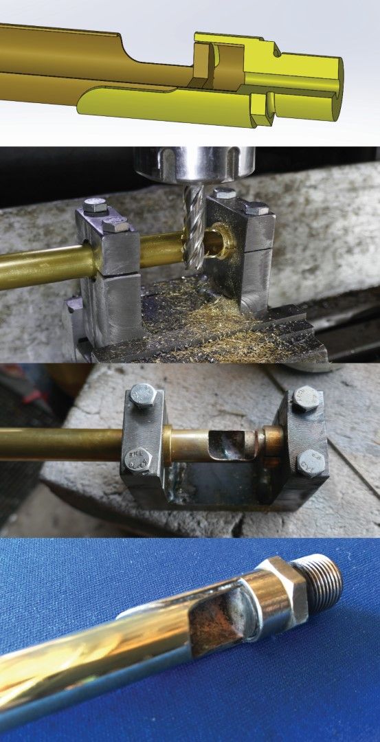

                                          Paul Lousick
                                            @paullousick59116
                                            My whistle material is brass and are made by mounting the tube in a jig and milling the cut-out. (copper is too soft and will not "ring" like hard brass). Then silver soldering a disc into the tube using 45% silver solder which comes in 1.5mm dia sticks and seems to flow better than the normal plummers grade. The whistle base is soft soldered (the contact area is large and melts at a lower temperature).  The cut-out extends below the disk to prevent the silver solder running all of the way around and closing off the gap for steam flow.  The base extension supports the tube and compensates for the whistle mouth cut-out.

                                              Paul – I have noted you method of manufacture and have ordered up some 19/32 dia brass tube for the next attempt. Any thoughts on using Comsol high temperature soft solder as a possible alternative to silver soldering the disc in place?
                                              #595007
                                              Clive Brown 1
                                                @clivebrown1
                                                I can't imagine ordinary soft solder being inadequate for a whistle fed via pipe from a model boiler. As for copper being too soft to give a good note, silver-soldered brass will be little different after silver soldering. In any event, a human mouth can produce a fairly piercing note despite being made of rather soft material.smiley
                                                Also, a chime note is produced by a whistle with two or more resonant chambers, not by the material of construction.

                                                  I only used hard and soft solders in my whistle construction because of the different melting temperatures and did not want to re-melt the disk when I soldered the base.
                                                  Whistles can be made from many materials. eg. Children's wooden whistles make a loud but dull sound and do not have the timbre of one made from thin brass.

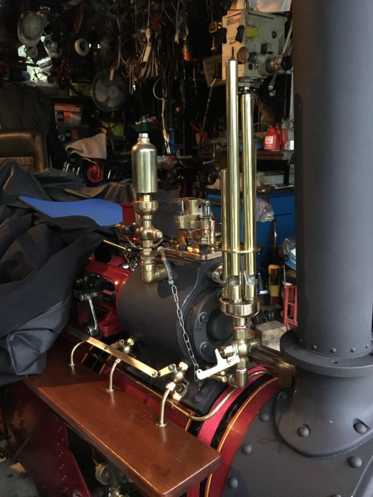

                                                  It is difficult to get a good, deep sound from a model whistle. Sound cannot be scaled down. The pitch of the sound is dependent on the length of the whistle and the volume is dependent on its diameter. The height of the mouth cut-out is dependent on the steam pressure for the whistle to resonate properly.
                                                  My whistle has a sweet spot and sounds good at 70-80 psi but wheezes when the pressure is greater. (not sure if I should enlarge the mouth opening. Easy to make larger but not to make smaller if not needed).
                                                  My other problem is that I get condensation in the supply fittings to the whistle and have to purge it before I get a clear sound.
                                                  Youtube video of my whistles: **LINK**
                                                  The 5-chime whistle has 12mm and 16mm dia tubes of fixed length and the Lunkenheimer has a 38mm bell which is height adjustable and can be tuned to the steam supply.
