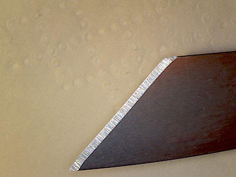

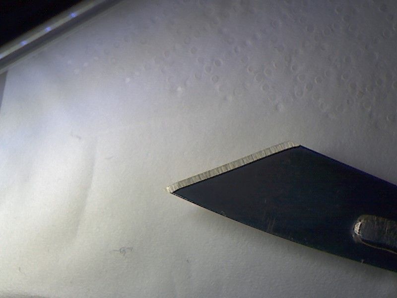

                            Microtome knifeMicrotome knifeMicrotome knifeScalpel bladeHi Robin,
                            I attach some photos that I took this morning. I was using a cheap USB digital microscope from Celestron. The magnification range is 10X to 150X and the photos are of lowly resolution. I attach it to my computer and use the basic windows camera app. The microscope came with software that was more sophisticated and I believe that there is good software on the internet. The windows version is good for my purposes.
                            The pictures are low and higher power images. One is a new Swan Morton scalpel blade and the other the cutting edge of a microtome knife used to cut thin slices of tissue embedded in paraffin wax for microscopy. It is clear that the polishing of the cutting facet of the microtome knife is superior to the scalpel blade. I do not know if you require this level of “sharpness”.
                            In general terms the Celestron suites my purposes in the workshop. I would be wary of cheap devices offering enormous magnifications. High magnifications and good resolution cost a lot of money. I do have “proper” microscopes and use them often, but when it comes to a quick look at the finish on something from my lathe or milling machine the Celestron comes out. It is sufficient, quick to set up and use. With all microscopy, and photography, lighting is the key to good images and needs to be done properly. If I do have a gripe with the Celestron it is the ring of LSD’s around the lens. OK for most purposes but need supplementary side lighting on shiny metal.
                            Now and again,Scalpel blade I think about replacing it with something giving higher resolution, but it needs a lot of research.

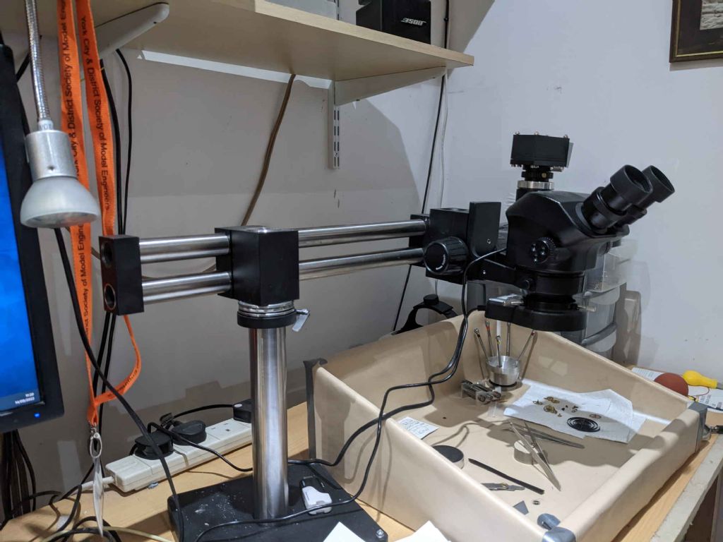

                                I have a cheap USB microscope which has variable magnification, but it's built to a price. It's hard to change the zoom and focus without seriously moving the image.
                                I've also got a trinocular microscope from AliExpress which cost a little over £200 (£220 if I have it right).
                                For reference it's here but there are many more there with similar
                                I got this for use with watches and I have been happy with it so far. I picked a *.5 bowler lens which increased the objective distance from 4 inches to 8 inches to allow me to get my hands and tools into the watch. It also reduce the top magnification from 100 to 50. YOu can go the other way and put A 2X bowler on taking it up to 200x peak magnification.
                                Being cheap, I built my own sliding stand (all of the metal was in my stock box or it would most likely cost more than buying from china).
                                I also bought a cheap web cam, removed the case, added a new one and an appropriate reduction lens (0.3 in this case) and got the camera port working for MUCH less than the price of a camera from China.
                                I am very pleased with the whole set up ( and someday soon may start to use it in anger!). Perhaps the image quality of the camera would be better of the field of view wider with a special camera, but it works well enough.
                                One thing – microscopes and especially cameras are complicated things. It is very easy to buy bits that don't really work together. You Tube a lot.
                                Iain

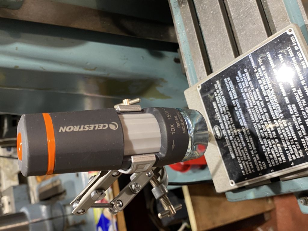

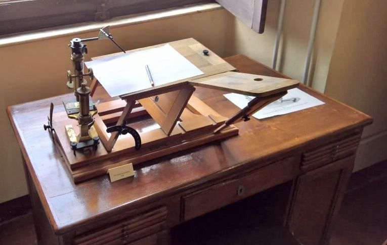

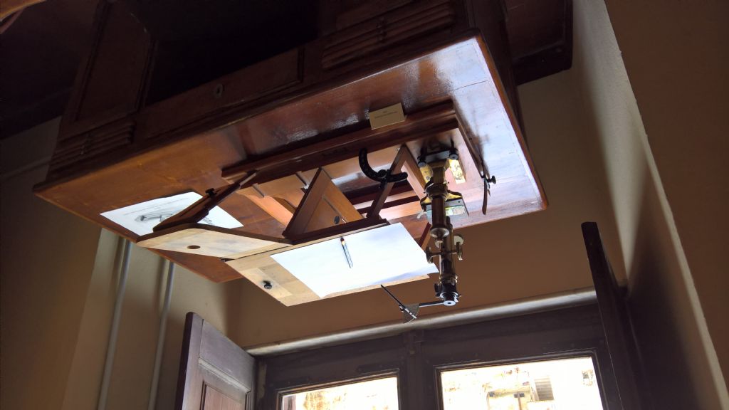

                                        drawing microscope.jpgHi Robin, I use a Celestron 44302. It was purchase from Amazon. UK for £47 in 2012. Do not know if this model remains available. Perhaps they will have improved. Mine came with a little stand that was useless for my purposes. I made up a flexible arm from my odds box. See photo.
                                        Hi Michael, as you say, the patience and skill of some people is astounding. I have a biography of Robert Hooke by Lisa Jardine. It is a very good read. Also, I went to the Museo Camillo Golgi at Pavia just before Covid struck us. Not everyone’s cup of tea, but to those of us studying the ultrastructure of cells and tissues a maestro. The curator invited me to use his drawing microscope, photo attached. Used to make the drawings of neurones and nerves that resulted in his Nobel prize. He must have had enormous patience and skill. It must have taken hours to make each drawing. I found it very difficult to produce anything resembling what I saw, although I have taken hundreds of photos using microscopes.
                                        As usual with this site my photos have been rotated. Apologies.
                                        mod edit: photos fixed

                                          Posted by Raymond Griffin on 15/09/2022 17:03:02:
                                          I went to the Museo Camillo Golgi at Pavia just before Covid struck us. Not everyone’s cup of tea, but to those of us studying the ultrastructure of cells and tissues a maestro. The curator invited me to use his drawing microscope, photo attached […]
                                          Thanks for that, Raymond
                                          Only a Moderator can rotate your photo now … but I will grab it and rotate my copy, to save standing on my head angel
                                          #613687
                                            I took the liberty of cropping Raymond’s photo, and lifting the shadows a bit.
                                            Very envious of you getting to try that, Raymond !
                                            Ref. __ http://museocamillogolgi.unipv.eu/homepageeng/
                                            Edited By Michael Gilligan on 15/09/2022 19:07:28

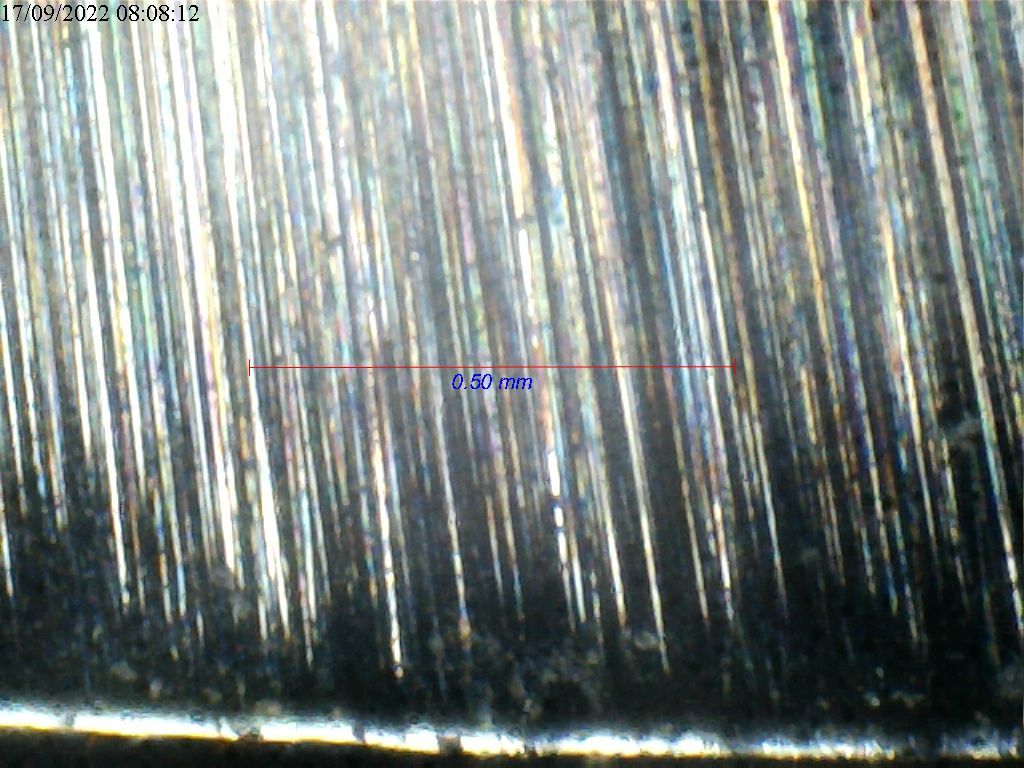

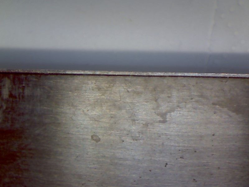

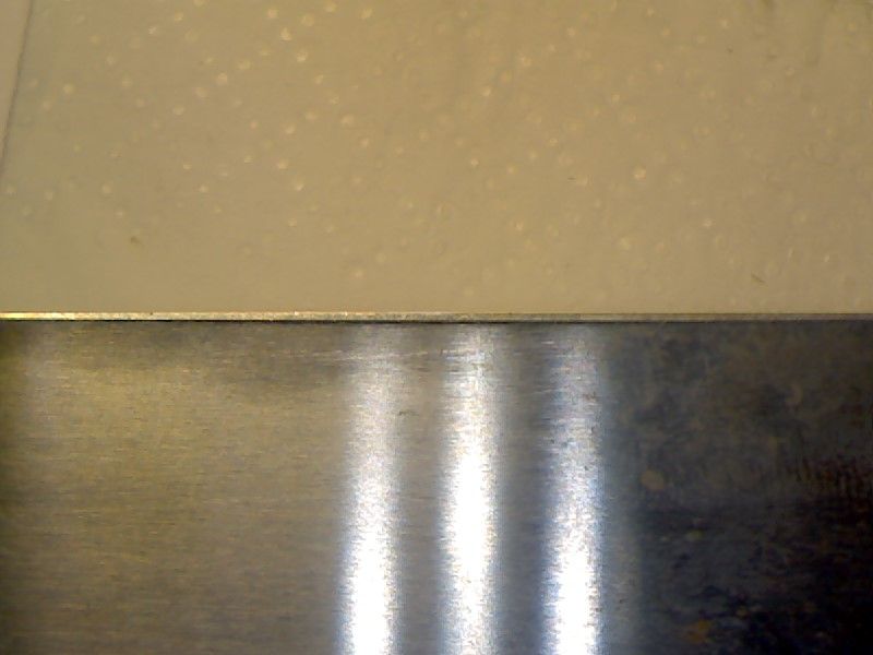

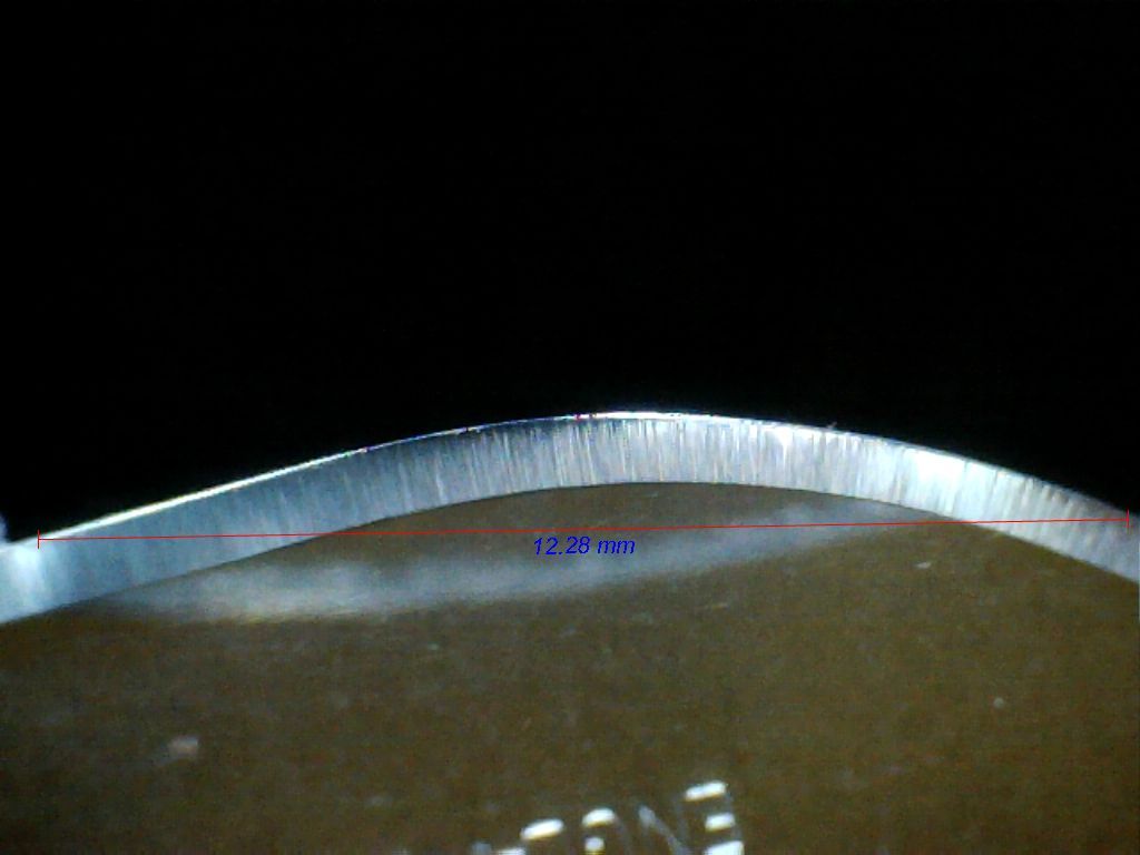

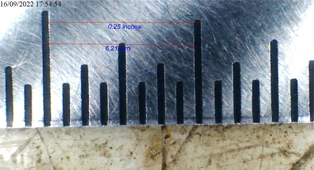

                                                      Hi, this may be of interest. I have two cheap USB digital microscopes, one which was cheaper than the other, but the better one is a Maplin Gadget one. It does take decent photos, but results are varied depending on how the light from the LED's is reflected of the item being viewed. The software includes measurements to be made, but they don't guarantee accuracy and the magnification ratio scale isn't truly correct, so I first took a photo of a "Precision Edge" X-ACTO square with inch measurements, divided into 1/32" and calculated the magnification ratio from that.

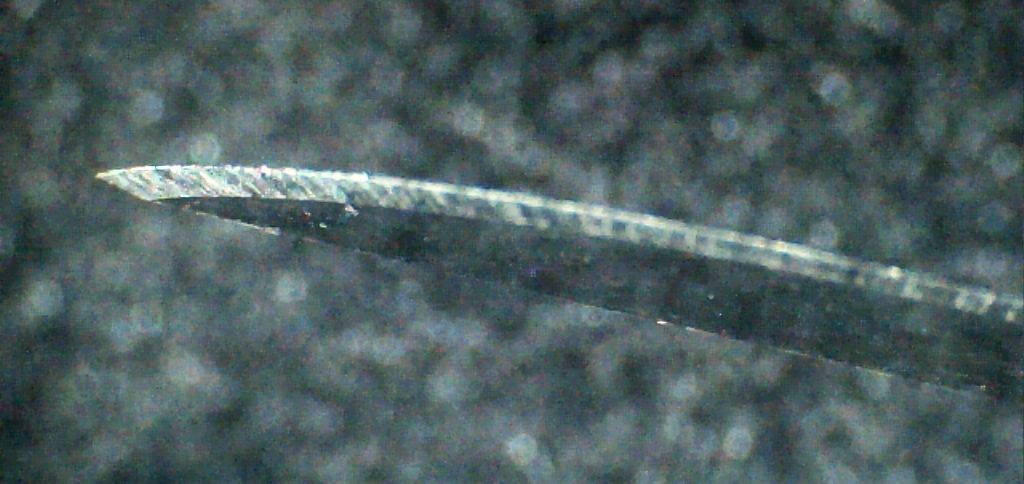

                                                      The next photo is a section of a Swan Morton No. 21 blade at about 20 x.
                                                      This one is looking at the actual edge with the point of the blade at the left, again at about 20 x, and you will notice how shallow the depth of field is, as only approximately 2mm at the tip is in focus.
