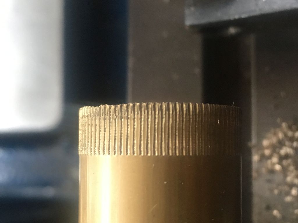

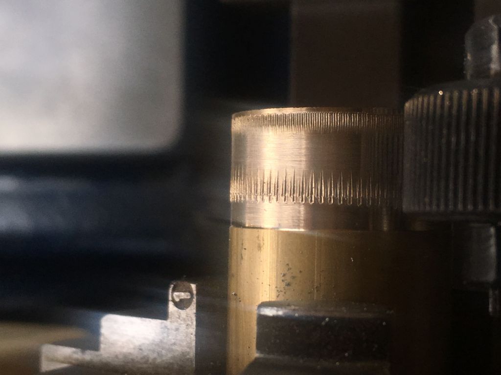

                                          Ok guys, I went with one of the scissor types. Had a little play with it today….
                                          Now, After everything I have gleamed from the subject of knurling, I wasn't expecting things things to go smoothly and I was correct. Trouble is I seem to get knurls on the edges and not in the middle, like rail tracks.
                                          I know there are other problems on there such as double lines etc, but been trying to save on wasting stock so using the bar more than once to practice on to see if I can get it to cut in the centre to no avail.
                                          I tried changing the wheels from diamond to straight. Tried the bar stock rough, then tried after turning it to size.
                                          tried with and without cutting oil. Clamping directly on centre and a little off centre. clamping down quickly to gain a bite. All to avail.. Any ideas where I might be going wrong, Do a pair of 'rail tracks' with no knurl in the middle suggest I am doing something obviously wrong?

                                            The first thing I would do with a small lathe is to put it into back gear, you will need lots of torque. My usual technique with a scissor knurl is to start with only a third of the tool width clamping on the job. I introduce the tool to the job and adjust the wheels so that they are finger tight on the diameter of the job. I then withdraw the tool and tighten the tool by about a quarter turn. Switch on the lathe and then advance the tool with the cross slide. This should produce a good pattern. Once the pattern is set then the tool can be advanced towards the headstock with the leadscrew.
                                            HTH,
                                            Rod
                                            #366665
                                            Anonymous
                                              Start at one end, with the knurls just overlapping the work. Once they've started to form a good depth of knurl you can move the knurling tool along the rest of the knurl. Trying to form the knurl full width will probably require more force than the tool can provide, unless you have a friendly gorilla in residence.

                                                Aha… Amazing. Thank you guys I had some success at last following your advice…
                                                Now then….. Suppose I don't want to start right at the end of the bar, but only want a small band knurled about the width of the wheel half way along the round bar.. Not possible?
                                                      Angle the knurl slightly.
