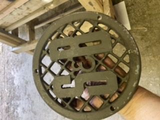

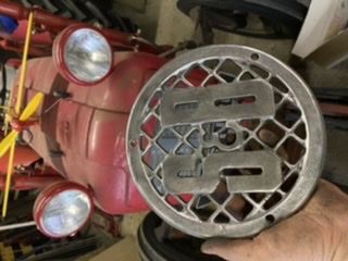

        I am in the process of improving my S&B Sabel lathe.
        Ive owned it for a while but have recently acquired a second knackered machine to scavenge from.
        This thread will follow the general exploits of this process starting with the new lathe cabinet.
        Here is a photo of the amazing cast alloy S&B logo from the cabinet to get going.
        Hope there is something of interest to members as I go along.
        Jim
        Cabinet Plate 1
        Cabinet Plate 2
        Edited By Jim Beagley on 03/06/2020 15:11:30

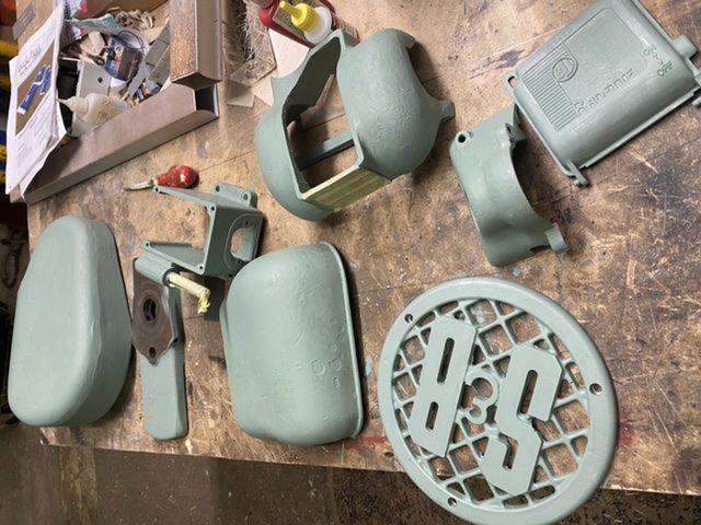

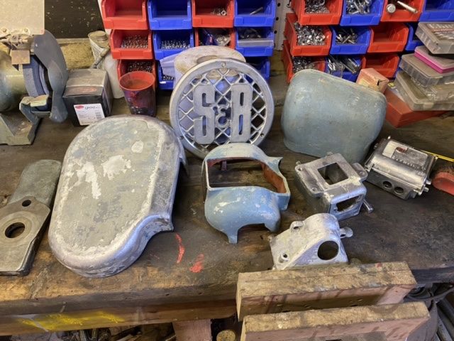

                  So quite a lot of progress today.
                  the cabinet was primed and now has the final colour. I’m still undecided if I like it The intention was to match the colour that the lathe is currently but it’s come out a little blue. Having said that, I’ve been cleaning a few of the castings today (start of the strip down) and when clean the paint isn’t a bad match.
                  Anyhow, what do you guys think of the colour?
                  Cabinet in Red Oxide
                  Cabinet in Tractol
                  ive also prepped and etch-primed a few parts.
                  buggered if I could get any of those rivets out though …
                  Castings prepped
                  Castings in Etch Primer
                  the S&B logo looks great, but it was a bugger to clean, a bugger to prime and I’m sure a bugger to finish

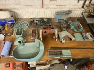

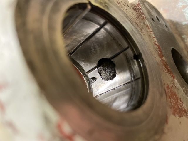

                                    I told myself I was only going to clean it and give it a lick of paint, but the Sabel is now in a hundred pieces in the process of being stripped and cleaned.
                                    The spindle is not too bad, but the rear (smaller) bearing has had some bit of rubbish in there at some point and has a score line along with the spindle. Do I just need to stone it, or leave it alone now?
                                    Rear Bearing
                                    Spindle Rear Bearing
                                    I have to do the saddle and gearbox. The bed was cleaned tonight. Loads of bits.
                                    Is it worth replacing the rear thrust bearing? I seems fine to me.
                                    Lastly, anyone know of a source for the oiler felt? Mine has definitely seen better days. Lots of the oil ways were pretty blocked, so I think this strip down was worth the trouble – mind you, I've not finished yet.
                                    Oiler Felt
                                    Oh, and I still cannot budge those stupid hammer-in rivets. Bah.
                                    Parts waiting paint

                                              The 'damage' on the spindle seems superficial to me although I would use a stone or well worn smooth flat file to remove any peaks that are present. The corresponding bearing looks OK and I would leave it severely alone.
                                              The thrust bearing can be washed out in kerosene, the two thrust washers will tell you by the polish marks the balls have made if they are in good condition. If all that is satisfactory I suggest you re-use it. Boxford may also stock the felts, they too copied the Southbend lathe in their clones.
                                              Before you rebuild the lathe it might pay you to look at the condition of the 4 step pulley on the countershaft driven by the motor. I was plagued by belt slip for some time before I spotted that the grooves had worn into J shapes and the belt was running on the bottom. Like you I had a cannibalised machine that came with my purchase which still had the cast iron 4 step pulley for the lathe spindle. It wasn't very difficult to machine up a sleeve from aluminium so that it could be fitted in place of the worn version. I also had to re-cut the grooves in the motor pulley for the same reason, just to reshape the sides was enough in that case
                                              Assembling the spindle again [holding the lubrication springs and felts down is helped a lot with needles through the drainage holes at the side of the bearings and makes that bit easy enough], but fiddling all the diameters into the right place to slide the spindle home will test the patience of a saint. Do make sure you have everything in the right place when you do so, you really only want to endure the experience once and once only!

                                                That spindle will be ok, the score is less than 10% of the area. I replaced the thrust race on the Model A with a metric one, I think the bore was the same as the old one, you would have to do a bit of research on the sizes for the Sable first as the design differs.
