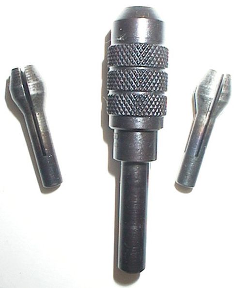

                    I use a pin chuck to hold  drills as small as 0.3mm in a pin chuck that uses collets. Your biggest problem with accuracy is the runout of the Jacobs chuck in your drill.
                    Paul

                          The pin chuck is a good idea, the most important part of which is that it has a straight, short shank. There are many things (wrongly) described both as pin chucks or pin vices, a lot of which have long, knurled shanks.
