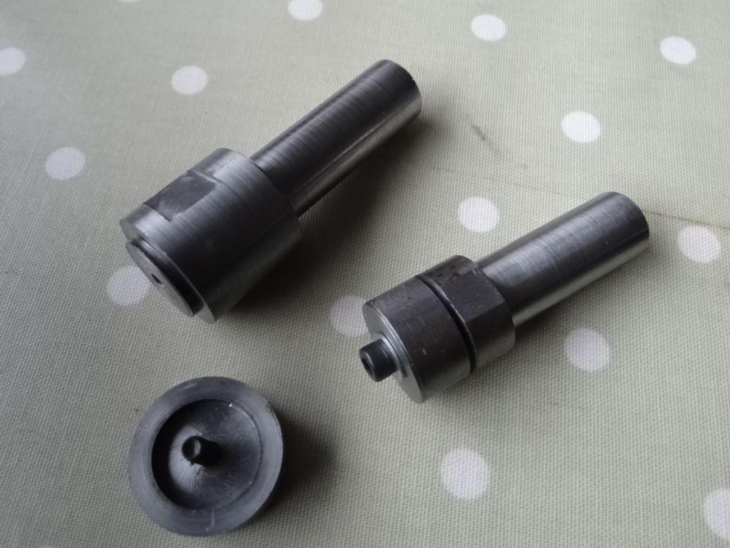

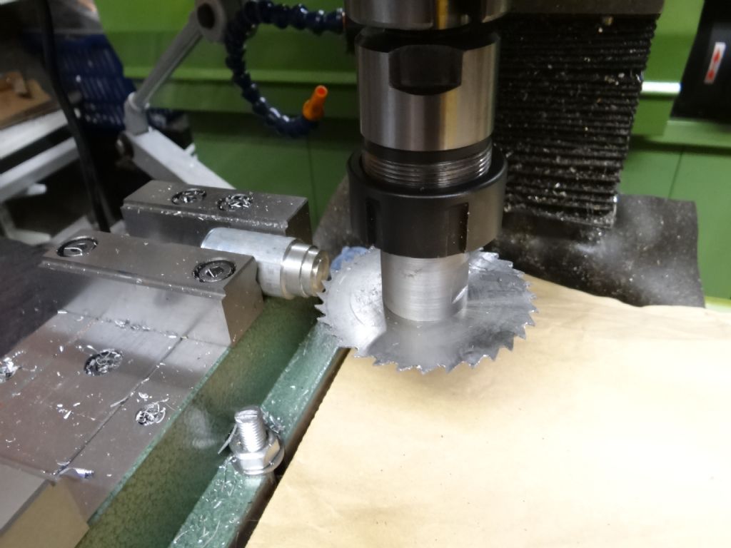

            Here's two I made earlier, both EN1A with parallel shanks to fit ER32:
            The clamping part on the 1" arbour is 30mm, slightly less than 1¼" and it grips OK.
            Note the flats milled to allow the arbour to be held by an adjustable spanner for tightening and undoing the bolt.

              Thanks for the picture Dave, that is exactly how I imagined making it.

                  The tool is made to hold a slitting saw, which cut metal. I use them mainly to cut screwdriver slots in home-made machine screws.
                  Mostly mounted in the spindle of a milling machine, where it can be moved to cut a horizontal slot into work held in the vice:

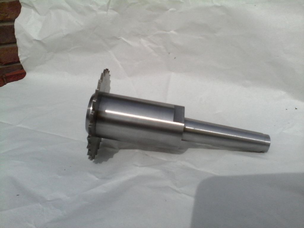

                      I made one very similar to Dave's many years ago but with a MT #2 taper to use in the lathe. I didn't put flats on it and tighten and untighten it up once mounted in the spindle which I found works OK. The clamping washer is 1 1/4' so only has 1/8" of clamping surface but holds the saw securely and if it does slip I consider it a safety feature. I now use it only in the vert. mil mounted in a #2 to R8 adapter, with the draw bar into the thread in the morse taper. If you use a morse taper ensure you use a draw bar as they tend to come loose if subjected to side pressure as in this case. I have used mine many times in all types of metal with saws from 1/32 up to 3/16" and have found it more than satisfactory

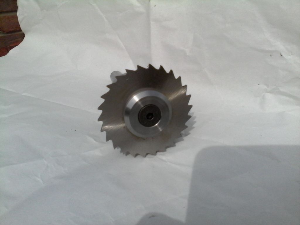

                          The arbour I made , has the 25.42mm bore, that is 10mm deep. It then has a M8 tap hole a further 16mm deep.
                          The cap has the 25.40mm spigot, 8mm long, and at the shoulder, it is continued in an under cut way for 0.3mm deep, just a little more than the tool radius. The shoulder face is under cut out to about a 3mm land. In my case the arbour shaft is 19mm and the body is Ø40mm. I made it with the spigot on the nut, as the nut could then be thinner on the underside, and has the capscrew counter bored in it. Longer caps can be made for a gang of saws if required. Make the cap from a different steel to the body, so that it is less likely to pick up in any way. Like 4340 for the body and free cutting MS for the Cap.

                            My arbor is almost identical to Neil's above ( but with a #2MT shank), except that I made the cap spigot 1/2" long and the flange 3/16" thick. This allowed me to recess the 1/4" hex socket retaining screw fully into the cap which allows the unit to be used very close to the vice jaws or other surface.

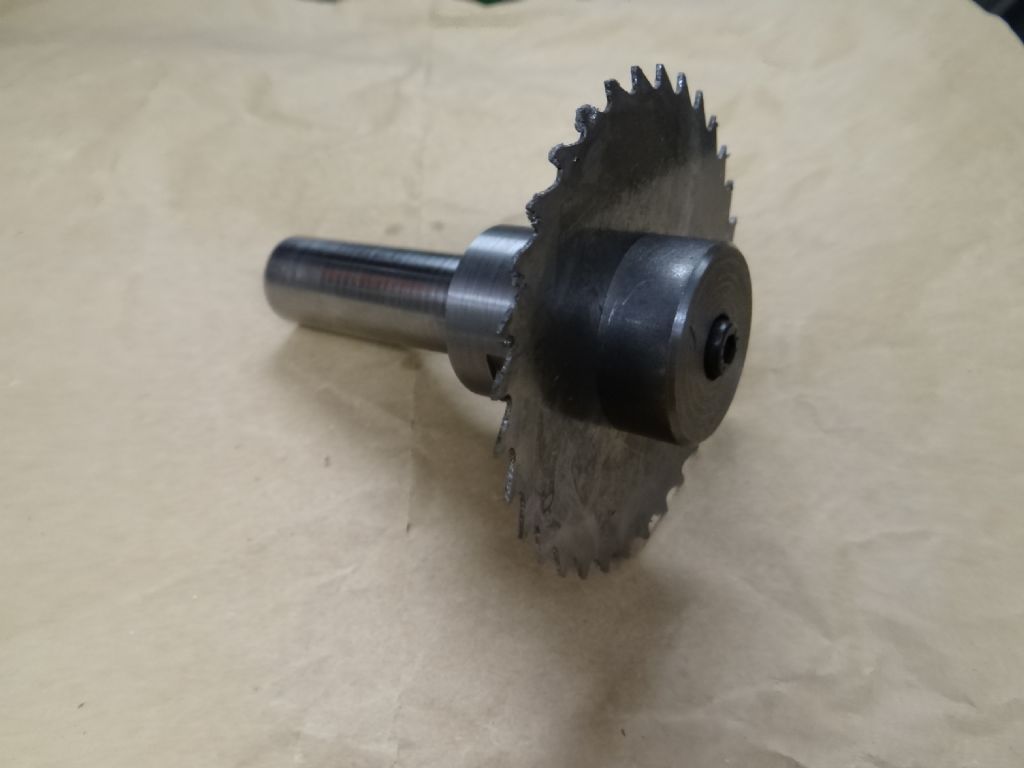

                                      Here is one I made 30 odd years ago, 3 MT with draw bar thread, no keyway, made from bright mild steel. Not sure if EN numbers for steel were invented back then, or at least I didn't know about them if they were!
                                      Spanner flats or a tommy bar hole would be a good modification for me to make. I would suggest you make the end cap thin and flush fitting, as this allows you to work close to any obstacles on the part you are cutting, or close to the machine table/cross-slide etc. Not touched any engineering since the mid 1980's, just making a re-entry to to this hobby.

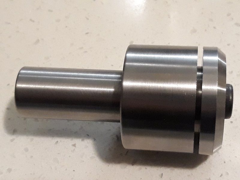

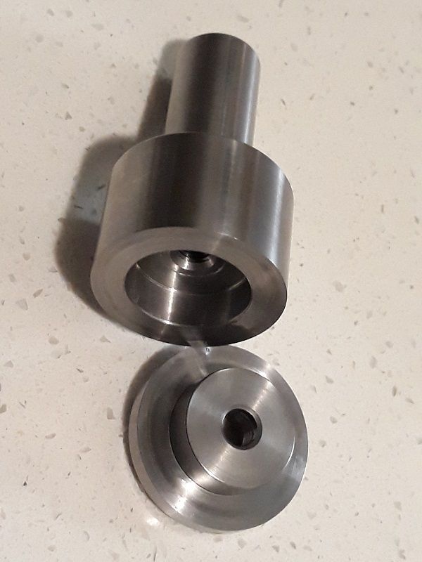

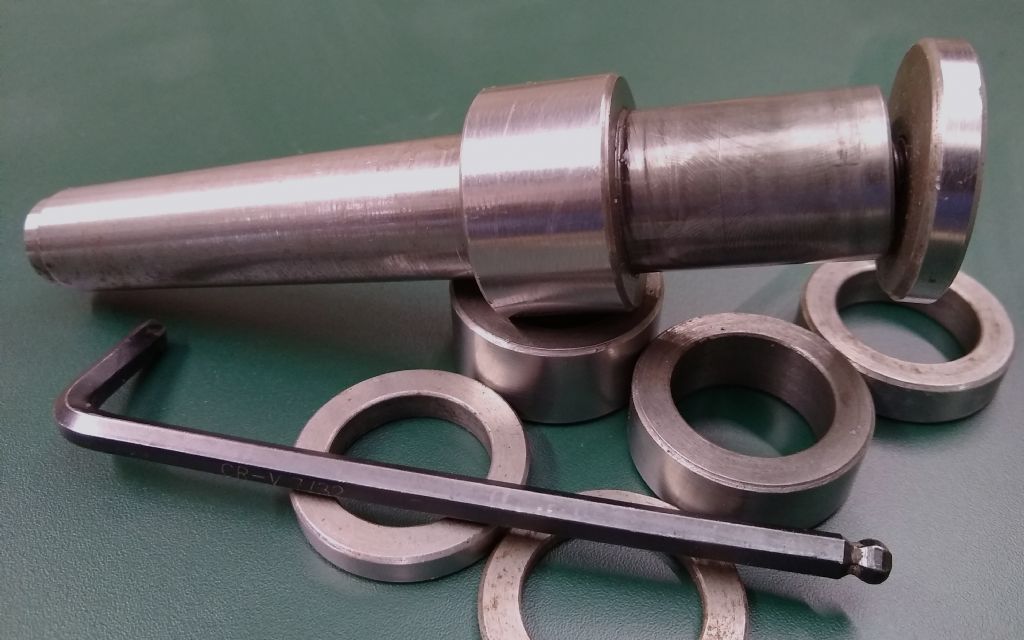

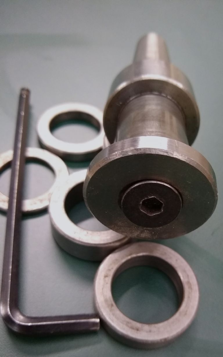

                                              Finally got round to making the arbour. Chose mix and match all the ideas posted to make a MT2 with plug type cap. Had to limit it to only holding up to a 1/8" blade as I only had a short counter sunk screw. I tried it out and it runs true and cuts perfectly.
                                              Adrian

                                                Looks good Adrian, best get a longer screw just to be sure.

                                                      Adrian,
                                                      Very nice work. Envious.
                                                      And as Eric Morecombe used to say "You can't see the join"
                                                      Howard
