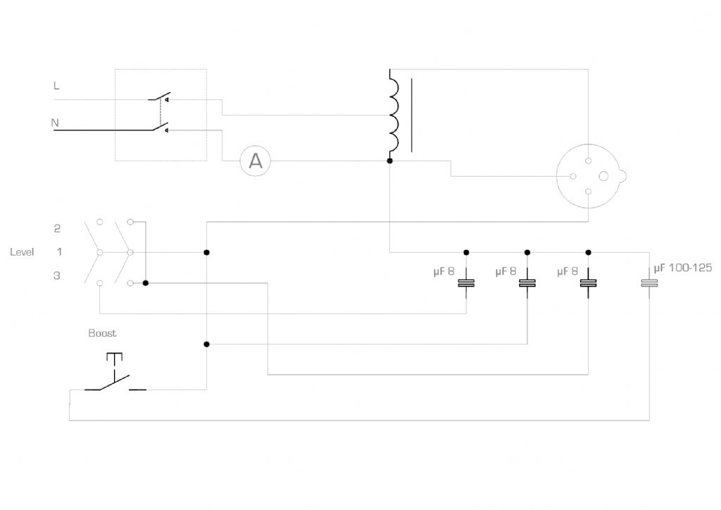

                                                    Above is the circuit diagram, very basic bit of kit.
                                                    The Clarke converter pointed out by Dave, looks to like the converter starts up with one set of capacitors and then switches over to more or whatever.
                                                    I have connected 3no. 60Wh filament bulbs, 1 gets over 300v the other about 85v (according to my multi meter)
                                                    The 100 -124 Mf capacitor is a motor start, my multi meter on capacitance range only gives me a nF reading, the 8Mf read about 7 and a bit.
                                                    I haven't put my meter across all the other capacitors, has anybody got any better suggestions?

                                                      Well that circuit applies 180 degrees to two phases (should be 120) and about 90 to the other. not an ideal situation.
                                                      The capacitor that reads in nF range is faulty. The 8uF are about right, tolerace is tpically +- 10% and normally under. Note that it's not just capacitance and basic voltage rating that matter when replacing. It must be rated for motor starting applications.
