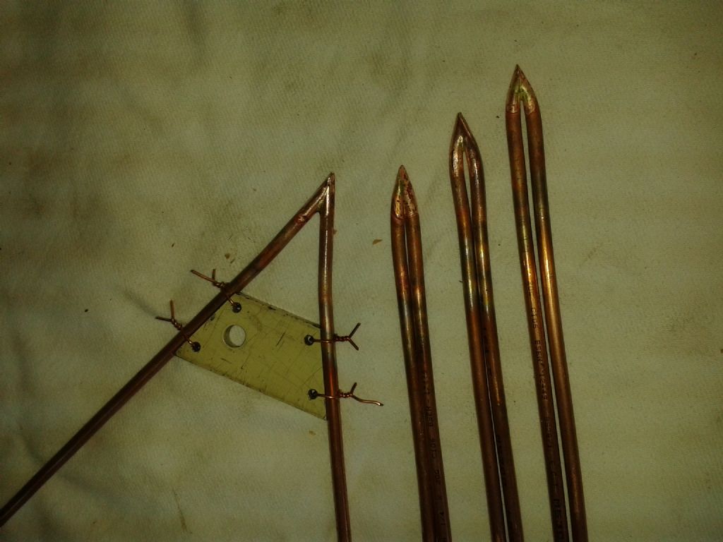

                                                If you are set on using stainless steel, pass this one by, I used copper for my 5" loco superheater and used the method shown in ME.
                                                Make a simple jig as per photo, cut the tubes and file the joint as shown and then bronze braze the joint. Do use flux and minimal filler rod so as not to block the tube. Remove tubes from the jig and squash the tubes together. Pickle after to remove all traces of flux.

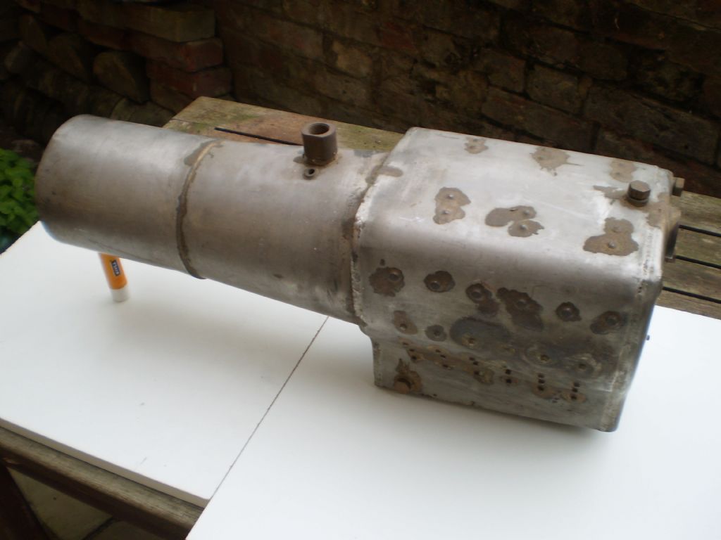

                                                  This was a stainless steel boiler that I made for a 5" Firefly loco. 10 gauge backhhead and tube plate thickness, all formed over 'jab rock' formers using a club hammer. Most of the joints were silver soldered with the old EasyFlo silver solder and Tenacity 5 flux. PLENTY of heat from a 4 pint paraffin blow lamp and a BIG propane Bullfinch torch on propane.
                                                  Use plenty of heat to bring the joint up to temperature quickly, but not too much (Oxy Acetylene is great, but can burn the flux out before the silver solder flows)
                                                  Unfortunately (In ignorance) the boiler could not be certificated as at the time (1966) UK inspectors were not prepared to issue certificates for stainless boilers.
