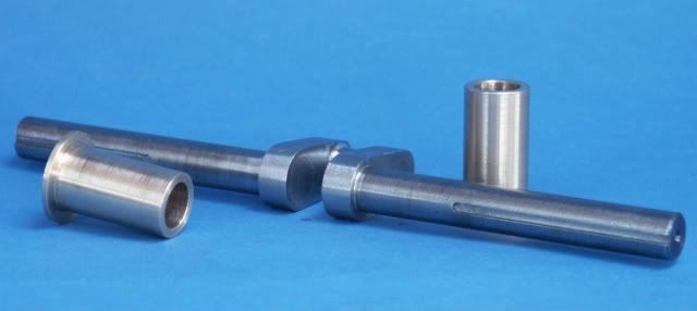

                  #57517
                    I would just cut the waste out with a hacksaw and then clean up the web faces with a file, the silver steel won’t be hard so just saw it.
                    Its a good idea to wrap a bit of alloy around the crank pin so you don’t damage it if the saw breaks through a bit suddenly, I made this this crank a couple of weeks ago and that was just sawn away.
                    Also a ring of tippex correction fluid on teh pin and shaft will stop solder sticking where you don’t want it. Like Kwil I use Tenacity when its a larger fabrication as it can stand heat for longer.
