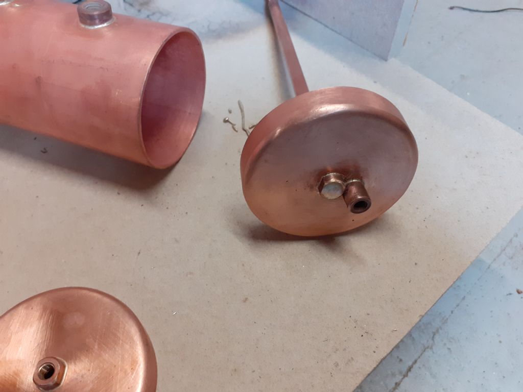

      I am almost ready for silver soldering a new boiler for a small engine. The boiler is copper and phosphor bronze bushes. But there is a copper rod from front to back with bronze nuts. Where do you start do I solder the nuts on to the ends first then solder the end caps on to the main tube then solder the bronze bushes the copper rod has to be tight to hold the ends under pressure.
      David

        Clive Brown 1
          @clivebrown1
          The boiler appears to be quite small. I'd assemble it with perhaps 3 or 4 small bronze screws holding each end plate to the barrel and solder all in one go, including the bushes. The bushes couid be done earlier, maybe with a slightly higher MP solder if you wish, but I don't think I'd bother with that.

          David George 1
            @davidgeorge1
            The end caps are held on with the copper bar with bronze nuts but do I solder the bronze nuts at the same time as the end caps which are 12mm lapped on to the tube but about 5 thou clear to allow the solder to go up between them. The tube is 2 1/4 inch diamiter by 6 inch long.

            Simon Collier
              @simoncollier74340
              5 thou sounds a lot. If you put an end cap in position and hold the barrel vertical will the cap fall out? They want to be a close sliding fit. Otherwise the solder can run straight through the gap and out the other end. I believe the advice to leave a gap for silver solder (and Loctite!) has caused more grief with boilers than any other thing. You need some gap, of course, but not much. I learned that lesson after much anguish and waste of ss.
              I would pickle, rinse, assemble, and flux generously, set vertical, solder one end flange, stay and nut, set other end vertical and repeat, then set horizontal and do the bushes. If not confident, or worried about flux exhaustion, do one operation at a time, cooling and pickling between steps. My similar Ellie boiler has plain stay without thread or nut; they are unnecessary and just more work.

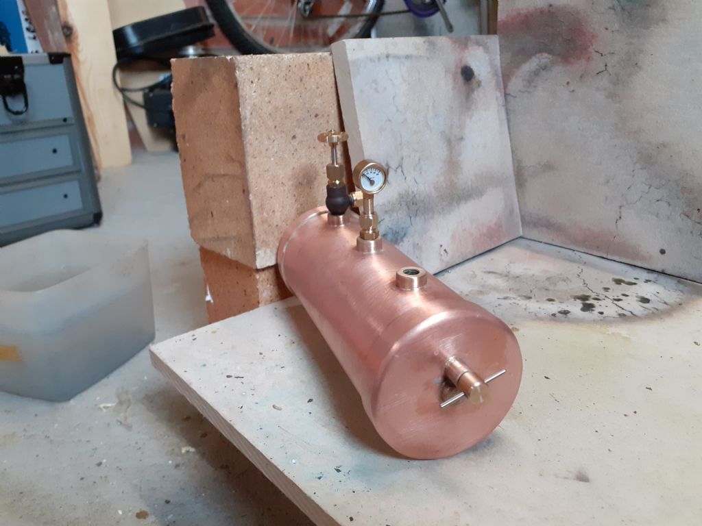

              #471161

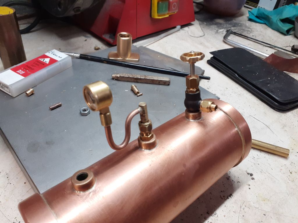

              David George 1
                @davidgeorge1
                I have silver soldered the boiler. I decided to do it in stages, firstly I soldered the three bosses in the top of the boiler, then I soldered the boss for the level plug and the end nuts into the end caps and then the end caps were soldered one at a time on the ends. I pickled between each go and with a clean and flux on to the next stage. After fettle and a bit of scouring pad it looks ok.
                David
                #471166
                MichaelR
                  @michaelr
                  David, You have made a nice job on your boiler very neat, just one point you really need your pressure gauge on a "U" Bend syphon to form a water slug which protects the gauge from damage by direct steam pressure, although you may know this already.
                  MichaelR
                  #471167
                  Brian H
                    @brianh50089
                    That's a smashing job David, especially as it's your first one. A very neat job of silver soldering.
                    Michael is completely correct, it really needs a 'U' bend or a coil of tube but a 'U' bend looks better.
                    Brian

                    David George 1
                      @davidgeorge1
                      Thanks for the information about U bend. It's a bit of a learning curve I just thought it looked ok there I will have to include a bit more tube. What pressure would it be tested to for a working pressure of 30 PSI.

                      Brian H
                        @brianh50089
                        David, the initial test is normally carried out at twice working pressure and subsequently at 1.5 times W.P. It is best (in my opinion) to pump it up in stages to work harden the copper. Say, up to 10 psi and release, then up to 20 and release etc.

                        David George 1
                          @davidgeorge1
                          Hi Brian the U tube. Do you have to put water in the U part or dose it just fill with condensate from the steam. What happens if the steam gets to the gauge?

                          Brian H
                            @brianh50089
                            Hello David, yes, the U tube will fill with condensate as soon as steam appears. Not sure what happens if steam gets to the gauge, hopefully someone else can answer that one.

                            #471486
                            David George 1
                              @davidgeorge1
                              U bend added to gauge.

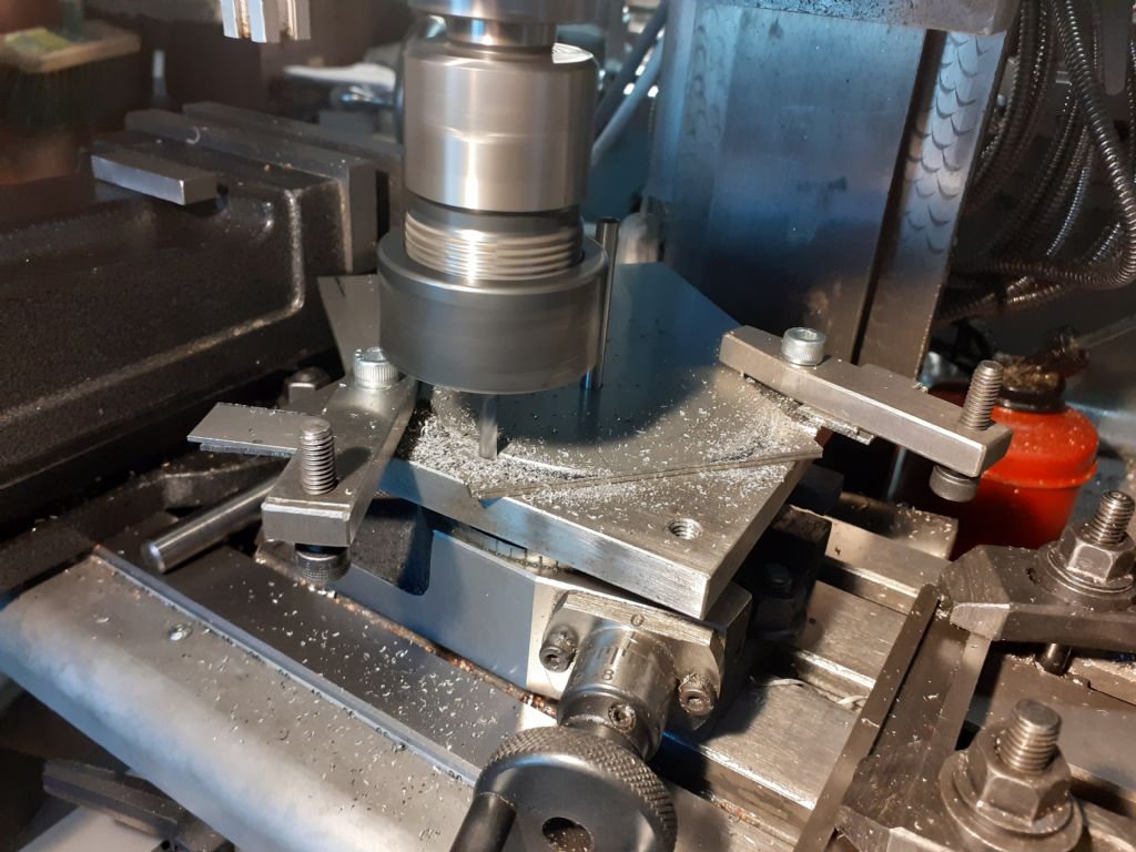

                                              #473974

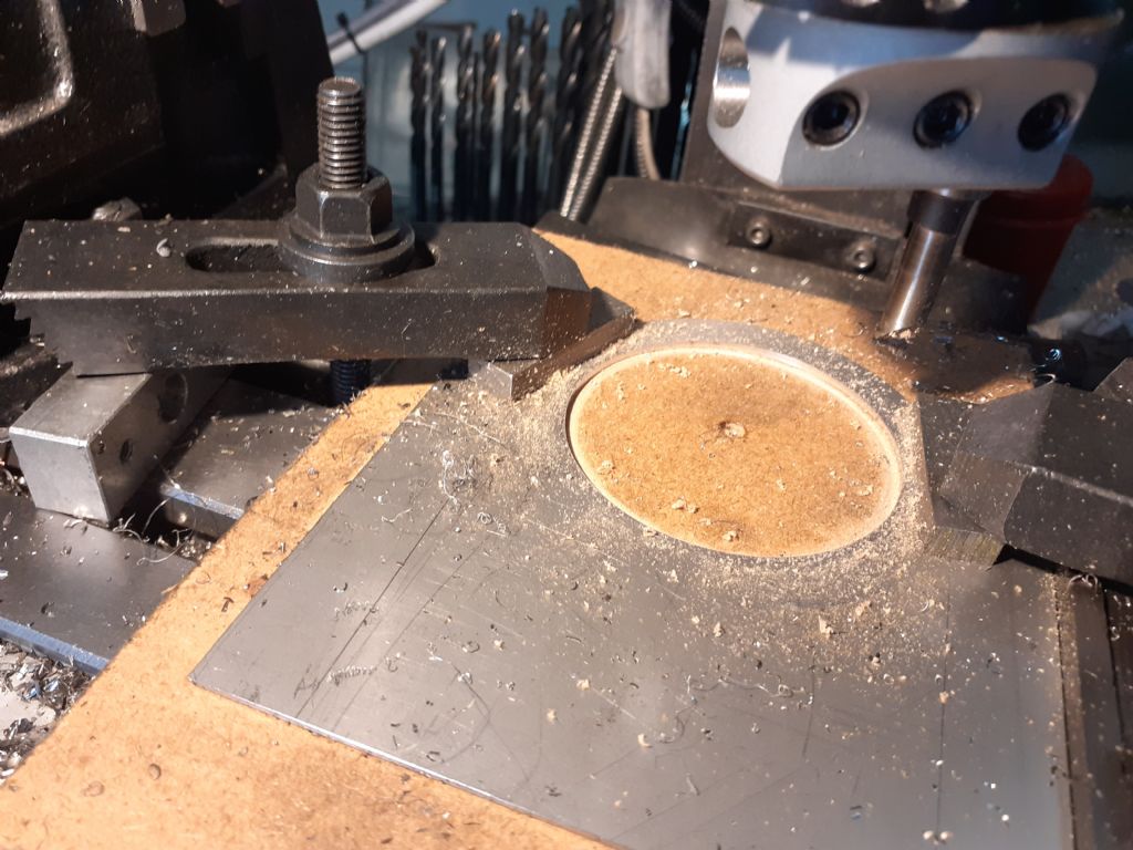

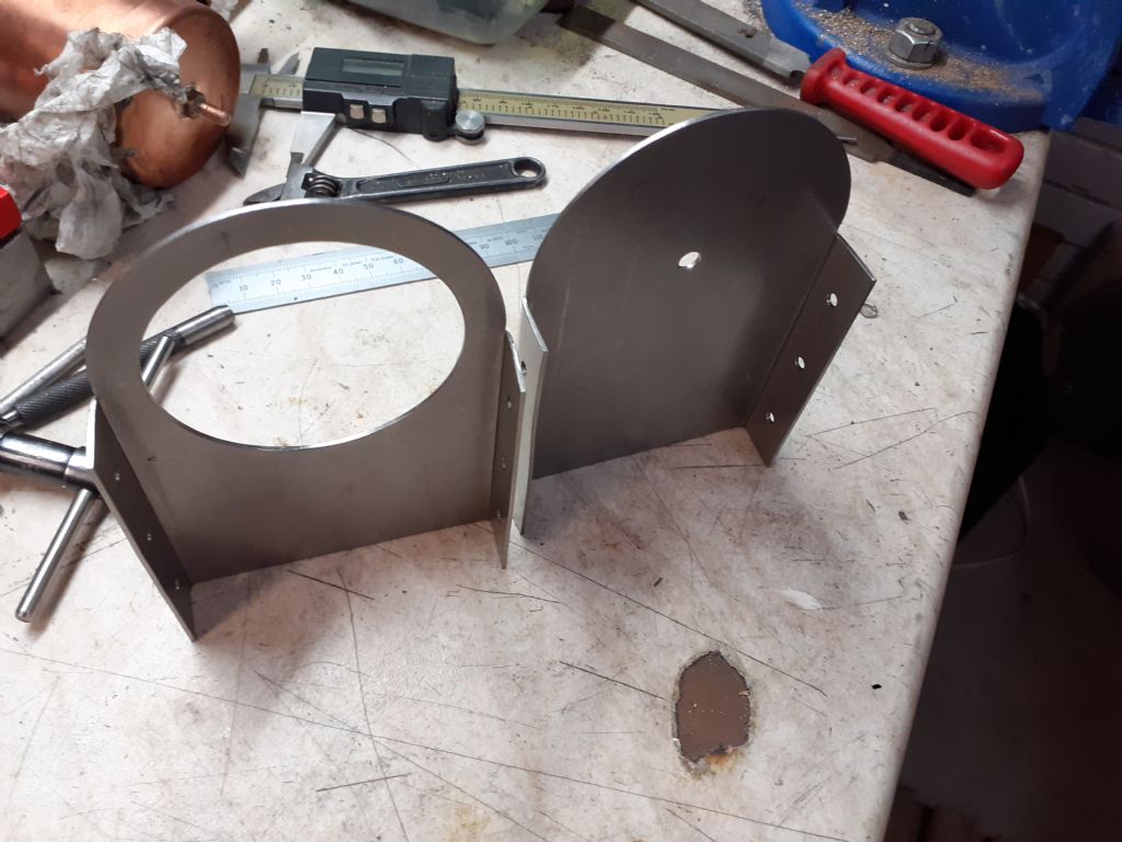

                                              David George 1
                                                @davidgeorge1
                                                Made the boiler end support plates. I decided to make them from stainless steel perhaps could have been a little thinner material, 1.2mm, but I managed them in the end although I had to put a groove down the fold line to get a nice bend.
                                                Rotary mill end top radius.
                                                Bore hole for boiler.
                                                Bent ready to try.
                                                These are finnished now.
                                                David

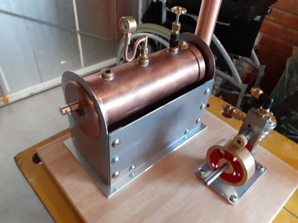

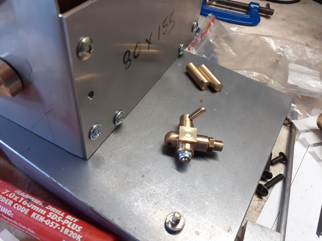

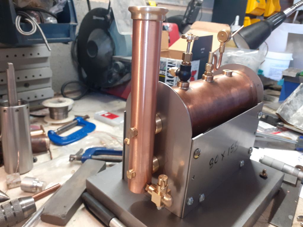

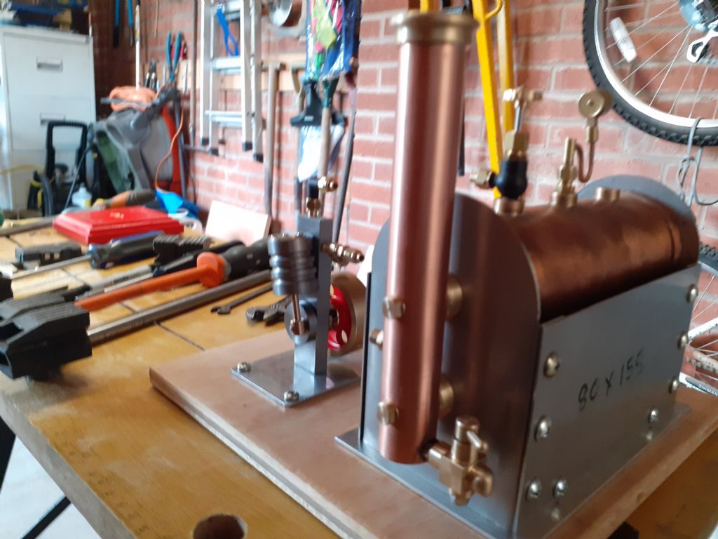

                                                #475217
                                                David George 1
                                                  @davidgeorge1
                                                  Made a bit of progress on boiler and made a small drain cock for condensate in chimney, made chimney and started mounting boiler and engin.
                                                  David
                                                  Edited By David George 1 on 26/05/2020 23:01:24
                                                  Edited By David George 1 on 26/05/2020 23:02:18

                                                    #475393
                                                    geoff walker 1
                                                      @geoffwalker1
                                                      Yes, agree with Pete, looks great.
                                                      The smoke stack puzzled me but having looked at the drawings on steves website I can see that it is for the engine exhaust.
                                                      Have you made a burner
                                                      Geoff
