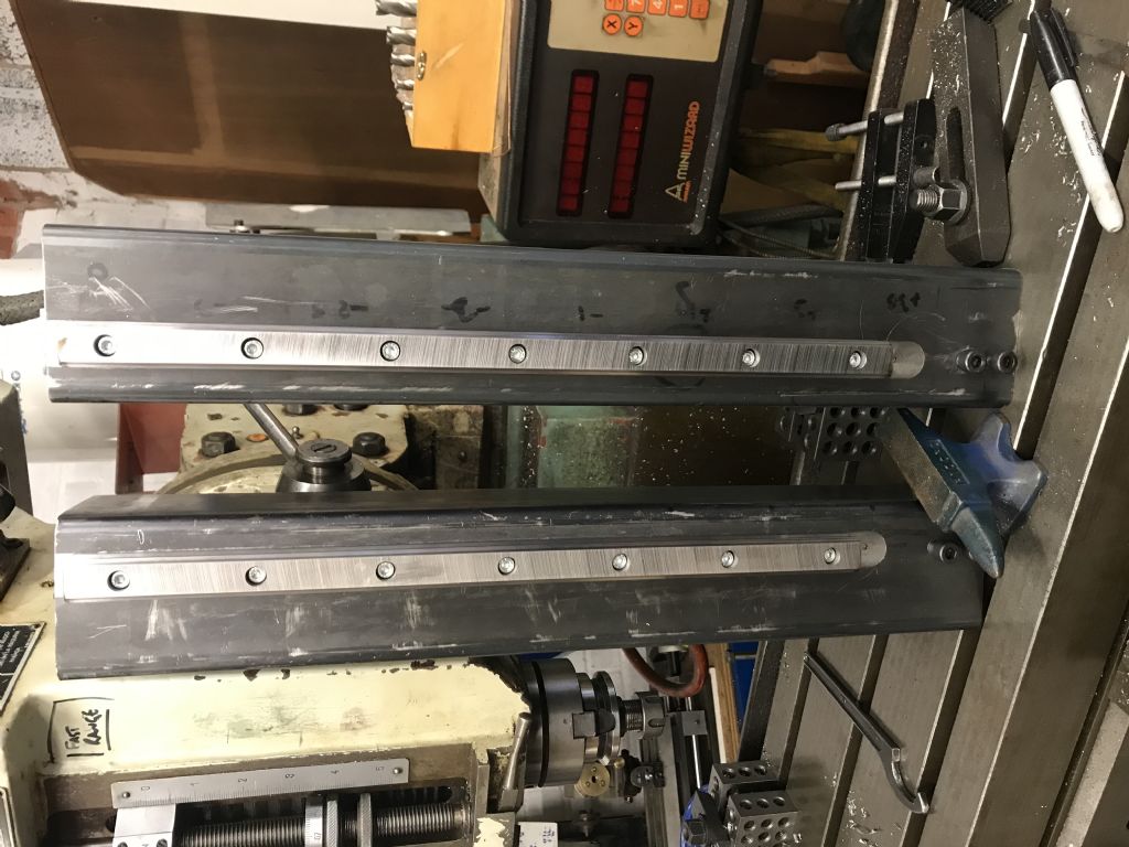

      I have just snapped another M5 tap on my current project.
      <Sigh>
      Now I get to practice tap removal again.
      That is a skill I wish I didn’t get the opportunities to practice.

                    HSS from a reputable source. Nearly new, probably done under a dozen holes.
                    Just one of those things I guess, no difference in the procedure from how I’d normally work.

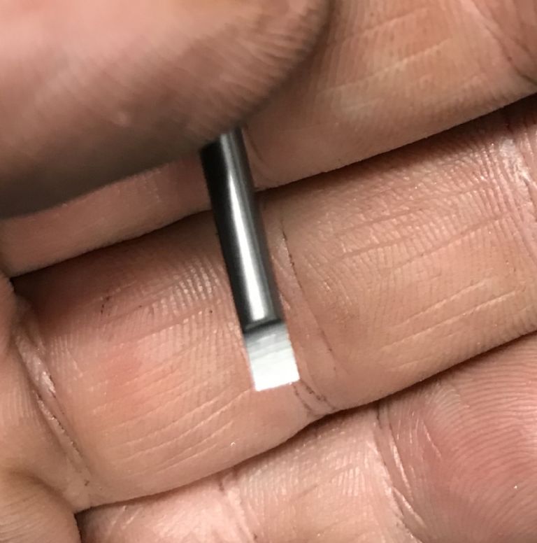

                    Some pics:
                    Carbide D bit:

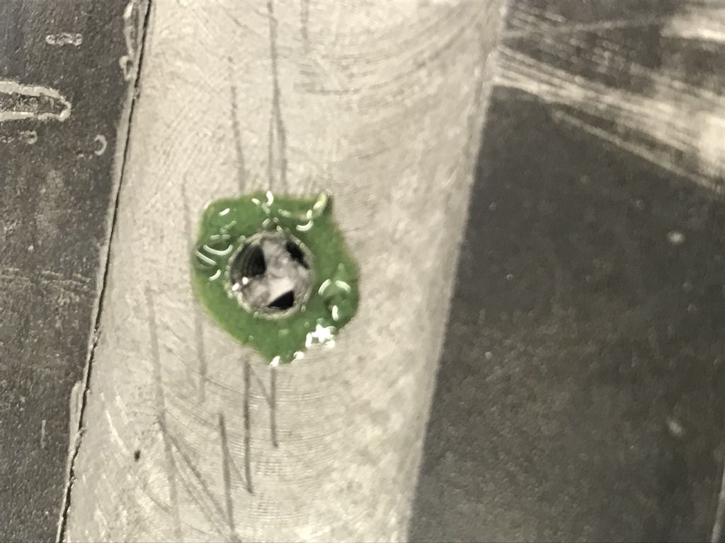

                    Peck drill 1 thou at a time…

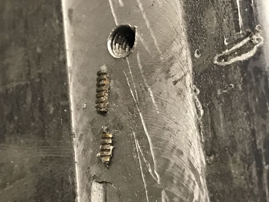

                    Then pick out the remains:
                    Rescued, thread ok and part usable.
                    It’s good that this is possible but a trick I would rather not need…

                        I made it from a snapped PCB drill. I have a Deckel S0 grinder.

                                                  Managed to complete the second part without any mishaps  The “backing” is 30mm square, so hopefully adequately rigid.
                                                  The D bit technique is one I got from James Harvey’s Machine Shop Trade Secrets. It’s a good book of short tips and tricks. I misremembered it slightly – he uses a ball nose, which presumably is a better geometry. He also likes to make the cutters hexagonal rather than round for some reason.
                                                  The important bit tho I’m sure is having a rigid setup and pecking a thou at a time:
