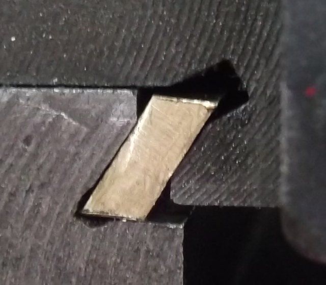

      I have decommissioned my SX2P to try and improve on a few of its shortfalls.
      I am focusing on the x-axis gib which does not sit properly on the dovetail. As you can see from the picture, the gib only touches the table dovetail on its edge. This has caused a pitted line on the gib due to wear. Fortunately replacement gibs are cheap.
      I have read about people using brass gibs, reforming the gib screw points etc. I have not modified the stock gibs and gib screws in any way. The y and z axis gibs appear to make good contact, but I will be checking them for wear later.
      What are your thoughts on this?

          Looking at your photo, the angles are different…..hence the wear line on the strip…
          This is your decision on what to do about it….bottom line, the dovetails need matching.

              Yes, the gap between the dovetails needs bridging as clearly the stock gib is too thin. But even so, if the gib screws were impinging on the correct height (mid of dovetail) the undersized gib should make good contact. In other words, my evaluation is that unless the gib is a press-fit between the dovetails, the problem will still be present to some extent.
              Frances, I too get movement when approaching the travel limit. This is particularly so for the x axis which has a shorter gib. It might the angle of the photo, but in your picture the brass gib seems to be at a significantly different angle too. I wonder if you have noticed any wear?

                As John says: 'the angles look different' … but … zooming-in on your photo; the angles on the castings look fairly well-matched, yet the gib-strip is standing more vertical. dont know
                This is all-the-more confusing when we note the [high] location of the ajusting screw !!
                I suggest that you first look very carefully at the gib-strip and its adjusters … I suspect that something is binding, and not allowing the strip to sit correctly.

                  Hi Michael, I'm pretty sure this is what John meant by angles being different, so I think we are on the same page.
                  Having to guess, I would say the gib screws impinge lower than they should; the picture perspective makes it look like they are higher. This would explain the gib misorientation. In any case the height different will be minuscule.
                  Right now the gib screws are flat-bottomed, but their sitting location on the gib is anything but flat. I remember seeing somewhere one forming the gib screws tips into rounded points as part of the general prep of this machine. Seems like that's the place to start.

                        A little thought will show that the angle of the face the screws protrude from doesn't matter (as the strip should not be in contact with it!)
                        It's to do with the geometry of where the gib screws press on the gib causing it to tilt. You need to ensure the contact point is either higher (by using pointed screws) or closer to the rubbing surface (by milling pockets).
                        I encountered this problem once when i made a replacement gib, and creating pockets to move the screw tips closer to the rubbing face worked a treat.

                            Just reporting back with good news. It turned out the relief was adequate with plenty of clearance.
                            I ground the gib screws to a point and the gib contact on the table's dovetail is now much improved.
                            I ordered some cone-point grab screws and got a new gib strip. The gib strip does not have any dimples formed. I think I can improve the contact a bit more by milling vertical V-grooves on the new gib where the cone-point grab screws will sit in. This way I'm hoping the gib will assume its natural position on the dovetail.
