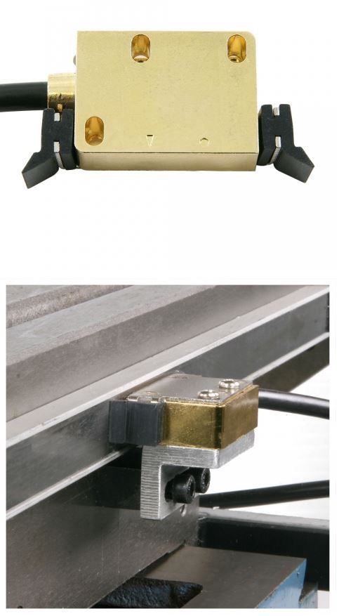

                              Indeed, I understand the options available for the hobby market.
                              One can have a look at this page. This gives one an idea of the kind of kits available for X/SX2.7/L
                              Average price for such a kit would be currently around the GBP420.00 inc.vat which would include the dedicated display system (not the bluetooth system)
                              Considering all the options available to the hobby user, how many people would consider paying this?

                                  If you are going to be spending that much you may as well spend a little more and get a fully functioning display from one of the UK suppliers or take your chance with similar direct from overseas.
                                  The Sieg "kits" don't look to be anything specific for their machines with the smaller brackets being fairly universal so end user would still have to do the fitting in much the same way.
                                  Don't really see the point of the Bluetooth as by the time you have got a dedicated tablet which is the more sensible option and a power supply and bracket for it you have not saved a lot. You still have all the wires to the read heads plus their power supply and transciver so actually end up with more wires and transformers than a single unit.

                                    Having viewed the SIEG reference in Ketan’s post the scales appear to be much neater and by virtue of their size then easier to fit, would need to check prices in order to compare with glass scales.

                                      Ketan gave the price he would have to retail them at – £420
                                      Having seen other photos of the read heads I would be worried about swarf getting between the scale and head particularly on the x axis, they just have wipers on the end but nothing to stop muck dropping straight down.
