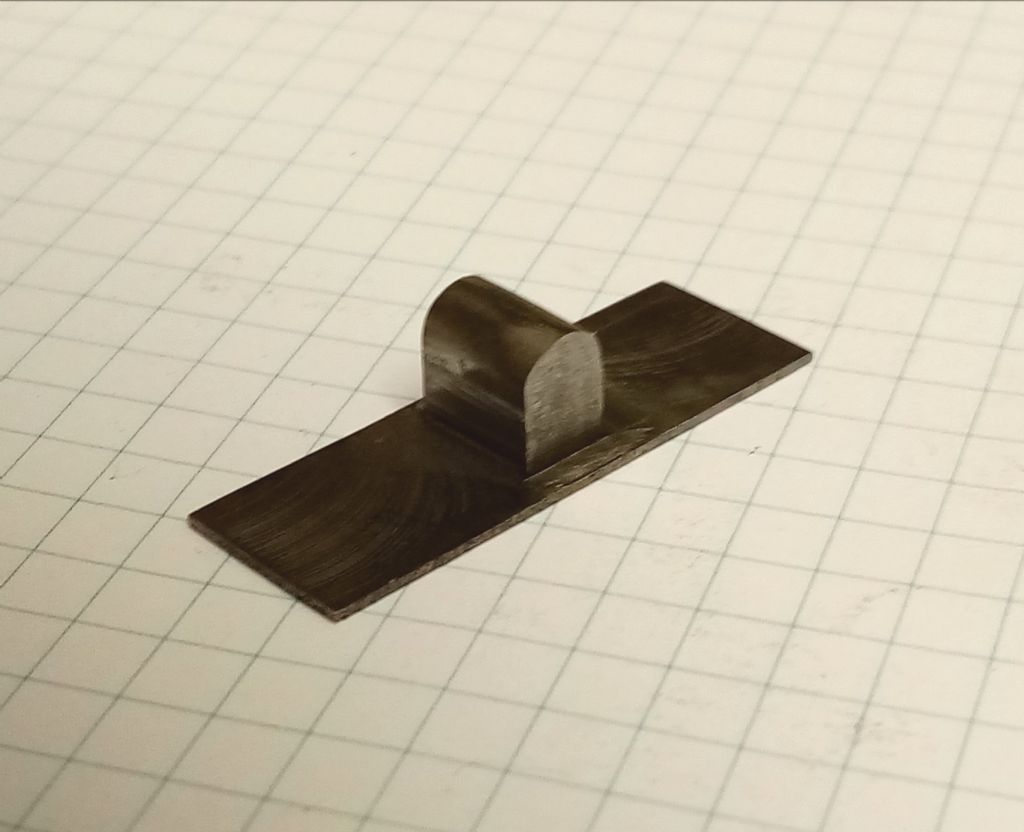

                          I never use mine for side milling, if its possible to turn the part so I can use the face of the endmill depending on size and shape of the part then thats what I do otherwise its 3 or 4 flute cutters as Jason suggests and side milling..
                          Its surprising what you can do with it though here is the shutter for the CHUKY engine, one piece 38mm x 12mm x 13mm of EN8 steel and all done with the 25mm endmill apart from the rad on the top of the block which I filed to shape.
                          A fairly small part 36mm long, 12mm wide and the block 8mm high, the shutter blade is 0.8mm thick and it turned out very flat, just needs polishing up which I will do by hand.
