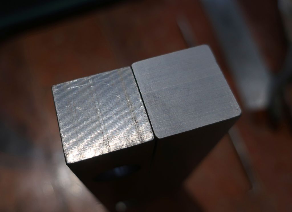

                                  So I've been playing with the ARC shell mill today for the first time – squaring up some key steel (EN8 I think) for a rear toolpost project. It went through it like butter, producing a shower of blue chips in the process. Very satisfying:
                                  But still…milling the ends (with the bar mounted horizontally) still produced vibrations, and a "something not right" noise, just like I've had with every tool and pretty much every material except aluminium right from day one. This is with climb or conventional milling, pretty much irrespective of depth of cut. Also over several gib adjustments, and recently confirmed to happen with no shims under the column (ie full contact) earlier in this thread.
                                  So I ended up putting the bar vertically and it was fine (it's a short bar).
                                  I guess my machine just doesn't do side milling and that's it…sounds stupid, but I'm at a loss as to where to go with it? The only thing I've not cheked/adjusted in spindle bearings, but there's no play in them, and runout is negligible.

                                    Did you ever get round to checking the spindle bearing backlash?

                                    Tony Pratt 1
                                      @tonypratt1
                                      Suggest it's the spindle bearings.
                                      Tony

                                      Dr_GMJN
                                        @dr_gmjn
                                        Posted by JasonB on 02/03/2021 07:05:39:
                                        You mean axial play effectively, or radial as well?
                                        I've put a bar in a chuck in pulled it backwards and forwards and cant feel anything. Not put a clock on it though, apart from checking runout which was OK.

                                          DiogenesII
                                            @diogenesii
                                            There was no play in these bearings that could be felt by hand – before & after adjustment, using same cutter & set-up..
                                            It'd be perfectly normal to have to adjust the spindle bearings after a period of running as the cycles of heating / cooling, vibration and pressure settles the components into place against each other, and the initial cold setting made at the factory is lost..
                                            Maybe someone (with knowledge of the SX?) could explain the 'how to'? ..I'm gonna be really late for worksurprise

                                            Dr_GMJN
                                              @dr_gmjn
                                              I can detect no axial or radial play in the spindle at all, so the side milling problem remains a mystery.

                                              Howard Lewis
                                                @howardlewis46836
                                                Looks like an impression of the helix on the flute of the end mill.
                                                One assumes that everything is rigid, cutter tightly clamped, cutter holder firmly clamped into quill, minimal backlash in fedscrew, (nip up the clamp ) work holding rigid?
                                                A lower feed rate, and shallower cut, might help?
                                                Having said that, sometimes a heavier cut stabilises the cutter
                                                Howard
                                                #531667
                                                  A pattern like that means a resonance is being set up between the cutter and work.
                                                  The movement may be undetectable, but the resonance means more movement than usual.
                                                  A small speed change should prevent it, if it is aesthetically undesirable.
