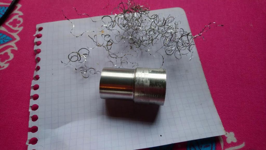

      Not long ago (26/8/20) I asked for some advice on obtaining a high quality finish on some Austin Seven track rod pins I was machining. The consensus was that I should be making the last pass(es) with a 'shear tool'. In my ignorance I had never encountered a 'shear tool' and I don't think you can buy them.
      Anyhow, I sent for a blank and watched Tubal Cain (American not old British) on the internet who happens to deal with making one. I thus ground up something that approximated to Tubal's although not nearly as neat. Tried it on a piece of scrap aluminium and worked like a dream on the finish and even produced swarf like maiden's hair! Picture attached (hopefully)
      Thought you'd like to know and receive renewed thanks.

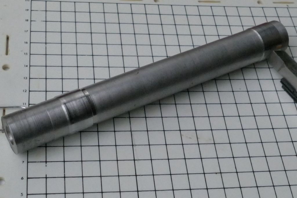

          I made one some years ago for the sole purpose of making a steel between centres test bar (dumbbell type with two raised bands) for setting the tailstock on centre as I didn't have access to suitable grinding equipment. The finish on the bands still looks polished. I haven't used the tool again.

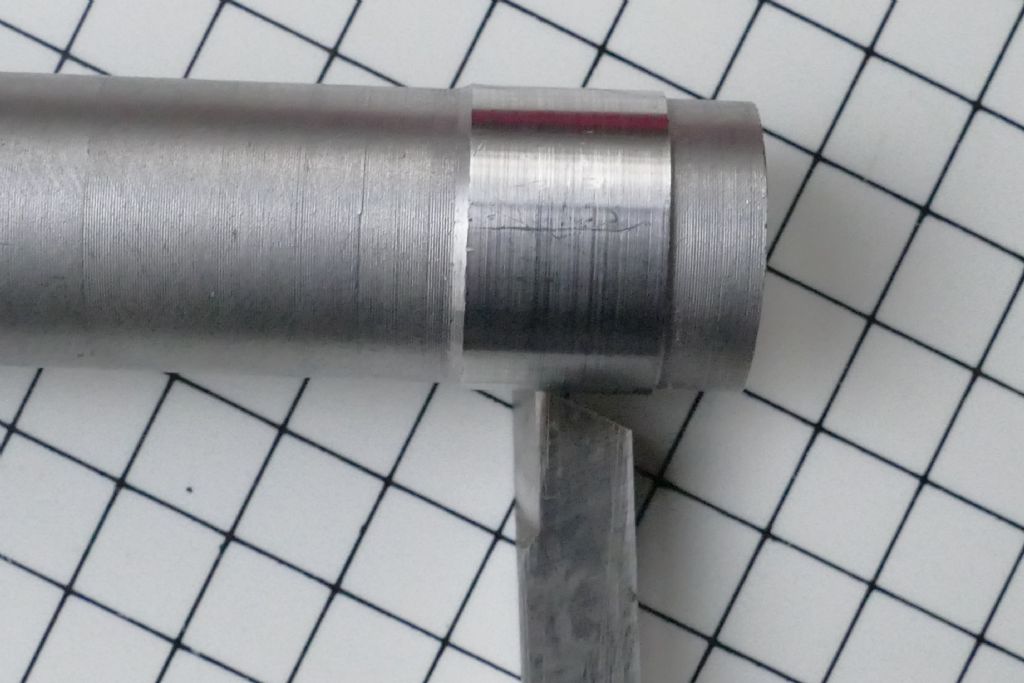

                  Here is the setting tool I made some time back and the shear bit I made to make it. In use somewhere along the cutting edge is used, not a corner. The top picture shows how the tool is presented to the workpiece, very slow power feed is used.

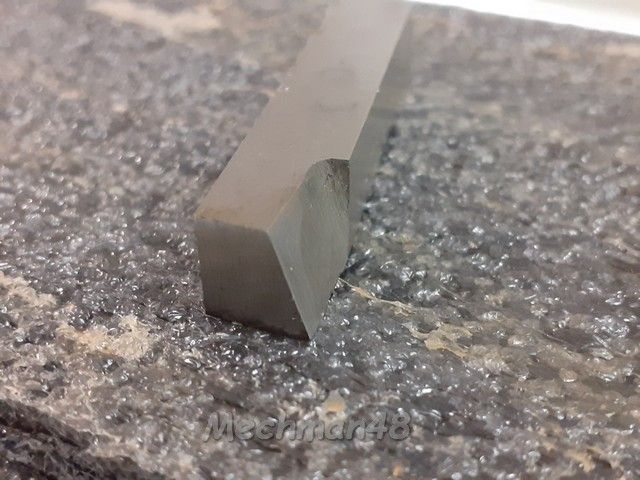

                              I made one last year based on the above; works nice giving a fine finish in trials. I'll take a pic of mine later & post.

                                Re. my previous post …My shear tool…
                                Only used on trial DoC .001-2" haven't got pic of 'angel hair' cuttings, will arrange something later although there are plenty on YouTube.No need for centre height setting as cutting edge tangential to work & can be adjusted up/down to suit as edge wears.
