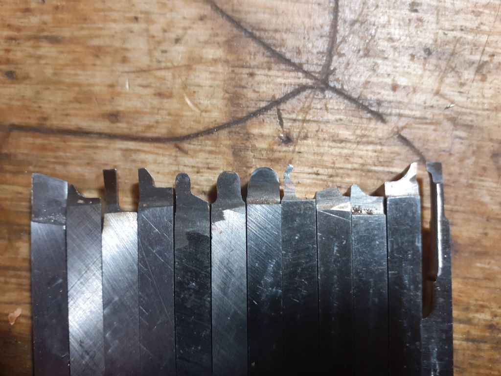

      There is plenty of advice on grinding lathe tools but what about resharpening them.
      Do you grind the front face, the side face or the top face?
      Then where ever you grind you are going to make the cutting area smaller. At what point do you decide enough is enough and start over again?
      I'd be interested in hearing what others do.
      Peter

                              #581535
                              Mick B1
                                @mickb1
                                Posted by SillyOldDuffer on 21/01/2022 11:53:17:
                                Can we do a show and tell? What HSS forms do you grind? Please provide pictures.
                                I think I have too many to show the full selection, plus I don't always remember what they were ground for, except that sometimes it's easier to grind a new one than ferret through the whole bunch to find something usable for the particular feature being machined. They're all 1/4" square section, which I fiind the best balance of size and grinding effort needed for my Warco WM250V, and for the Myford Speed 10 and Emco Unimat 3 I had before that.
                                There's usually another form ground on the other end of those in the pic, but these are my most-used variants:-
                                L-R:
                                Plain knife RH. There an LH one on t'other end. I try to keep 2xRH and 1xLH operational.
                                60 deg small screwcutting. Likely to have to work close to the chuck, so it's on that side of the piece.
                                Small parting and face-recessing. Tight radius clearance on chuck side. Might work for trepanning too, but it'd have a light radius on the front face if I'd ever used it for that.
                                Thread undercut tool for shouldered screw forms. Dunno if it's 55 or 60 deg or thereabouts, but can't imagine me making anything where it'd matter.
                                Small, medium and larger radius groove tools.
                                Hooky shoulder or thread undercut tool where room is very limited. Used it maybe a dozen times and it's somehow survived.
                                3 outside radius tools – middle one where central stem has to be kept, like on the little bronze peg-dolly drivers I put in the small toy cars I sometimes make.
                                Tiny bore finishing tool.
                                Of course, some can be used ad-hoc for other purposes – for example, the bigger radius grooving tool works nicely for facing too on most materials.
                                I try to keep one or 2 1/4"x 3" HSS blanks available in case of a sudden need for some form I haven't already got, or got something usable as a starting point.
