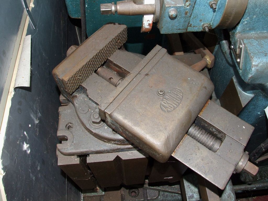

                        Seems nobody told Boxford about the need for a "special" shaper vice :
                        Original swivelling vice on an 8" Boxford shaper – not had anything come loose while using it. Maybe the machine is not capable of stressing the "conventional" vice used ?
                        Nigel B.

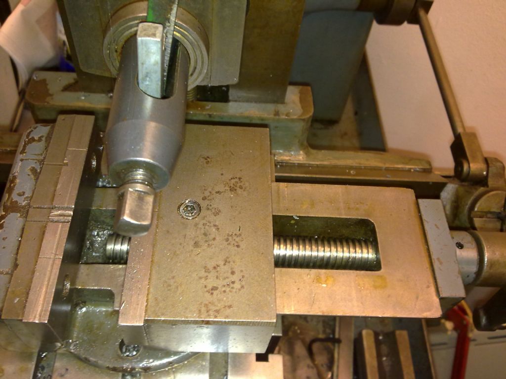

                            I just took a look at my shapers to see what is what. The 18 inch Alba has the arrangement that puts the screw under tension. The 10 inch Alba does not, the screw will be under compression. Those are both original vices. The Ammco shaper does not have an original vice, but I have the drawings and that would put the screw under compression.
                            I think the main feature of a shaper vice is that they are usually low profile.
                            I don't think that the cutting forces on a shaper are any higher than with anything else, the only point you should watch is when the cutting force is along the vice jaws, when it may move the job. A piece of paper between the jaws and the job is enough to prevent this.
