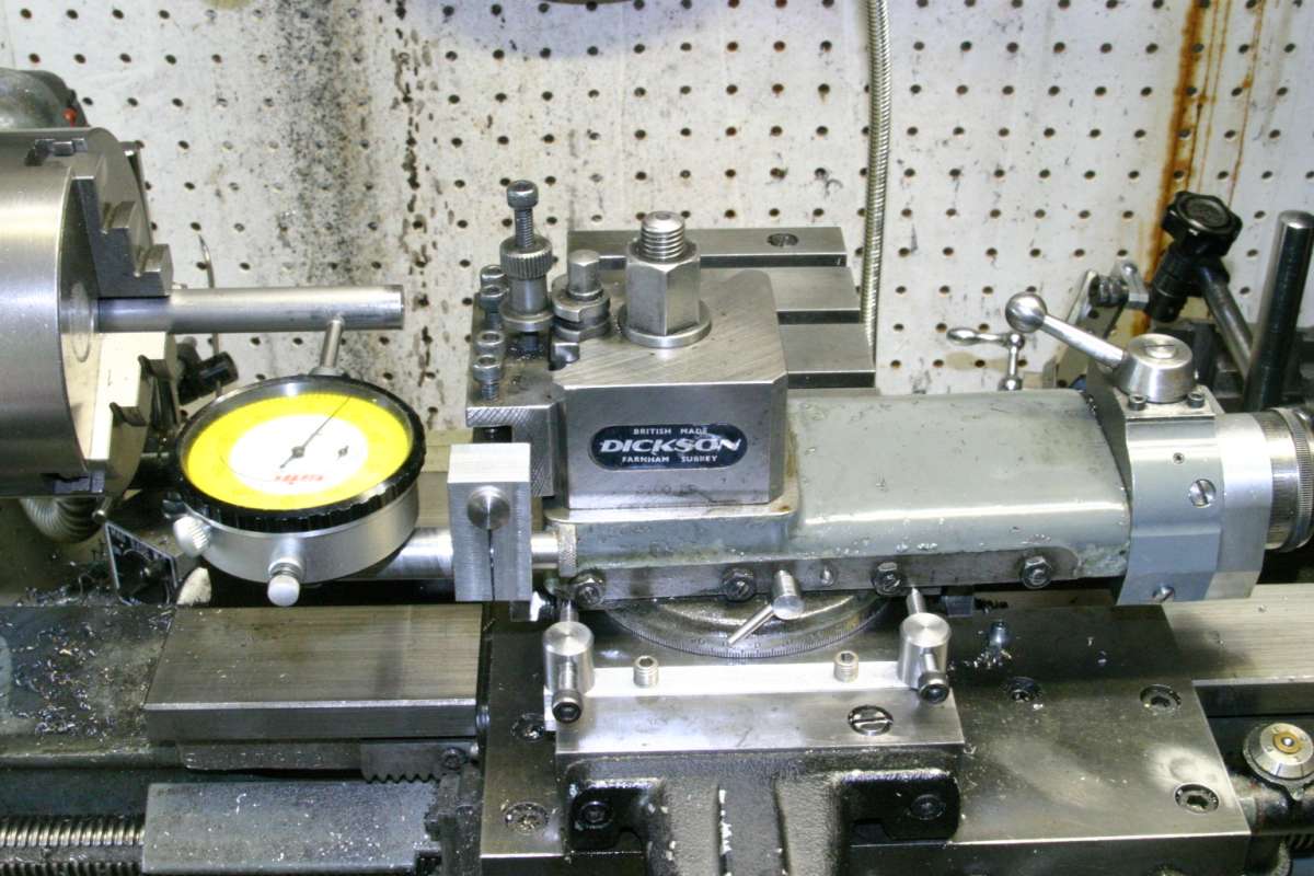

      Having the need to turn a couple of #2 Morse tapers, and having done a few in the past and remembering the tedious hit and miss system of setting the top slide angle by tapping it one way then the other,
      I decided it was time to find a better way. I remember George Thomas had a design for an attachment to do this in the Taper Turning section of his book “The Model Engineers Workshop Manual”
      Based on his general idea I have made my own version, full acknowledgment to George Thomas for the idea.

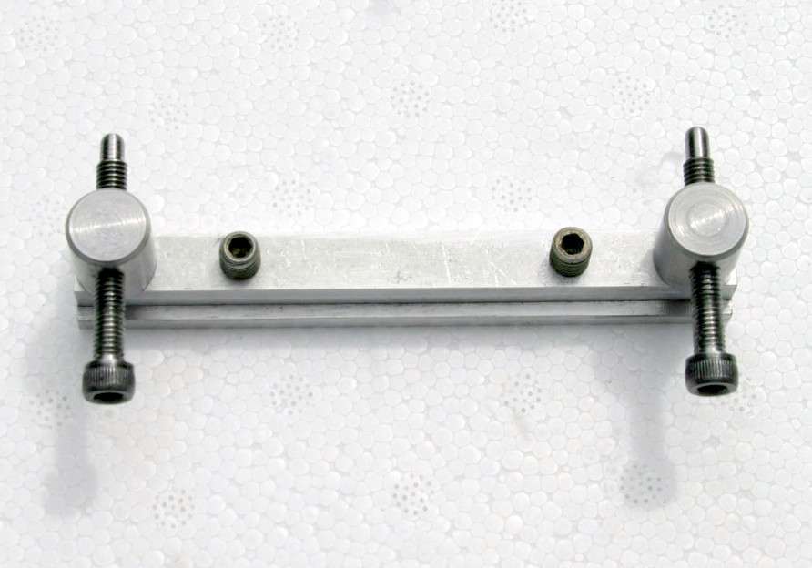

      The “tee bar” was milled from a 4″ length of aluminum to a snug fit it the cross slide tee slot, the height being  just proud of the top of the cross slide by about .025″.
      The two 1/2″ dia. posts for the adjustment screws have a 3/8″ length of 1/4-28 thread on one end, and are screwed tightly into the tee bar before drilling and tapping 10-32 for the two screws.
      The two adjusting screws are 10-32 hex socket screws with the ends turned down to the thread root dia. and the ends rounded to give a consistent contact with the top slide base as they are rotated.
      In use the unit is slid into the tee slot and the two 1\4-28 set screws just nipped up sufficiently to stop the bar from moving.
      It only took about 3 hours to make and I haven’t turned the tapers yet, but have tried setting up the top slide to the correct angle, and it is definitely a much more controlled way of setting the angle accurately.

                I have just cut a couple, using an existing tool with a morse taper held in the chuck with the taper out as a guide for setting the angle.
                Then used a DTI to check the angle as I advanced the compound slide for no movement of the needle.
                Did not blue them to check exact fit but they locked in with slight pressure and had to be tapped to release.

                        For greater precision in setting, the thread needs to be as fine a pitch as possible.
                        The ME 40 tpi threads are very useful in this respect as one turn moves 0.025″ With 40 divisions on a knob or handwheel, one division equates to 0.001″
                        For non Imperial lists, the method has be using, say, a 0.5 mm pitch thread
                        Since Zeus charts do not list any Fine Metric threads below 8 x1, the nearest commonly available would a standard M3. This being so small this can only be for adjustment with minimal force.
                        Alternatively a standard M6 could be used with a graduated knob. 50 graduations would give 0.02 mm per division, and a M6 thread can exert quite a force, whilst providing fairly fine increment

                          Agreed, the finer the thread the better for finesse in adjusting. The finest threads I had that were long enough, short of making specials,  were 32 TPI, hence that is what I used.

                              Thats a good idea the screw adjustment. You can add a DTI holder too.  I often set up a  dti at 70mm from the centre line, and use it like a TAN bar instead of a SINE bar. So measure over a constant length on the test bar looking at the radial distance variations.  Sine bars are always fiddly on lathes I find.  I use this mainly for setting angles less than 3 deg.
                              With setting a Morse taper angle, I normally put up a MT sleeve, hold it between centres. The way around will determine the taper being turned is internal or external. #2 is the main one I make, sometimes #3 or #4.
                              I use a plunger DTI to follow the sleeve, and to get the DTI on centre, just place a piece of brass strip or a slim rule  between the DTI and sleeve, adjust till it is Vertical.  So I use the DTI following the part, and I also use the DTI at 70mm on the edge of the top slide to dial in tapers for the MT ones. If your tailstock is not well aligned, this is not as good as a parallel bar and looking for the difference over a length.
                              Now that I have seen your fine adjuster, which I like alot, will make one for my S7. Looks like it can stay in place for the majority of taper work that I do anyways.

                                        Or you can make one of your adjusting screws 1/4 40 (ME tap and die) and one rotation is twenty five thou. Scribe up a barrel and you have a built in micrometer. After that it is simple trig – in theory.
                                        That’s how the Hemingway kit does it.
                                        I still find that one has to set a taper up between centres and use a proper DTI to get it dead right.
