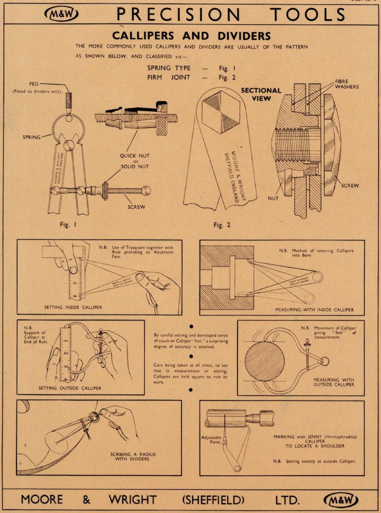

                              Posted by David Littlewood on 27/07/2012 12:43:28:
                              Wolfie,
                              I have never seen any odd-legs with a sprung joint; they have all been of the firm joint type. Like Peter, I find them a pain to adjust, it's very hit and miss, mostly miss.
                              Moor and wright do the spring type that you set like dividers see this link and scroll down to page 12 and see item MW56.
                              Fine for many quick jobs that dont need DRO, Mark and Drill when not a critical dimension

                                OK, not seen those before. Shame they don't have a step on the blunt leg, that makes them harder to keep at a constant attitude.

                                        Hi Wolfie, below is a couple of examples of how to set and use callipers.
                                        Strange how terminology seems to be different from place to place. I don't consider odd legs to be that accurate, however, they are categorised as precision tools by M&W. In Stev's link I've always known the type with the little right angle bit on the reference leg to be "Odd Leg Callipers", while the other type with the curved end as being "Jenny Calipers". But of course they can both be classed as Odd Leg or Jenny Calipers, but the one with the right angle bit are normally used on sheet metal as the other type are difficult to use on a thin edge.
                                        Regards Nick.
