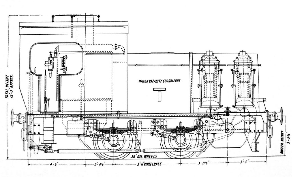

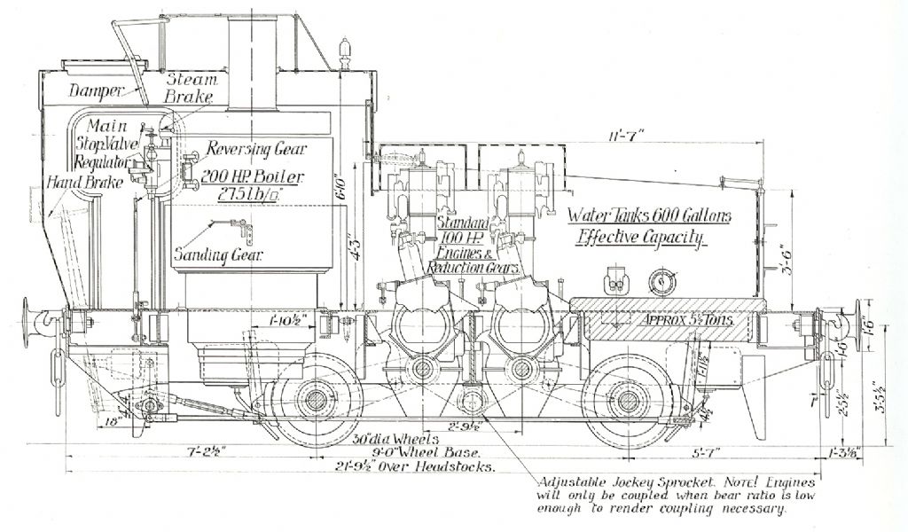

                  I too have the Constable articles scanned,it's one of those 'wouldn't it be nice' projects. I've seen a completed 5" version at Doncaster show. The wheelbase is very short. If anyone knows how well it runs I'd be very interested. In the meantime here's a couple of drawings I found on the interweb.
