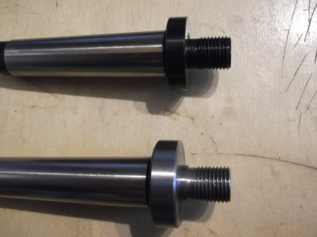

        I seem to have aquired a few 1/2" 20tpi threaded rohm drill chucks
        A few years ago i got a fairly nicely made mt2 arbor.
        When i decided to purchase another, the design had change & the runnout was awful.
        Finally got round to making myself another "better" one but it hasn't quite worked out right. What i want to know is where i've gone wrong.
        I know taper fit drill chucks seem to be the norm in engineering. I can't see why a screw fit should be inherrently less accurate. If you note from the 1st photo there appears to be a register on the chuck, (which should be used?) i measured this a smidge over 1/2"

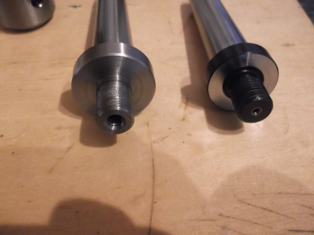

        The commercial arbor is the one with blackened parts & undercut on the shaft near the flange.
        I've found it decent enough but the runnout changes each time you screw the chuck on so a bit of messing about to get rewasonable runnout & not really viable for changing between chuck sizes like i was hoping.
        My homebrewed one is the shiny one. smiley
        Note i tried to incorporate a register where the shaft & flange meet, you can't really see from photo but flane & shaft were slightly undercut where they meet.
        Making one wasn't so difficult, worst bit was hogging out the excess material, lots of hot chips !
        Took great pains to setup & work as accurate as i can.
        Snook up on the shaft dia till the end of the shaft would just fit in register.
        Then shaved a little off the part to be threaded. Tappped center l/h thread for securing screw for good measure.
        1st time i cut imperial thread. At least i got the change wheel calcs right 55-40-40-65 on mini lathe gets you within a gnats whisker of 20 TPI.
        My thread ended up quite a snug fit, much better than the loose one on the commercial offering.

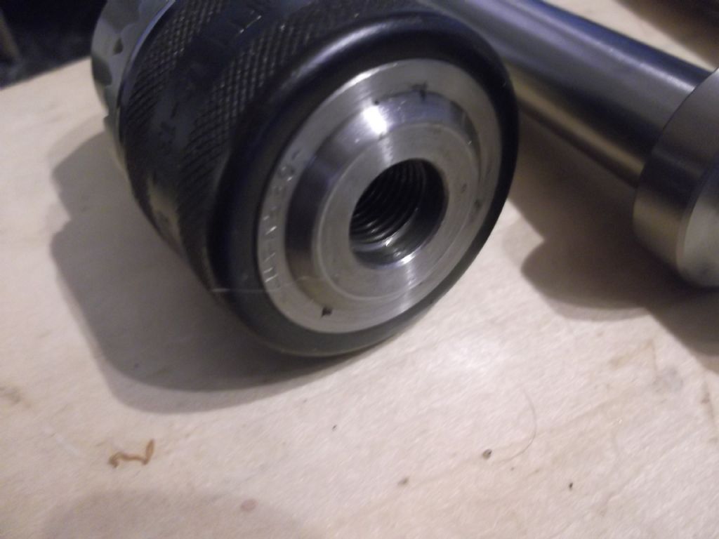

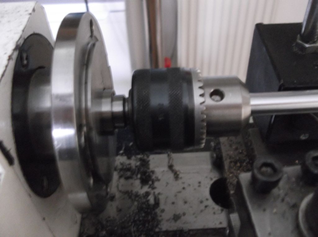

        All seemed reasonable(if not perfect) till the chuck screwed home onto the flange, then runnout was awful.
        Must confess , after much thought & messing about i ended up shaving a couple of thou out of the threads & off the register diameter. Everything was looser, but runnout still got messed up when the chuck mated onto the flange.
        Whatever the actual runnout of the drill chuck, i would have hoped i could at least make an arbor where the BODY of the chuck is no worse than a thou runnout!!
        So, anyone got any ideas where i went wrong? is my concept fundamentally flawed? should i remove that register entirely & see what happens?
        If you note on the commercial offering the flange is undercut, leaving an outer ring as the mating surface~ why? Is this the way to go.
        I just want to understand where I went wrong, I'll make another , if i can get a better grasp of what would be the correct way to make to minimise runnout.
        Any ideas?
        Thanks!
        & yes, i do realise drilling is not a precise opperation, but I'd rather it be closer to the ideal than miss by a royal mile. wink
        It was a good practice piece even if it didn't turn out as intended.

          Ok, if that was too lengthy, here's a summary.
          Is incorperating a register on the arbor a sound concept?
          Loose or tight threads best for this sort of thing?
          Why the wide undercut on the commercial offering?
          What have i done wrong? ~ viz the runnout goes heywire when the chuck is tightened onto flange.

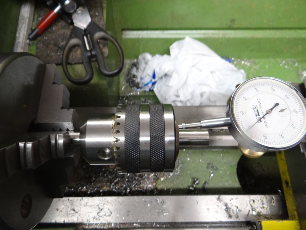

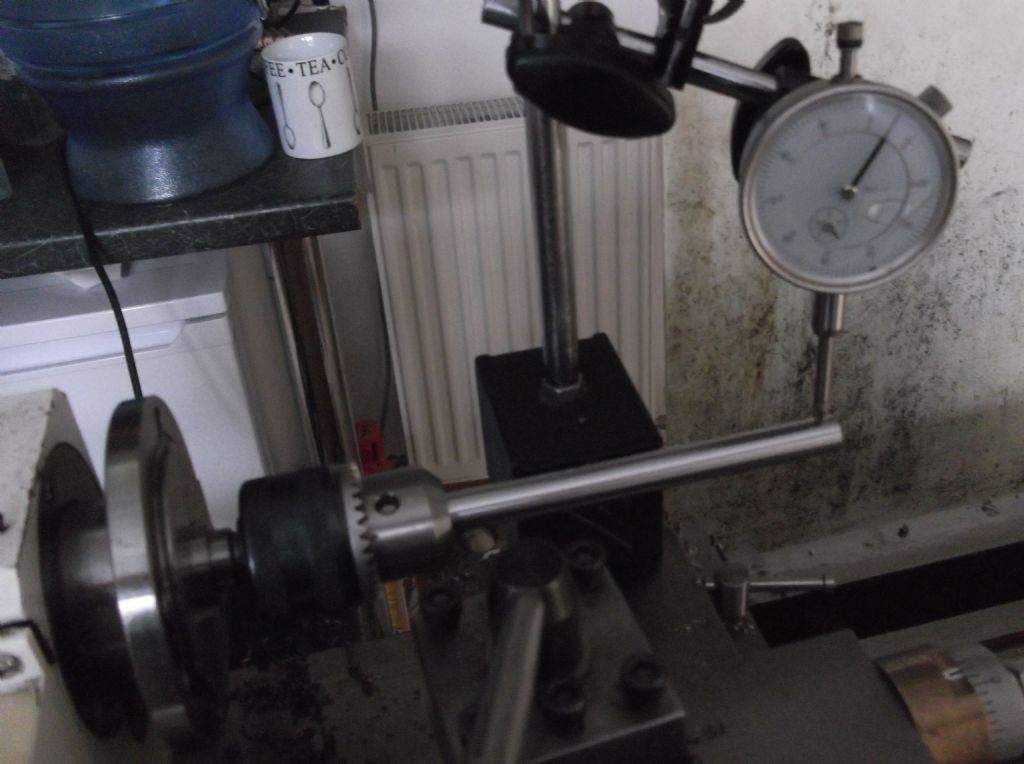

                Loads of ways of cocking up precision work, you can guess how I know.
                The mistake may be expecting too much of the chuck. Possibly the flat-end of the chuck body isn't turned precisely at 90° to the axis. In a hand-drill chuck, there's no reason why it should be, so the end may only be cosmetic. It not being flat and true would explain why the run-out gets worse when the chuck is screwed home on the arbour. In which case, Samuel's arbour is better made than these particular Rohm chucks!
                Try a set-up like this:
                To show the principle I bunged the test-bar into my lathe's 3-jaw, but if accuracy matters centre it in a 4-jaw or a collet chuck.
                The run-out of the test-bar is measured first. Ideally zero, if not take the discrepancy into account before condemning the drill-chuck.
                Then measure how flat the end of drill-chuck is as shown above. Mine is an inexpensive Chinese machine drill-chuck, not hand-type, and the error is 0.02mm. Most of the error is from the 3-jaw lathe chuck, so this one is OK.
                Had the set-up revealed the base to be off-true, the same arrangement allows the drill-chuck to be skimmed true on the lathe. Usual precautions about rigidity and light-cuts only.

                    This sort of chuck, developed for hand drills, uses both the back face and the 1/2” register that you noted.
                    The threads should not be too tight as they do not help with alignment, and indeed could cause problems if they are tight.
                    These chucks can sometimes be reasonably accurate, not as accurate as a proper machine chuck of course, but robustness is more important, and because the register has to have clearance to assemble, it will never be as good as a taper fitting.

                          After much faffing about i got a 3/8" mounted on my home brew arbor with TIR of 2 thou on body & typically 3 thou on a 10mm long series drill near the jaws & you had to look hard to notice the runout @ the tip.
                          Guess that's about as good as it will get, so i'm now loath to remove the chuck from the arbor.
                          The 1/2" chucks are rather less good.
                          @ SillyoldDuffer~ i tried what you sugested with one of the 'naff' 1/2" chucks~a barely perceptible flicker of the dial, run on the back face.

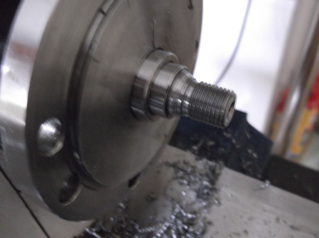

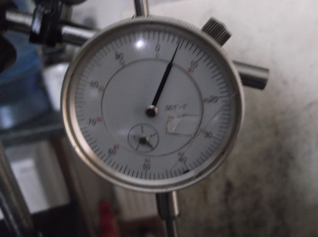

                                dscf2995.jpgdscf2994.jpgThat's a great idea Martin….when i'm good enough to cut a turn a morse taper for myself.
                                In the meantime I had another go with a 'blank' arbor….
                                thought it worth sharing~ just in case anyone else has some screw thread chucks they want to make good use of.
                                Inspired by all your comments i lost the flange put a chamfer on the end instead to locate on the countersink in the chuck body.(sort of like a taper fit)
                                Seems to work, least a lot better than my 1st effort. Getting typically 1 to 2 thou run out near chuck jaws & 4.5 thou at the end of a 'simulated' 1/2" jobber drill.
                                Screwing the chuck on & off seemed to give very repeatable results.
                                Truth of the matter will be when i move the arbor to the mill or tailstock.wink
                                Quite pleased as if nothing else it's ended up a very short arbor.

                                  My understanding of how both a screw mounted drill chuck and for that matter a threaded lathe spindle register should work is as follows. Axial truth (parallel-ness to axis) is controlled by contact of flat faces, both parts needing to have these exactly true running. The threads control the centring, with each requiring to be an accurate constant pitch spiral. When tightened, the threads seat all round on the angled faces, determining an exact concentric point (even if there is slack) in combination with the axial alignment of the face contact. Thus the combination of thread and face contact defines an exact repeatable mounting.
                                  There is therefore no point in a register as well. At best it will define the same concentricity as the threads, but any error will inevitable fight with the position defined by the threads. In the same way, a taper interface could have a concentricity error similar to a register. It also is likely to have lower stiffness than the face to face configuration, but if carefully executed it will, of course, work.
