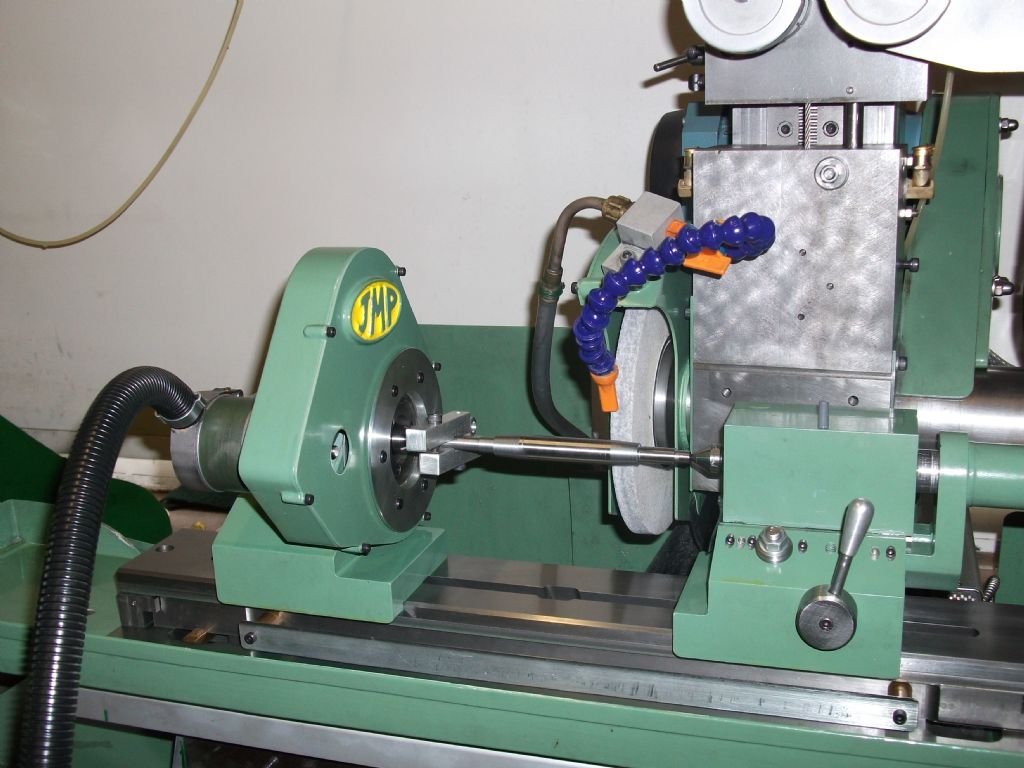

                                  Hi Martin
                                  First of all the speed that you indicated seems a little high,
                                  in this video
                                  the cam is rotating at between 30 to 40 rpm that alone
                                  would solve some of the points that you have raised.
                                  As part of a project that i have still on going i have looked in to
                                  grinding similar forms ,the photo here shows the machine set up here
                                  with the stepper motor drive controlling the rotation of the camshaft axis
                                  ( the shaft fitted here is for something else not a cam)
                                  at 1800 steps per rev, the crosslide moves 0.00005 inch per step.
                                  I wrote a small file to simulate a camshaft but found like you , the
                                  speed as the grinding wheel goes over the peak of the cam the
                                  speed can be too high ,as part of the sequence the rotation speed
                                  of the cam is incrementally reduced and increased as the grinding
                                  wheel rises up and falls over the cam lobe ,i never got to the point
                                  of cutting metal but some of the things that are gained just by these
                                  simulations are of value.
                                  The other thing to think about is at some point during the grinding if you
                                  are using the encoder and crosslide to follow the cam shape
                                  the crosslide will need to move independently to increase the cut depth,
                                  unlike using these systems for threading the grinding is more of a
                                  continuous sequence.
                                  The rocking action of the cam being ground in the video almost
                                  seems like the easiest solution and use the cnc part to make the
                                  master cam.
