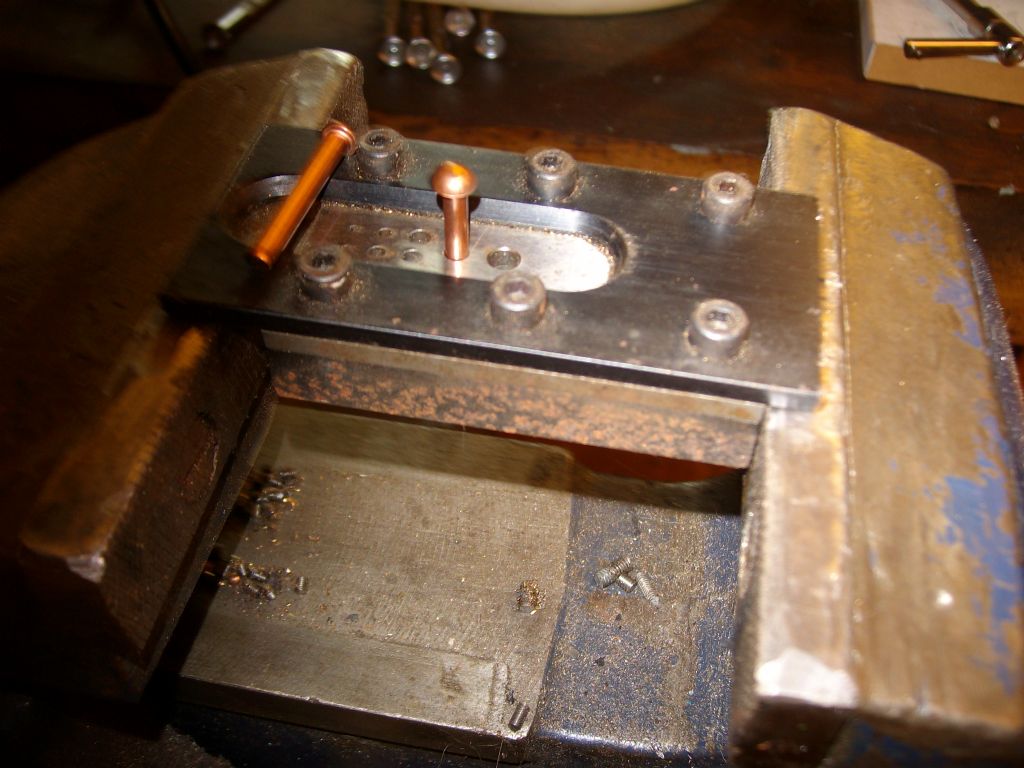

          Above is a lovely little rivet shortener from Arrand bought it in 06 and has done sterling work since MGJ do not understand why you would want to use a chisel or bottle jack
          this device is aimed at ME’s who wish to shorten quantites of rivets, bolts ,bar efficiantly
          quickly and accurately.

            Handy little tool, should not be too hard to make something up from Gauge plate.
            mgj’s bottle jack was for forming the rivits not cutting them, though I think he should consider getting one of the following instead, not the novel use of the inspection pit

                            I bought the Arrand because at the time I had over 300 rivets to chop down.for a particular loco.
                             I should imagine if it is only a few the good old saw wins.
