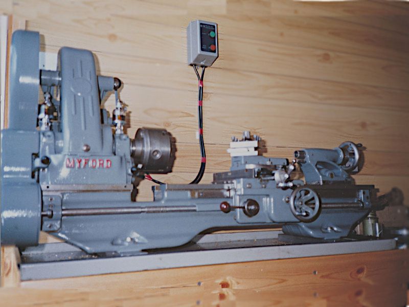

                        Journeyman
                          @journeyman
                          You certainly don't need to buy the Myford riser blocks but getting the lathe up in the air a bit is quite useful to aid cleaning and preventing knuckles hitting the drip/swarf tray. This is a picture of my now long gone ML7.
                          The tray under it is an old steel shelf from an office cupboard. The riser blocks are a couple of bits of 2" x 1" BMS bar. The blocks serve to prevent the wooden bench moving too much with a similar chunk under the bench to sandwich the top clamped together with a couple of 0.5" studs, top block threaded for stud and lower one drilled clearance. The top was drilled and tapped at the mounting holes centre for a bolt. Lathe was 'levelled' by using shims under the feet as needed. Worked well for many years.

                          Howard Lewis
                            @howardlewis46836
                            Something along the lines of Tubal Cain's method (Does not have to be absolutely identical ) will do the job.
                            In the past I have used studding and nuts to provide a means of adjusting to level and remove twist.
                            My present lathe, larger than the ML7, sits on 1/2 UNF setscrews and nuts.
                            The idea of using the door from a steel cupboard is a good one. It saves a lot of sheet metal cutting and bending.
                            (That is what sits under my Mill/Drill )
                            Howard
