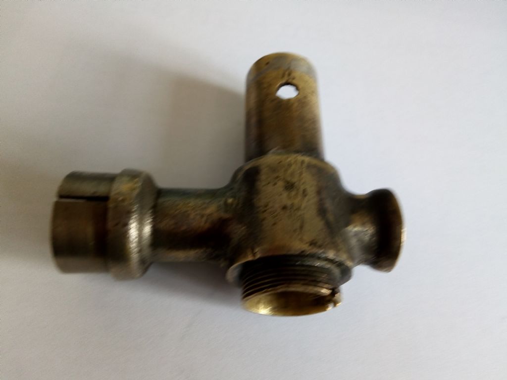

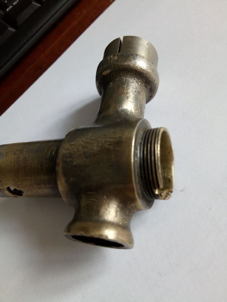

        Roger Hulett
          @rogerhulett83124
          Abject apologies,I was cutting gears on my horizontal mill (with dividing head) and threads on my lathe (without dividing head) when I wrote my original post I didn't know my one from the other.
          The orevious photos show the carburettor as is. I have checked all of the obvious catalogues and web pages but cannot find this carb. It is described in the brochue as an "automatic carburettor" !!! There are no markings anywhere,float chamber,carb body .jet, etc etc. The thread as seen in the photo is 1/4" long and has an exterior diameter of 7/8".
          #369785
          Hopper
            @hopper
            If your thread gauges won't measure that thread, you might want to try metric gauges, or using a tap as a gauge to find one that matches. If all else fails, measure number of teeth in 1/4" with a vernier and magnifying glass and multiply by four to get TPI. Set your lathe gearbox or changegears to that TPI and cut a sample thread and compare. Once you get pitch right, its a basic internal screwcutting job. Size of the hole up the middle is the OD of the male thread, minus the thread depth X2, plus 5 thou for clearance.

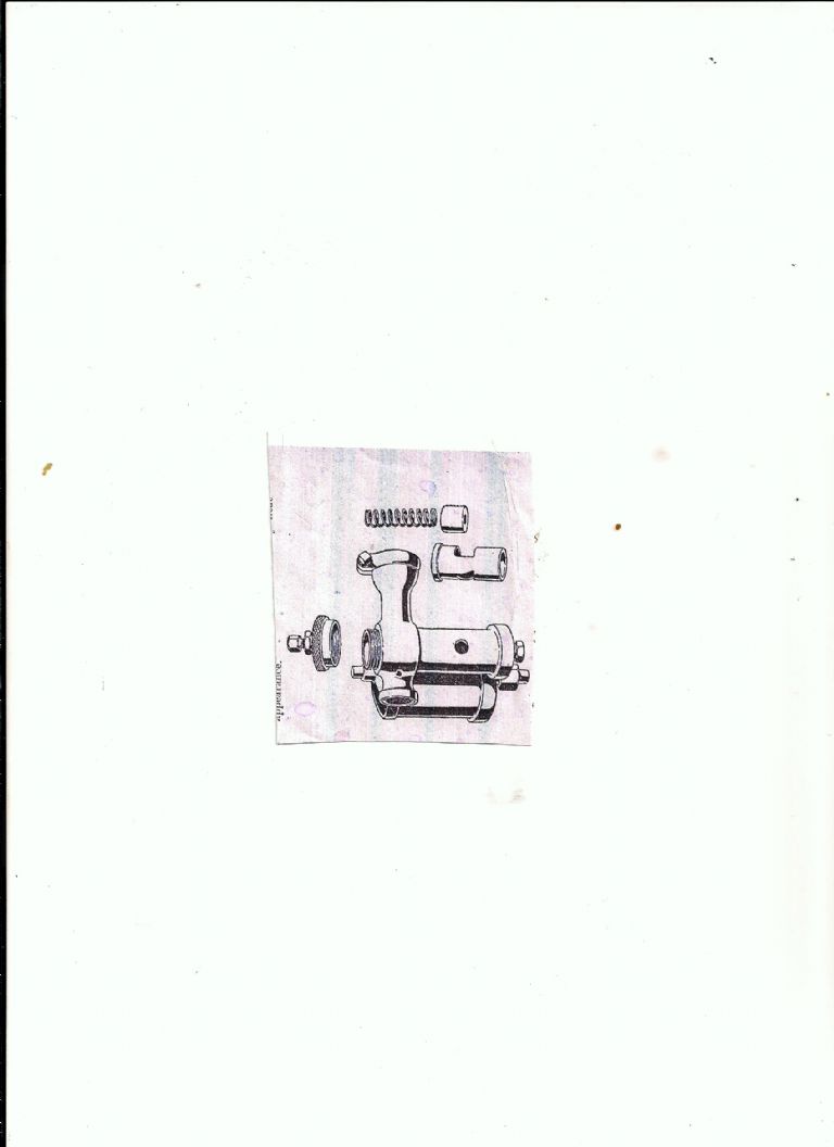

            #369802
            Roger Hulett
              @rogerhulett83124
              Herewith an original drawing of the "Automatic Carburettor " taken from a 1920s edition of The Motor Cycle.
              I have also found an old Whitworth thread gauge which indicates the size as 24 3/16 7/32
              Does this mean the thread size is 3/16 Whit ?
