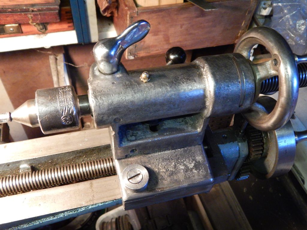

                                        Conversion of another tailstock is possible. The hardest thing is to find something that will fit your bed as the width are all different. The second challenge is the vertical height to center of lathe. I Converted my lathe recently it will give you a clue whats involved here **LINK**
                                        finished

                                          Nice work Martin, I had considered the ML10 tailstock, it looks more suitable than the ML7 and Super7 versions which have holes in the wrong place for my purpose. Unless you are lucky though, they are fairly expensive second hand so it's worthwhile to explore other options. If it make the thing from scratch, I can add features like lever or capstan operation of the barrel. Two forum members suggested castings, possibly using the lost foam process. I have PMd them for further information.
