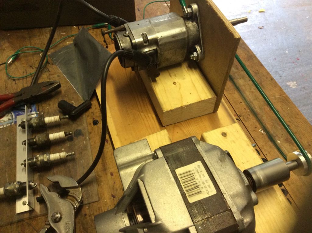

Hi,I’ve restored a Lucas K2F magneto ,changing internal capacitor etc ,wasn’t too difficult .
I made a simple test rig as it was hard to test it on the bike
l read somewhere that the spark needs to cross a 5mm gap in open air,which mine did.
Hope this helps
Maurice
PS If you need to take the armature out ,try to find out if it will affect the magnetism in the stator, best to try to do work with armature left in place .
