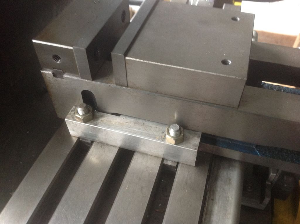

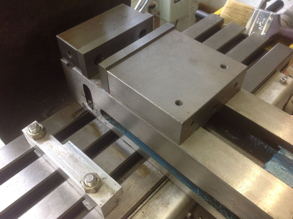

                                            Absent shots of the underside on the web, I am wondering: How does the vice attach to the milling table?
                                            Cheers

                                              You need to clamp it to the table with tee bolts and a couple of slotted clamps. The larger ones don't seem to come with them but you need a clamp set anyway, which are on offer from MSC (but check your slot width)….

                                                The vice is held onto the table using clamps in the slots machined into the sides. I'll try to get some photos up tomorrow morning, if that would help. I made mine from aluminium bar stock for ease of machining.

                                                    Up withe lark and I've taken a couple of pictures of the vice clamps for you. You will see that they are a simple machining exercise. I had to machine a cut-out in order to mount the vice where it sits on the mill table, such that the bulk of any workpiece is over the table itself and not overhanging. In that respect, the vice is probably still too big but by going any shorter, the width is commensurately reduced. This is a reasonable compromise with which I am perfectly happy.  Note, also, that the tapped holes on the top of the moving jaw and the rear vertical faces of both jaws are to accommodate the repositioning of the the jaw faces, giving the vice the true versatility which its name implies.
                                                    mill vice clamping
