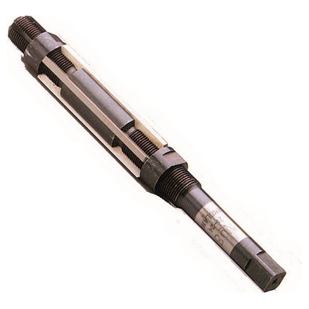

                      As for adjustable reamers, they are for bodging holes IMHO and have no place in my workshop, apart from a couple of genuine David Brown ones that I inherited but have never used.

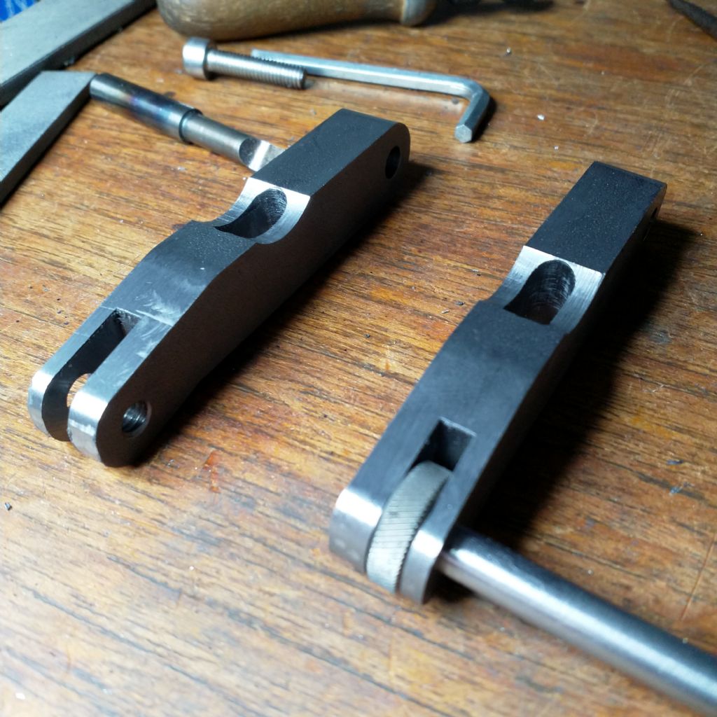

                                  I needed a 1/4" reamer recently and discovered how much these things can cost when shopping about for one. Instead of buying I just made a D-bit from some silver steel. I turned it to the correct diameter then milled it to half thickness for maybe a 1/4". After hardening and tempering it performed admirably and was a fraction of the cost of buying a reamer as I had the silver steel and all the tools needed to make it.
                                  It's certainly worth having a go at making one and I'll just make more as and when I need them. I've made a 5mm and a 1/4" so far with success. You can just see it in the picture, to the left of the left most arm but it's not a particularly great picture.

                                      It seems adjustable reamers are getting a bit of an unjustified kicking in this thread, so to try and redress the balance, in my experience David Brown adjustable reamers were the reamers of choice at Timson's where I did my time, but as I recall just used in the lathes for reaming holes for ball bearings in gear blanks and the like. We had a tolerance of half a thou. We would drill, then bore, then take out about 10 thou with the adjustable reamer to size. The advantages of the David Brown type included the ability to adjust the reamer when it started to wear a little, and eventually sharpen the reamer blades, and eventually replace them when there was not enough to re-sharpen. I would imagine that solid machine reamers would not last that long machining the EN24 blanks, and replacement expensive while the David Brown reamers would be expensive to buy initially, but over thousands of holes would prove the most economical choice.
                                      This is a different scenario to the modellers workshop I know, so I can understand why they are not used much there, but that does not make them a poor tool. I still use the few I have occasionally, useful for any odd sized hole that needs to be dealt with. If I did not already have them, I probably would not buy them.

                                      Phil P
                                        @philp
                                        I think of these horrible things when someone mentions adjustable reamers.
                                        Phil

                                                    larry phelan 1
                                                      @larryphelan1
                                                      Simon,
                                                      That looks like a knurling tool you are making.
                                                      Would love to have an idea of size since I need to make one sometime soon.smiley
